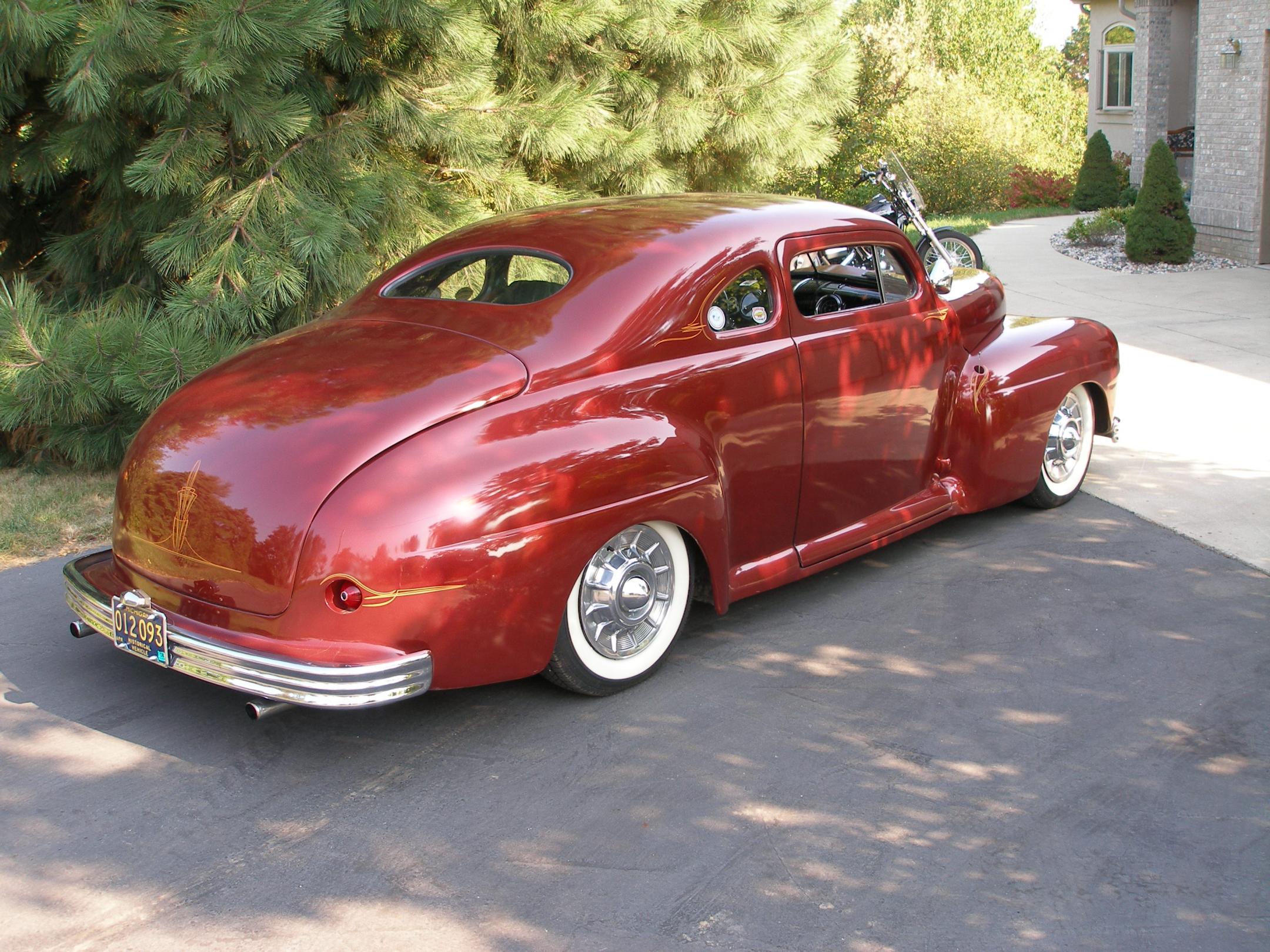

    Now I would like to chopping it , I don't want to make a radical chop , I like very much back in plunging fall as the back of that of Jesse Lopez
    My ideal would be as on the photo to borrow has Ruck

    Wow, that is one of the best chops I have ever seen on a long door coupe.
    Copy this one.

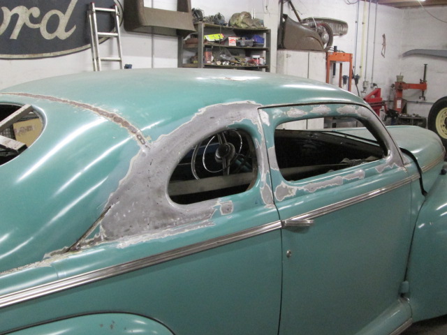

  14. the car you posted was done by a good friend of mine his name is paul garland.i can ask any specific questions you have.
  15. Mild photochop. Something like this?

    One of the things that makes Paul Garland's chop so nice is that he sectioned some thickness out of the roof just above the door tops, along where the drip rails used to be.

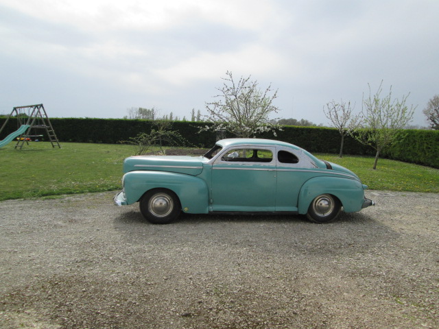

    If you are willing help me here is a photo of my 46 thank you and still forgiveness

    Boris, You have your 46 at home and you have some good inspiration pictures!
    like pist-n-broke, I think that the "good cut" will be decided in front of your coupe with the pictures in the left hand and the grinder in the right hand!
