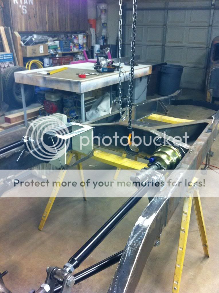

    So I decided to start a build tread for my 1936 Chevy low cab pick up. When i started I had pretty much everything excluding the drive train. This is my first build and has taught me a lot about hot rodding and what it takes to build something from the ground up. Almost everything on the build I made from scratch myself with the help of my dad.

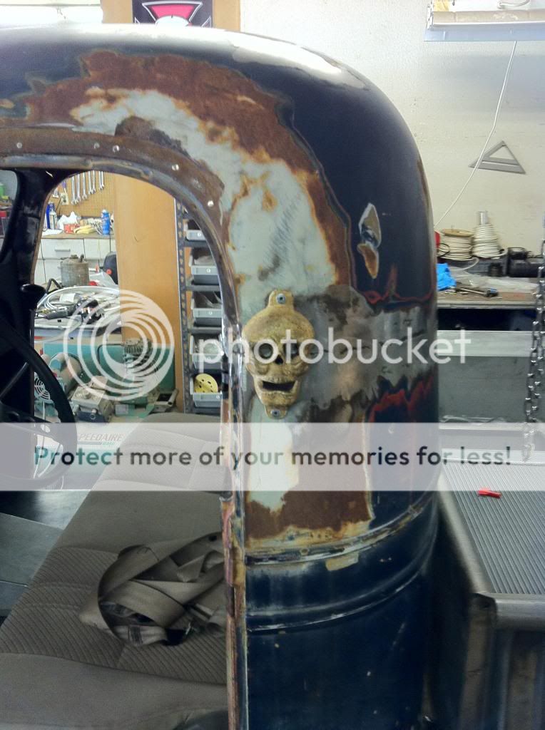

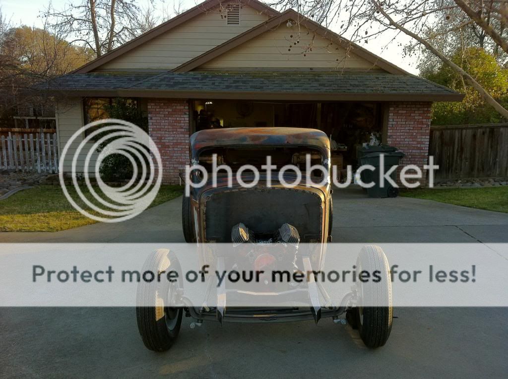

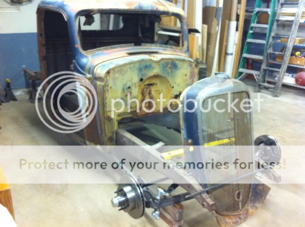

    picture set number 2 shows pre and post chop

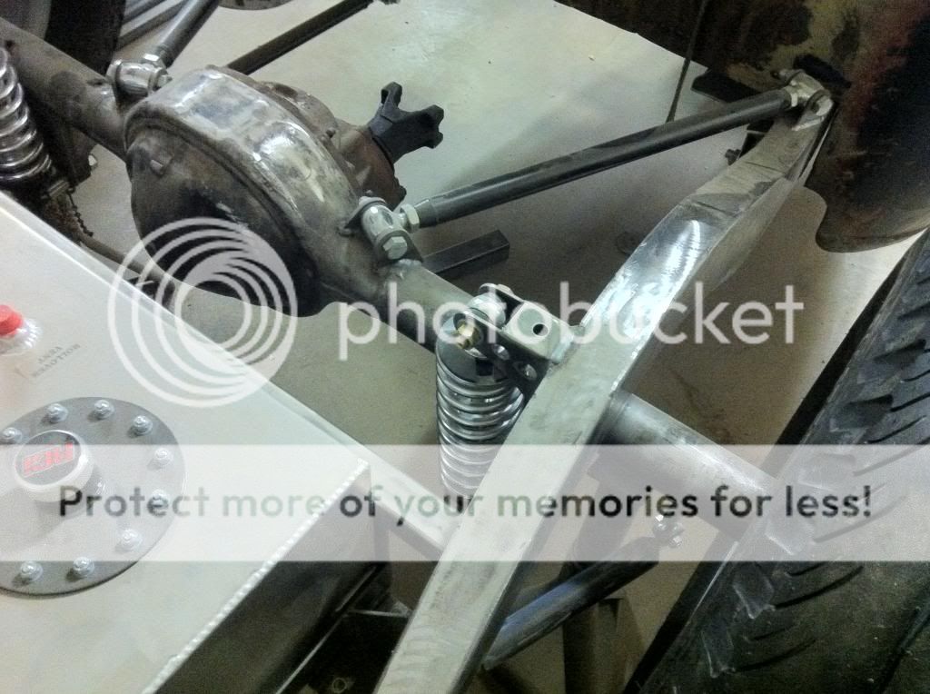

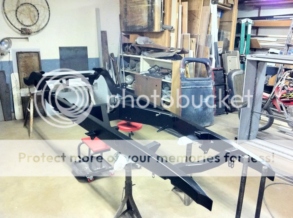

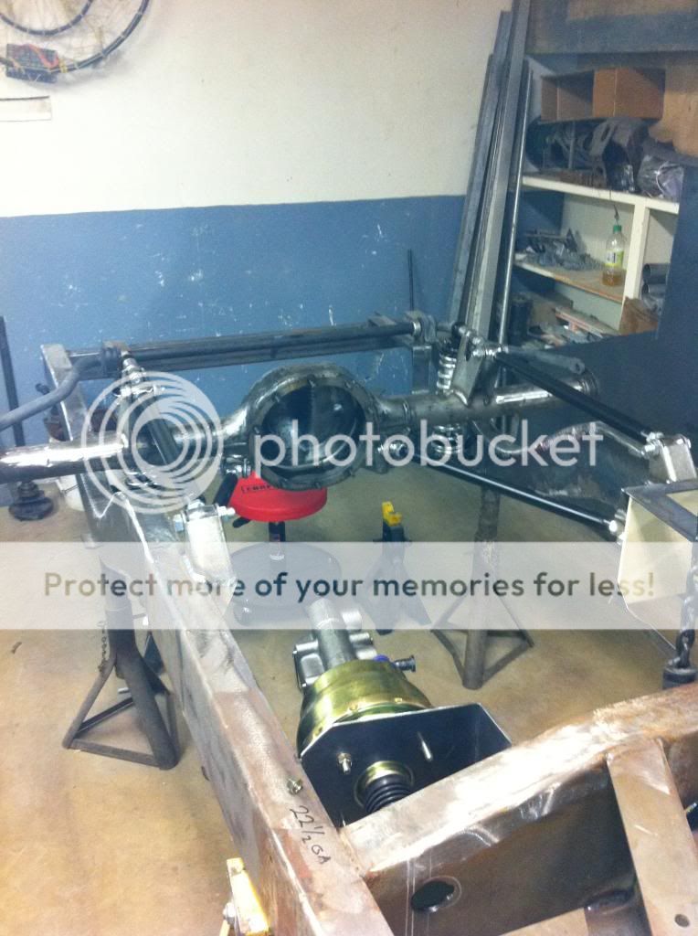

    Got the frame and suspension parts back from powder coating painting a few random small parts and placing the drivetrain in to the car. At this time that was a ford 9 inch with 373 gears, custom drive line, stock used 700r4 no lockup, 2600 stall, 327 10.5-1, loopy cam with 194 iron heads topped off with a cross ram with two holley 390s.

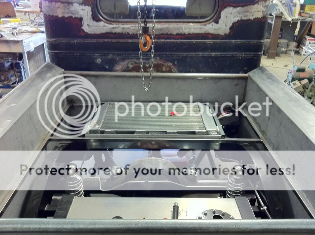

    this set shows the wiring, the original in the bed radiator, zoomie baffles, and a few other random shots

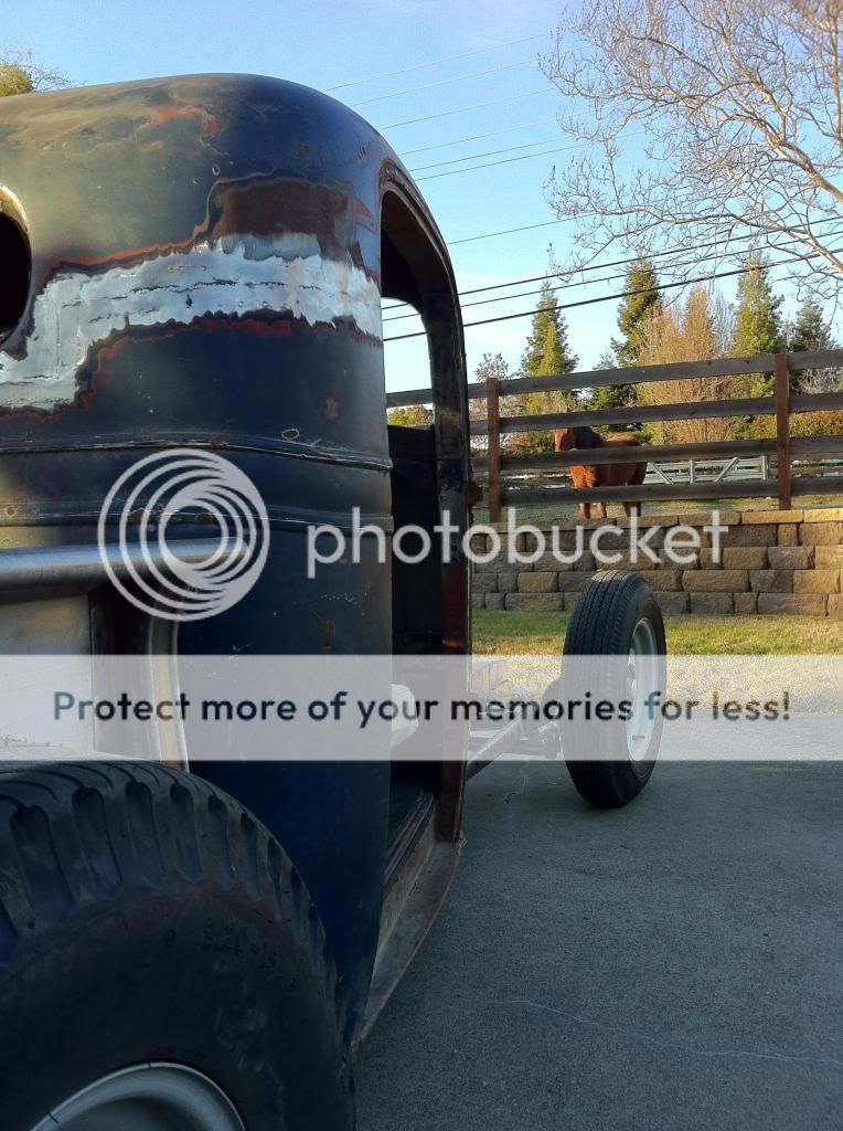

    this set shows the rat version that we took for the first season of shows, the first pic was our first show at midnight mass. The rest of the pics show the cab and interior parts going off to get blasted, the first coat of metal etch, also shows the new 383 roller with hi-performance 700r4 [​IMG]

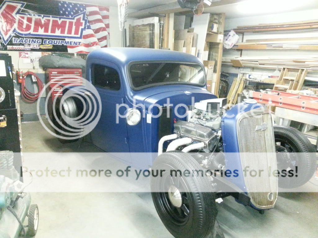

    time for the next set shows a couple layers of primer, high fill and some of the rust repaired.

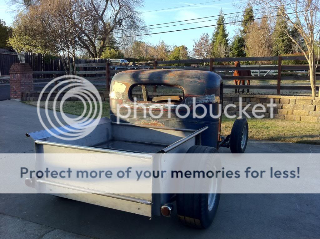

    Last show of the year trucks going under the knife new tires, new exhaust new head lights and fog light and a few electrical mods

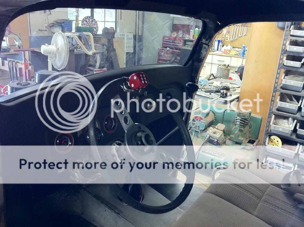

    Great looking ride!! What bench seat did you use? And can I ask is that black "wrinkle" paint on the dash? My dash was brown wrinkle paint but I had to modify it for new gauges; now need to refinish it to match the brown wrinkle finish in rest of interior. Thanks, Jerry

    The bench seat is out of a Mazda mpv minivan like 94-98 and its the third row. It folds forward and has a quick release really nice. As for the paint I went through every brand out there none of them would work for me except Eastwood wrinkle rattle cans they only come in a medium gloss black but they work real good if you apply the paint right.

    So this is for rideordie
    measurements are as follows
    49" long by 45" wide
    19-3/4" tall from the bottom to the bend
    from the bend to the pipe is 4-1/4"
    the pipe is 1-1/4" galvanized fence post that i washed off the galvanization
    the bend is 30 degrees (stock is 28)
    the bed is made of 4 pieces the two sides, a front that is close to the tailgate but only 1 piece of pipe and a role pan that is u shaped that raps around the back of the frame.
