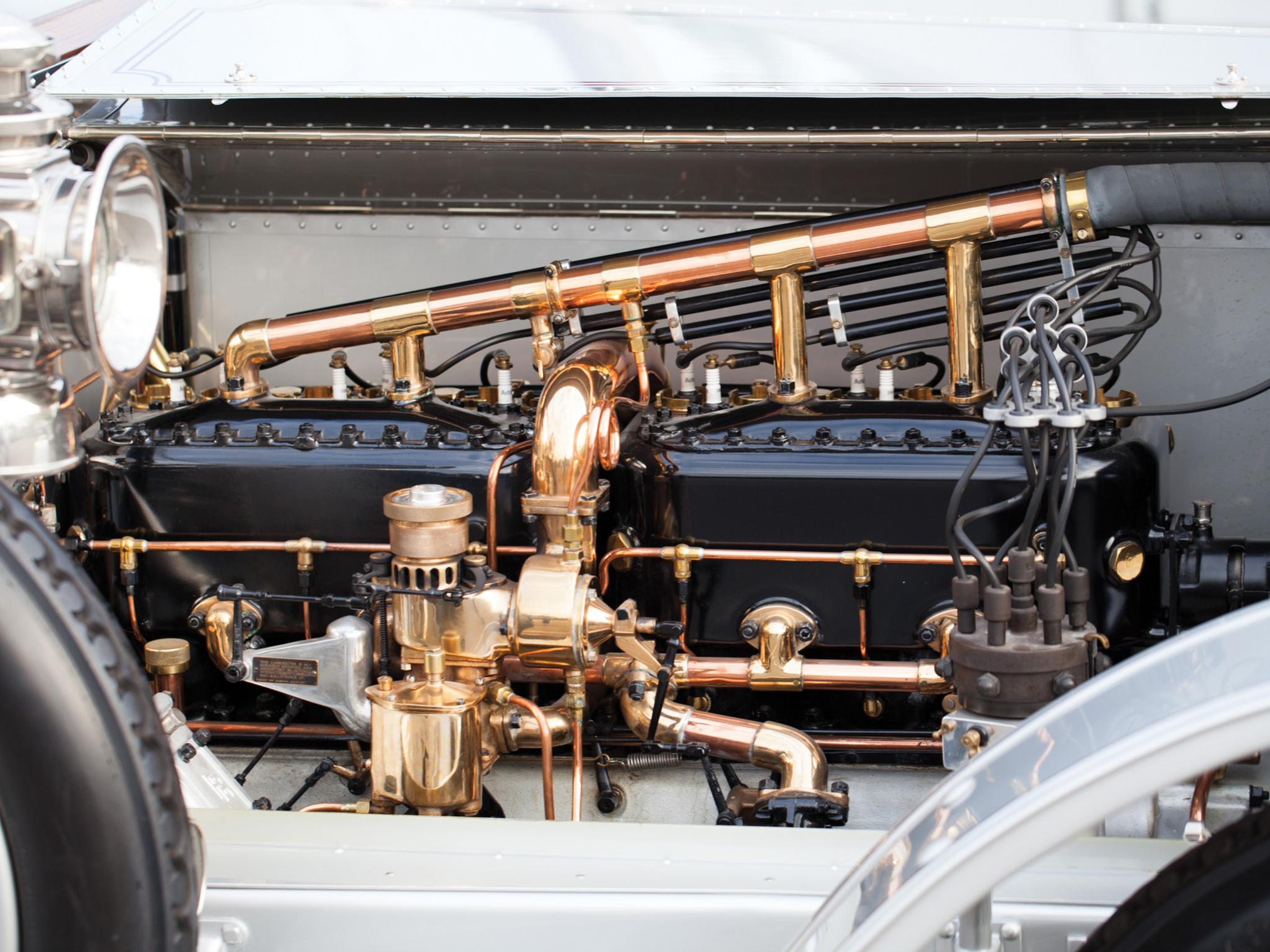

  13. slddnmatt
    Joined: Mar 30, 2006
    Posts: 3,685
    slddnmatt
    early Rolls Royce for a pic for ya

  24. slddnmatt
    Posts: 3,685
    slddnmatt
  25. Diavolo
    Joined: Apr 1, 2009
    Posts: 824
    Diavolo
    two points to consider before you take a beautiful Rolls Royce and decide it's ok to run home improvement grade copper lines.
    1. Short, straight runs.
    2. Soldered to Brass fittings and rigidly mounted all over the place. That Copper has absolutely no chance of wiggling.
    I have Cunifer and it's tinted a copper color-ish. Not copper.Just not silvery colored either.
  26. slddnmatt
    Posts: 3,685
    slddnmatt
    Compression fittings work fine for connections.. I've seen broken steel lines and broken copper. It's durability is on how it's all plumbed. That was just the first car that I knew that would have some non-ferrous bling on it..
