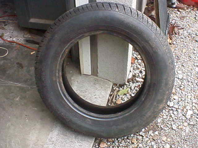

  1. I've been making my own whitewalls for years. I've done about five sets with good results. I have a set on a car I drove everyday for three years. They still look as good today as the day I did them. Just about every tire has a factory line close to the tread, I use this for my whitewall edge. I grind the sidewall smooth with a DA sander and 80 grit paper. You don't have to grind a lot off, just get rid of the detail in the sidewall. Clean your tire real good with a wax and grease remover so the tape will stick. New tires work best, but I've done used one with the same results, just make sure you clean them real good to remove any tire dressings like Armor All. Tape up the side wall were you want the outer edge of your whitewall. Cover the rest of the tire with newspaper, leaving the area to spray uncovered. You don't have to dismount your tires if they are on rims. I just let the air out, and break loose the bead. Tape up the rim if the tire is mounted. I use KRYLON Fusion for plastic in a spray can, #2320 Gloss White. One can should do four tires, but buy two just in case, you don't want to run out. Spray a light coat and let it set up, then spray until you have the desired coverage. Don't make it any thicker than you need to. Let it set up, then remove the tape. WOW Whitewalls!!!!!!!!!!!!! [​IMG] Here's the tire I started with, it's a used one. I can do four tires in about four hours. Dean

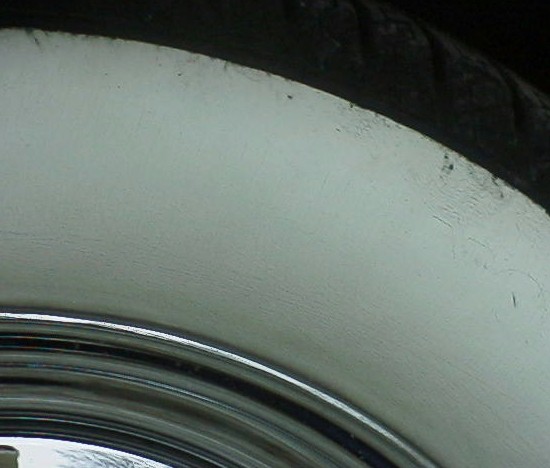

    [/ QUOTE ]Here's pictures of my tires on the S10. I drive this thing everyday. It's been in the snow, and the rain. I just took these pictures today, and the truck hasn't been washed for about two weeks. The whitewalls are a little over 6 months old. I haven't touched them up. The rear tire has sidewall cracks from age. They were in the tire before I put the whitewall on it. The cracks are not from the paint cracking. The front tires don't have the cracks. From 2 feet away you can't see them. New tires shouldn't have the cracks. These tires are about 5 years old, and sat outside on my 66 Caprice wagon. Dean (rear tire closeup)
