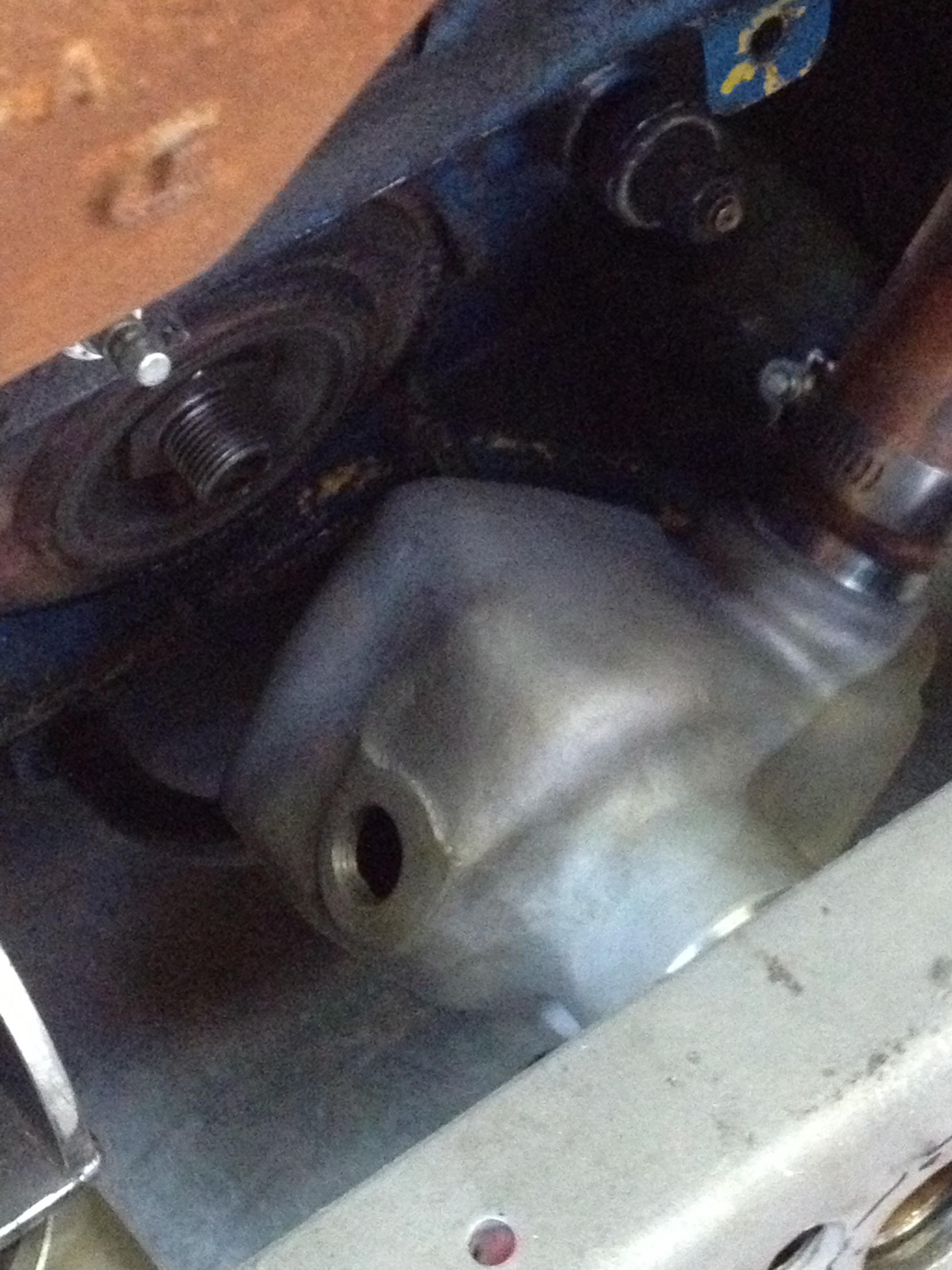

    So with the engine in place, time to start working around some issues. One is the lack of space to be taken up by the steering, oil filter and exhaust.
    I really want to use these manifolds
    and a modified F1 box
  17. Great stuff. Good to see a Ford engine with the dizzy at the right end, haha. Jk
    lothiandon1940 likes this.
  18. Great job so far! I'm sorry I didn't check in here earlier. Great fab work, I like what you've done. Keep it up! :)

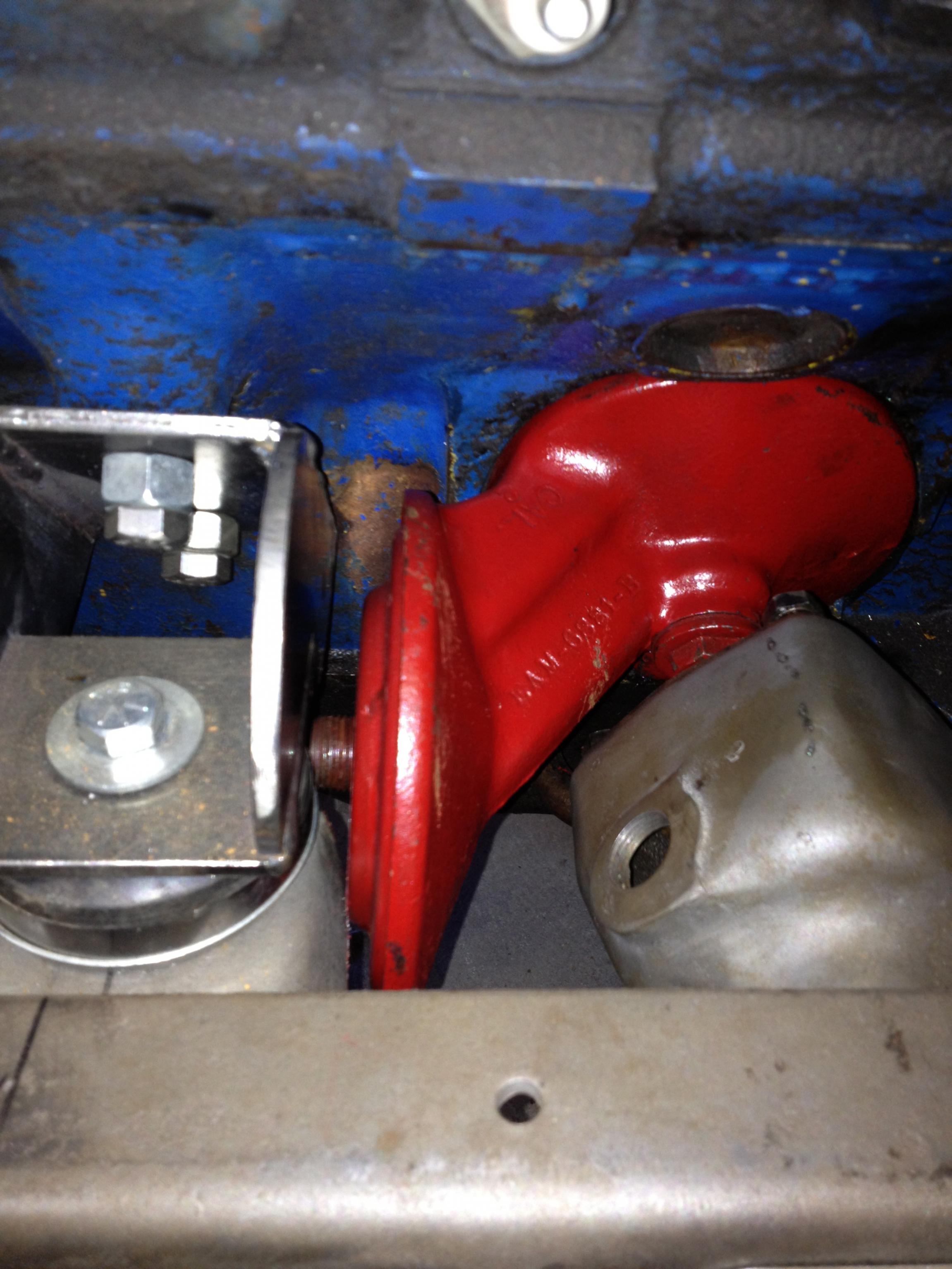

  19. Not sure if there is enough room to put a remote adapter on for the oil filter.
  20. There is something headed his way that may work. We'll see.
  21. Looking forward to it. I'm stuffing an Olds 394 in and A frame so I'm having some of the same issues.
  22. Well, I gotta say that McTim is a one of a kind good guy. Sent me this 90* adapter to try and solve my issue with the filter.
    Got a pretty damned good fit and missed the steering box but pointed it right into my motor mount :mad:
    Unfortunately, the way it is made, I can't clock it to between 7-8 o'clock where it may have fit.
    I'm going to try the Ford racing 90* adapter and see what I get.
    Thanks again Tim!

    If you run out of choices..I used this one from Canton. It can rotate 360 degrees and will NOT leak. They are a little pricey but if you look around you can get one for about $80. It may not be old school friendly but you could disguise it somehow.[​IMG]
  24. Good choice. I actually talked to Bob at Canton this afternoon about that part. If the Ford "all in one" style doesn't work, that is what I will use. Trying to avoid lines if possible. Thanks for the tip!
  25. Damn!!!
    And we have success!
    32owner likes this.
  27. Yikes. Lube it up and push it in. That's a tight fit. Good score!
