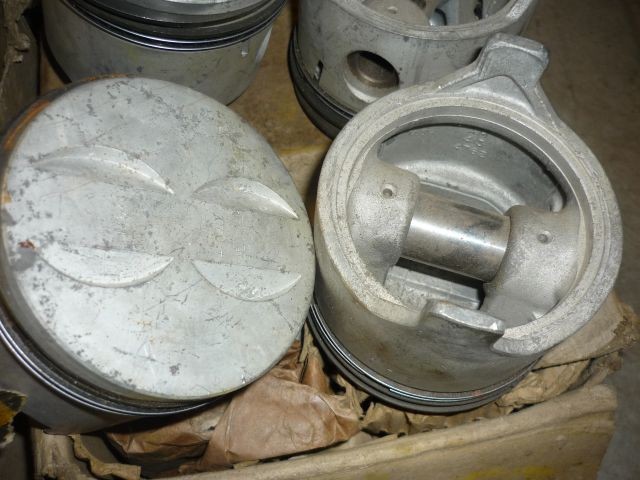

    Engine is all apart and in good shape so far considering how long it has at. I ran across some pistons but I want to know what anyone can tell me about them. They are HEPOLITE pistons. Ever heard of them ? How good are they ? It was an old British company tp the best of what I can find. The pistons are in Canada but I personally never heard of them nor has anyone I have talked to. I see they have made tons of automotive and motorcycle pistons and it sounds like alot of people outside the USA swear buy the original old ones. Let me know what you know !

    Hepolite was a well known maker of replacement pistons for English cars and motorcycles. Never knew they made pistons for Chevs.
    I wouldn't touch them. Buy new pistons. Metallurgy has come a long way since the fifties.

    Never heard of HEPOLITE; are they an old, NOS set? WAAAAAY back in the day, pistons used to come "semi-finished"; meaning the engine re-builder/machinist "final ground" the pistons to the standard or oversize size to be used. There are only a few places in the entire country that still have the equipment to do this "finishing", and the piston manufacturers won't do it for you (I checked!). So, be sure those pistons are't of that design. I learned all this the hard way when I bought a set of Thompson, forged pistons, advertised as standard size, and then found out what "semi-finished" meant. They were for a 265 also! Thompson pistons became TRW (T=Thompson), and that company has again been resold several times. They were a domed piston, and the seller did refund my purchase price due to his error in how they were advertised. That was why I ultimately gave up on my 265 build, and went with a 283 short block (a legal Super Stock short block). There are 265 pistons on E-Bay, but even there they're not cheap, and they are cast pistons. Before you buy these HEPOLITE pistons, you need to find out how far over the block will need to be bored; and it will if you have stuck pistons due to corrosive mouse urine. I remember in high school (66-69), all the guys with 265's built them into 272's (.060 over). The stampings on the block pan rails were for GM engine assemblers; it told them what the specifics were for the cylinder they lined up with. I can't be more specific than that however. Be careful of your oil pump and the swivel pickup; it's a part dedicated to only the 55, 265, and probably hard to find a new replacement. Butch/56sedandelivery.

    I guess they made them because of the cars in Canada that used Chevy engines. I don't believe they are so old as the 50's but I am trying to find out. They are cast to size pistons with rings and wrist pins. 2 sets, .020 and .040. both sets being sold as one package for less than $200. Here is a pic. They look to be a healthy casting. I will be running a retrofitted roller cam using Gen 2 spider and dog bones and 2.2 cyl./3.1 60 degree v6 roller lifters. The parts are cheap and doing the job is not that hard. The external look of the engine will be mostly period correct looking but the inside and heads will be more modern technology.

    I don't think I will go with the Hepolites. I know they are quality parts but they look heavy and I don't want to hinder RPM.
