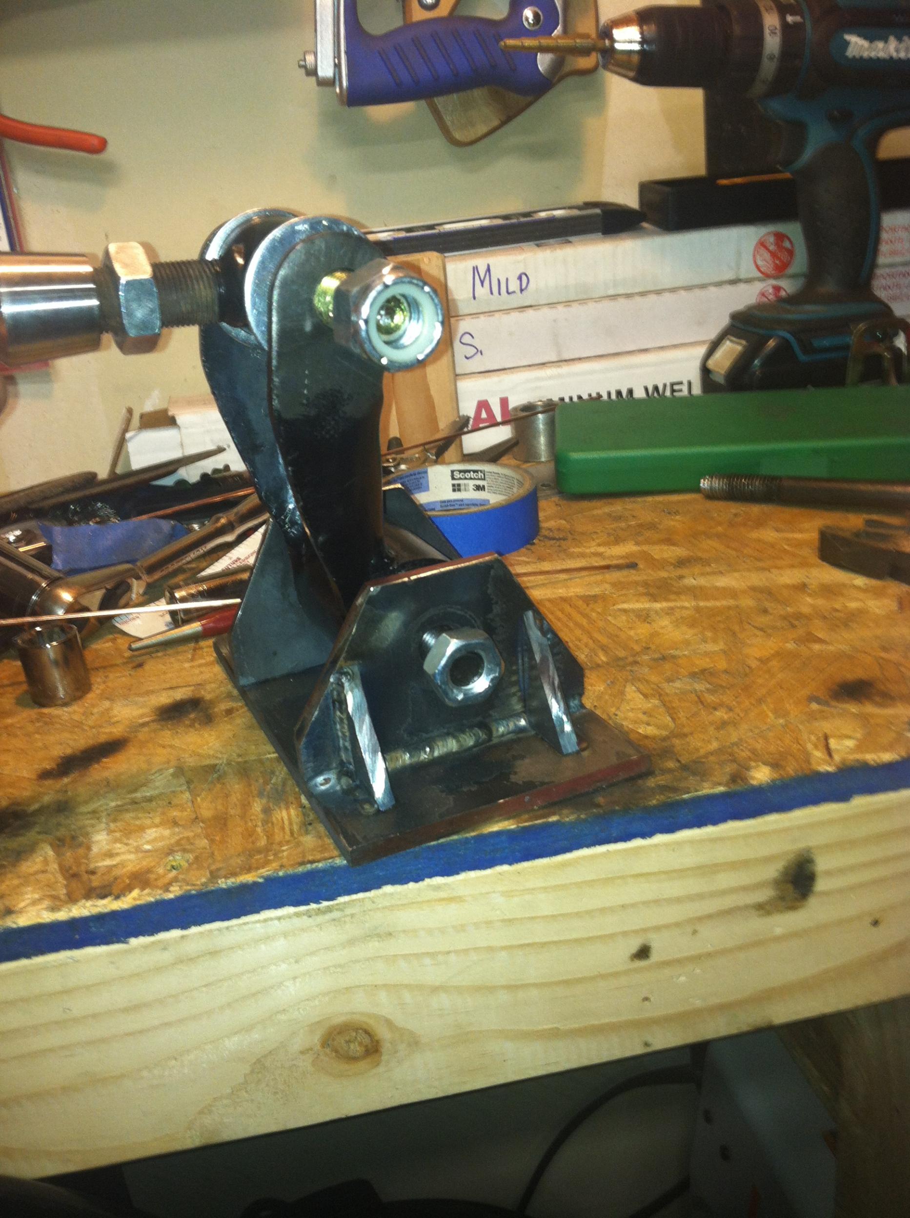

started making a ladder bar/torque arm for my 1950 pick up.
1-1/4" x .120 DOM tubing (12')
3/4"-16 threaded rod ends (x3)
3/4"-16 Comp. Eng. solid rod ends (x2)
3/4"-16 threaded bushed end (x1)
1/4" mild steel plate
leaf spring shackle, 90's chevy 1500 (x1)
I decided on a torque arm style mount because it would rotate about the center of the rear axle and not bind during street use. Ladder bars tend to create a giant anti-roll bar out of the rear axle, limiting articulation.
the hardware is for mock up, the non-hardened stuff will be replaced. I was having trouble finding hardened bolts with the correct shoulder length.
the shape is basic, consisting of two triangles, one circumscribed about the other when finished.
my truck is for street use. i plan on taking it to the track periodically. with this set up I feel that i can retain the stock style leaf springs.
the front shackle mount is 1/4" mild steel. the rear axle mount will be more of the same.

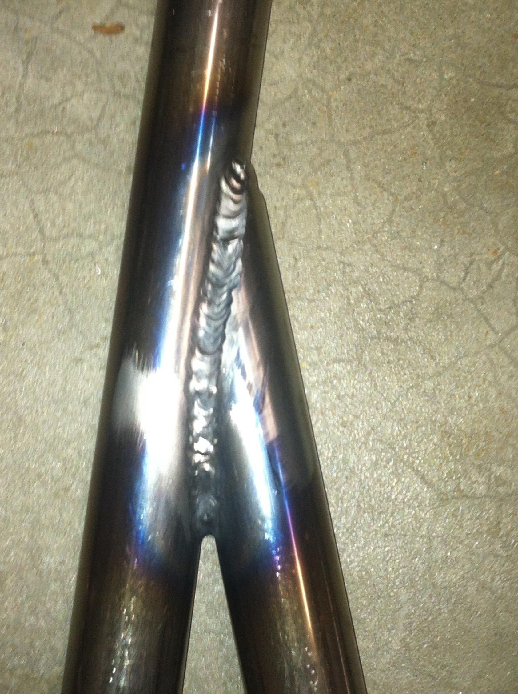

welded the ends

the triangulated outside bar with ends welded on.
i'm using a Hobart TIG for all welds

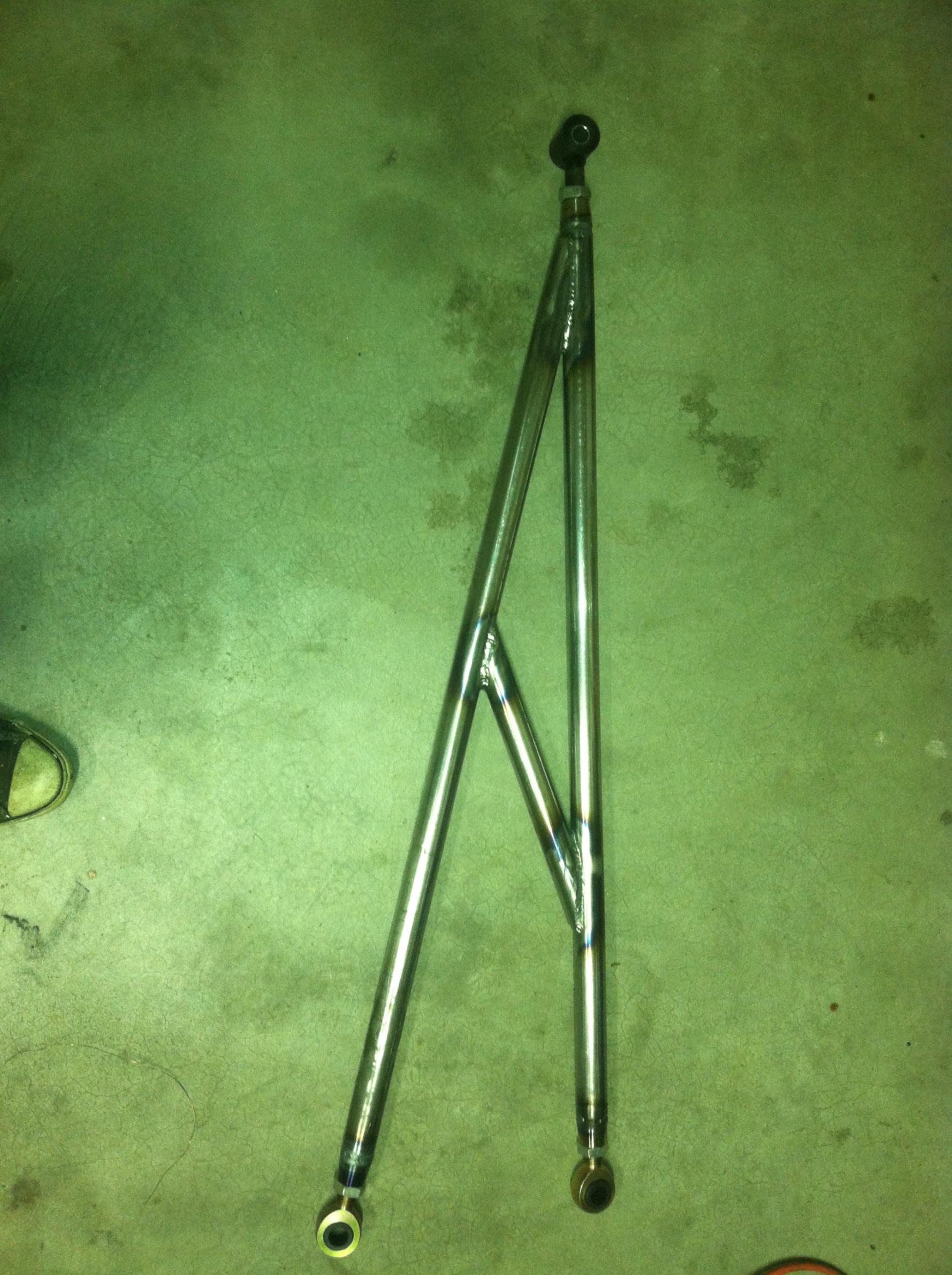

i've been working on this for two days. i want to get it done this week.
the bar is 34-1/4" on the top and 10-1/2" on center.

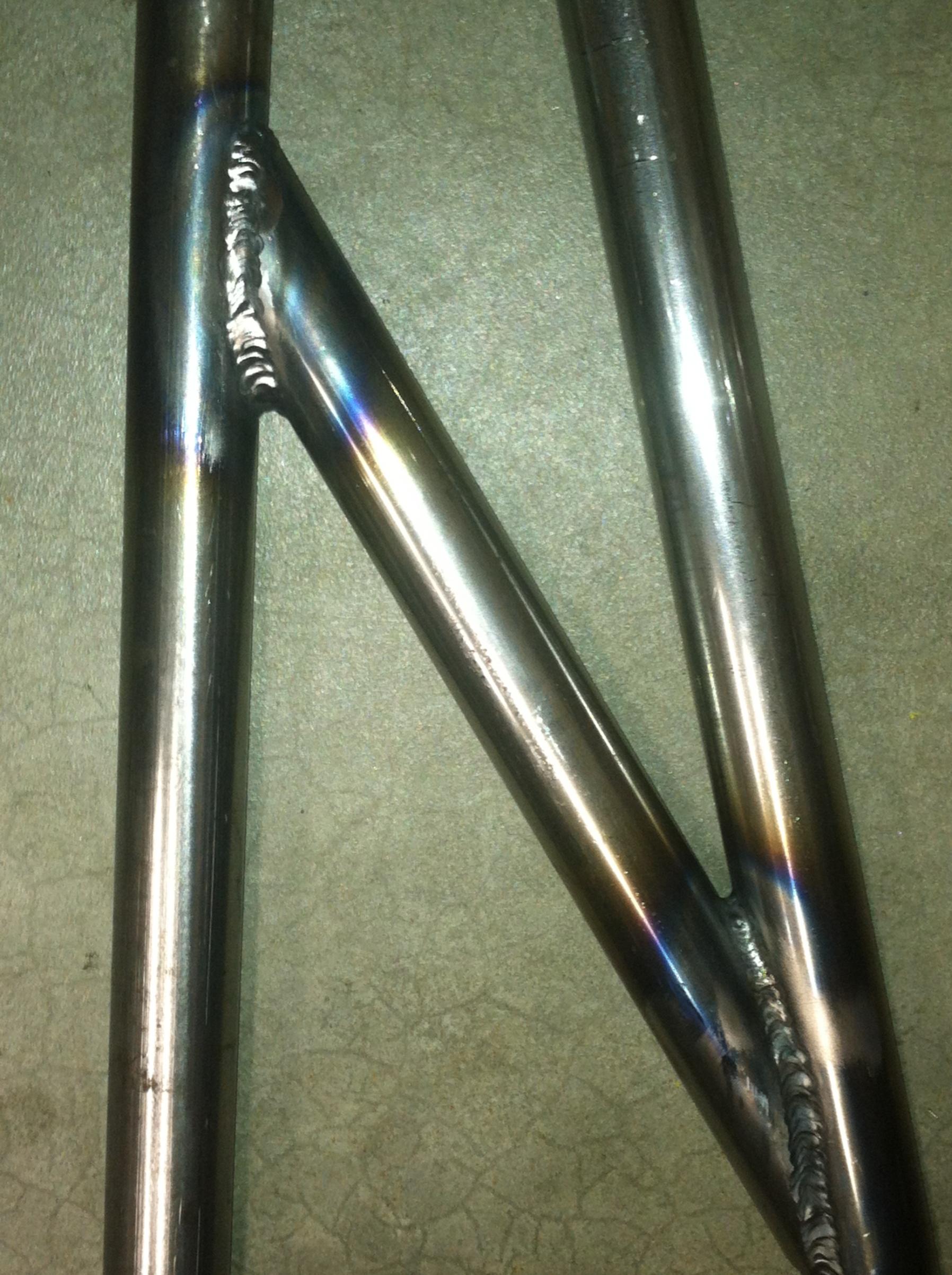

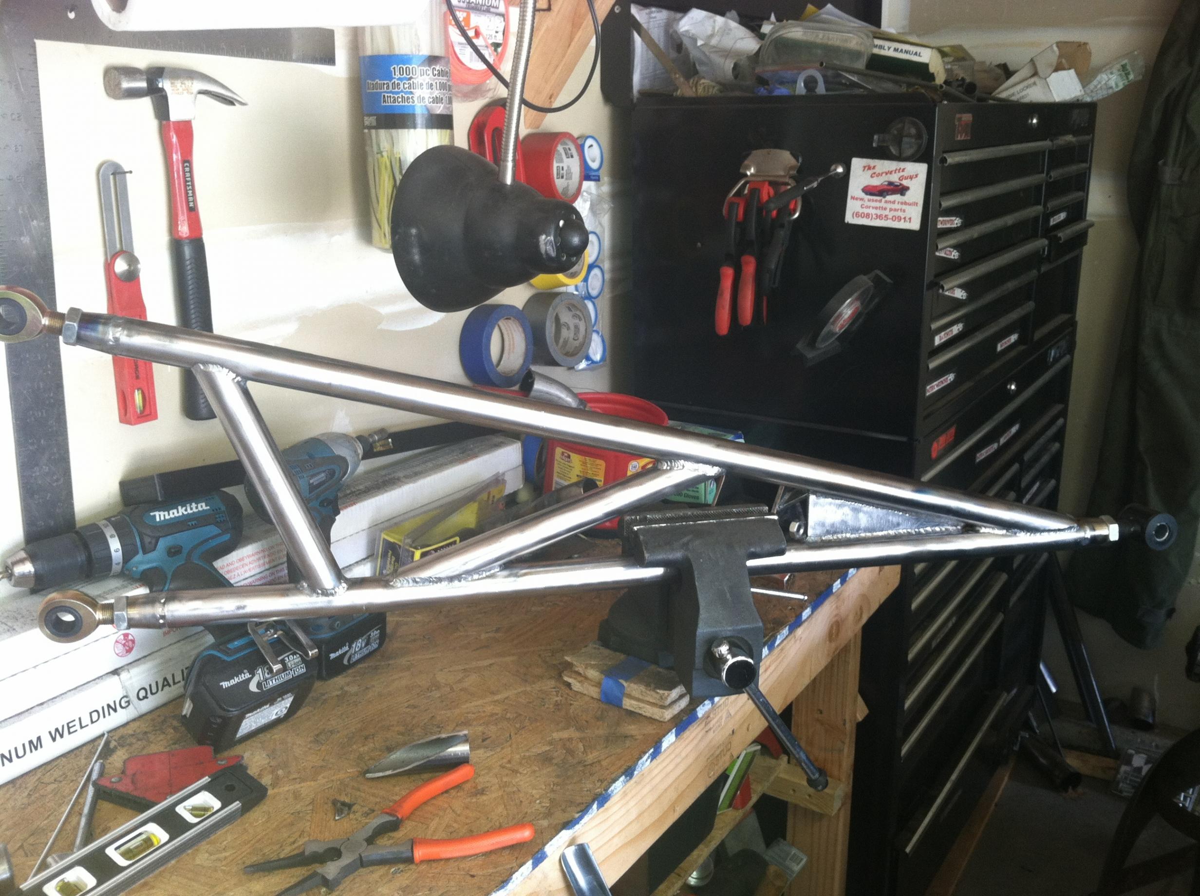

I added another brace today. I've been fishmouthing the tubes with a grinder and such and it's proved to be a pain. the cuts aren't perfect but the weld fixes them right up .
still no jig. Been doing all of the sizing and work on the bench with the bench vise.
I'm going to add another brace in the back to complete the inner traingle and brace the axle side of things. The front might get a triangular gusset.

Finished the bar. Added a vertical rear support and a gusset in the front. Going to make some end link safety straps because the new bars come with them and it seems like a good idea. Just gotta make the axle brackets now.

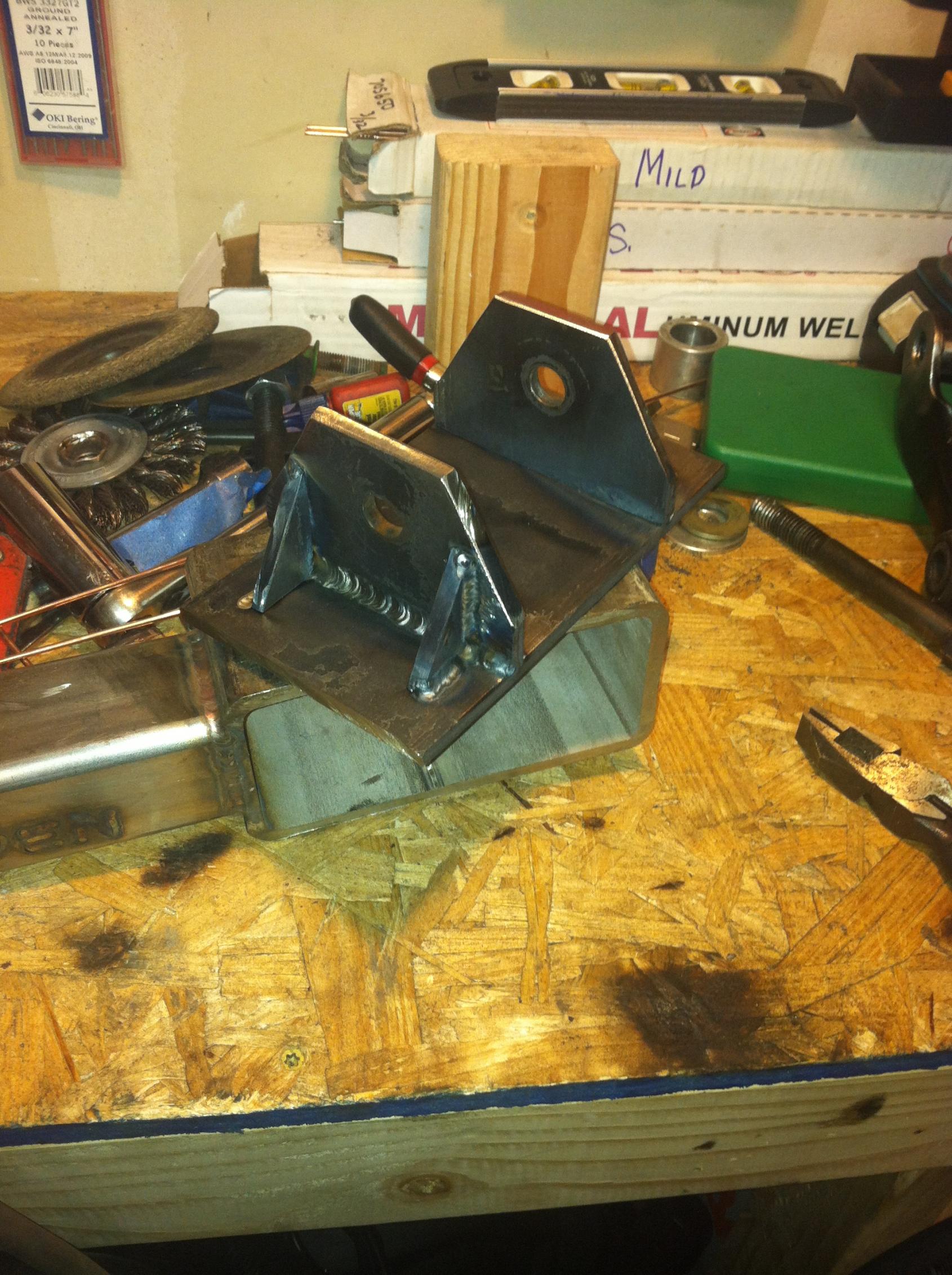

used some string and a framing square to find the centerline of the frame. the explorer rear axle has the offset pinion so i couldn't run it parallel it to the driveshaft.
the mount is made of 3/16'' angle steel that i trimmed down with grinder. rear bolts are 3/4". i plan on making a brace running around the back 180* of the axle housing. should be stiff enough.

i used the TIG to weld the bracket on. no problems. instead of cast iron, the ford explorer axle is steel. welds pretty easily.
the bottom bracket is probably going to be more of the same 3/16'' angle.

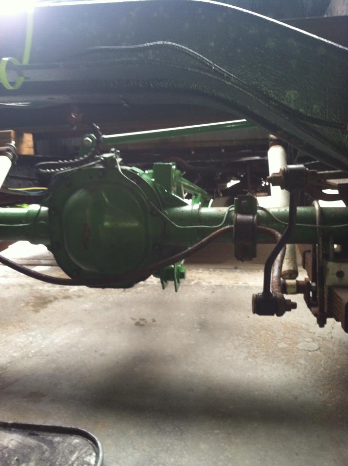

The springs are stock. Had a local spring shop go through them and check them out. New clamps, bushings, all hardware, shackles.... It's all new. Shouldn't be any different than normal except for the age of the springs themselves. The shocks are new. There are no springs missing.
Yes, regardless of width, the springs do locate to the center, but their width is a big factor.
http://www.engineersedge.com/materia...ing-design.htm
They locate to the center, but given their width, spring eye height, and shackle thickness, they're not nearly as rigid as newer, wider springs. I've been considering new sprigs for sometime, and I am fairly sure that I will adapt newer springs from a truck (explorer, s10). they will enhance the ride and I suspect that I will no longer need a panhard. If I have new stock style sprigs made, the bar stays and I leave the rubber bushings in the shackles to allow them to flex and let the bar do the centering. As it stands now, it stays. If the suspension has a propensity for some lateral movement, then the bar shouldn't bind it. Another option is making a new rear cross member and mounting the shock perpendicular to the springs like a coil over set would look like.
Is it a band aid? Yes and no. New shit costs money, and I had the bar laying around. After a bunch of reading on the issue I didn't think it'd hurt much. There's some interesting threads on rear panhards by the ford lightning guys. Their bars are longer and move half as much, but i don't think I'm in danger of breaking anything. I'll figure out something to do with it and post it down the road.

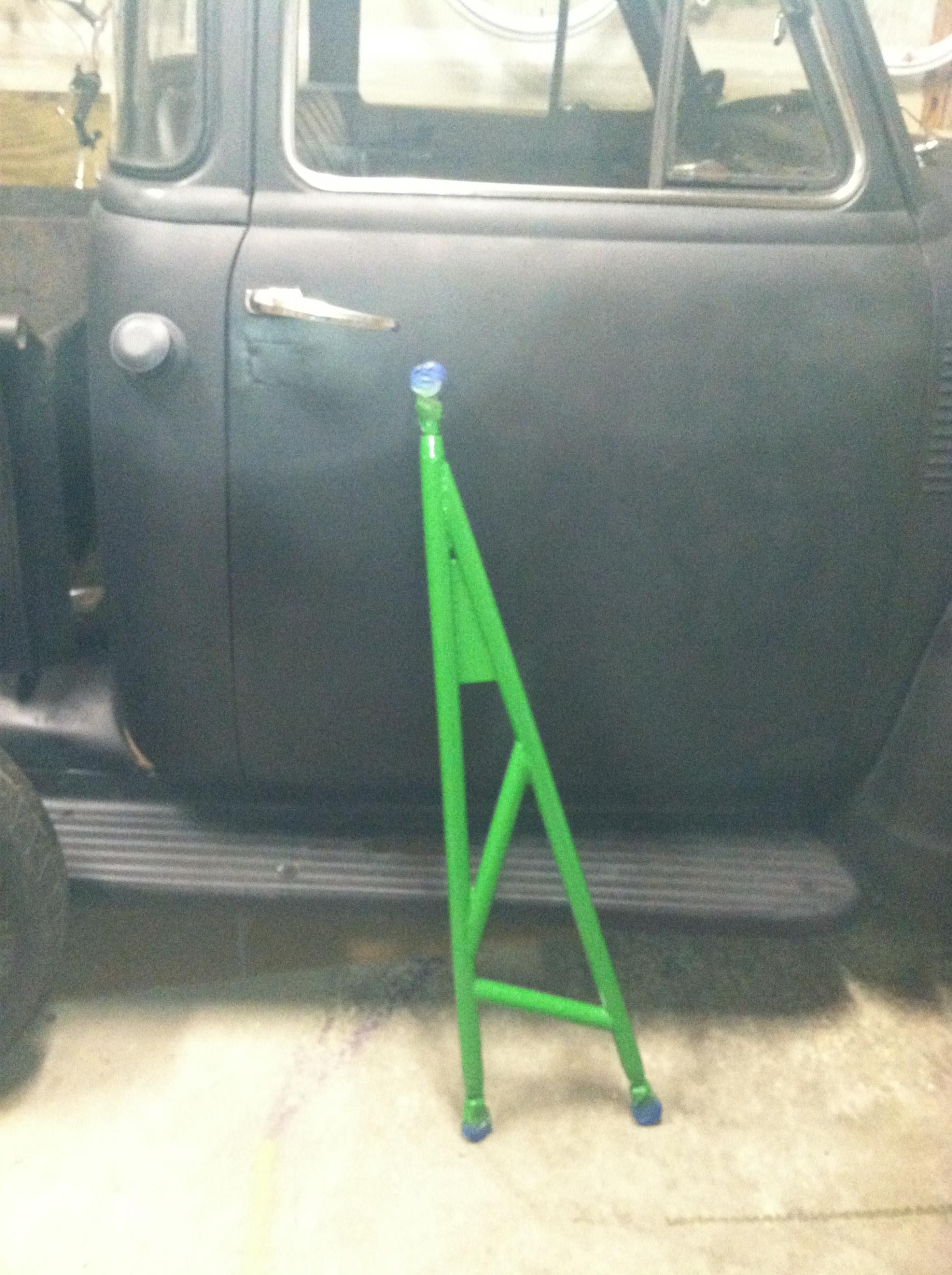

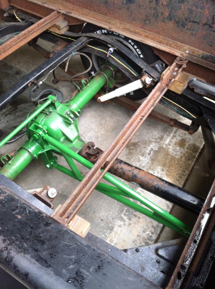

finished everything up today. got the lower mount done and bolted on the shackle mount. it started raining so I didn't get a chance to test drive it. i'm calling it done for now, although I noticed some hot cracking (+1000*F; happen instantly) on the lower weld and some cold cracks (-1000*F; takes days to show) in the upper. gonna grind those out and use the MIG on 'em. from what I've read, I should use a lower amperage setting and adjust my weld pool to something that isn't is wide, even layered in some areas.
live and learn I guess. the lower mount was more of a pain than the upper. I had a suspicion that I should use a different machine for the brackets, but I figured i'd give it a go with what I had on hand. i'm picking up my MIG in the next few days so i'll get it sorted out then.
