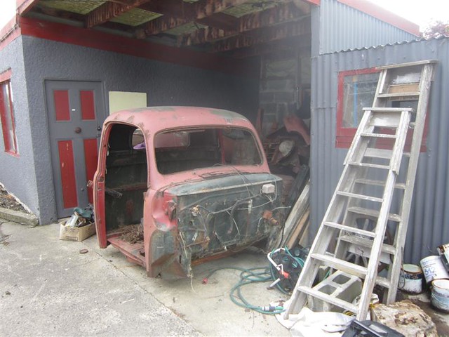

    This is what I started with in January..[​IMG]
    and the chassis.

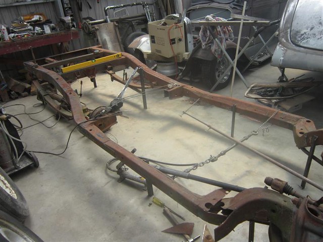

    I started by narrowing the chassis from the base of the firewall back. I should mention its getting a 283 out of a '64 Ponty,a '57 3spd box, unsure of the diff ...and an assortment of '46 Fleet-master and '59 Dodge bits n pieces too.

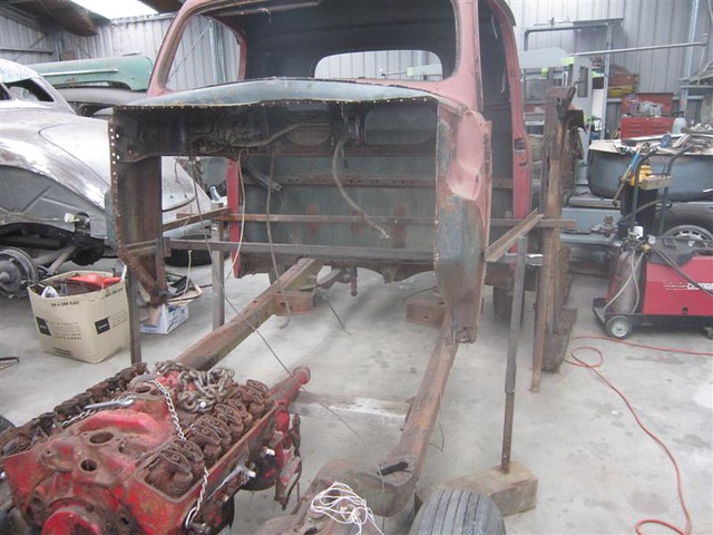

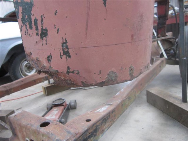

    once I had the chassis tacked up close I sat the cab on to check the fit. Then moved the spring pads on the diff,and started cuttin on the cab.
    Firewall coming out..

    at this point the things were a bit up in the air...

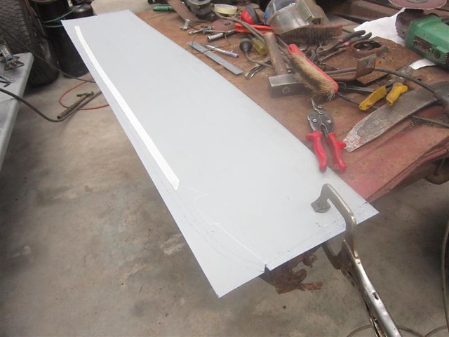

    I cut out a blank for a new rear floor section
    then , i trimmed out the panel using aviation snips and my 'man'size snips
    I turned the edge flange using my swaging machine (bead roller) and put a joggle across it in the bender

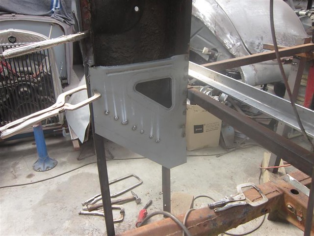

    I trimmed back and cut out the inner structure of the R/H side of the front bulkhead..
  10. fleet-master
    Joined: Sep 29, 2010
    Posts: 1,780
    fleet-master

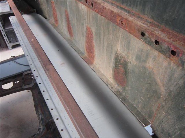

    I cleaned up and treated the remaining rust and zinc primed the inner surfaces. Then made up the new section of inner with some similar swages ,and made it 4.5ins deeper to accomodate the channeled floor...

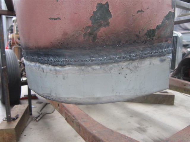

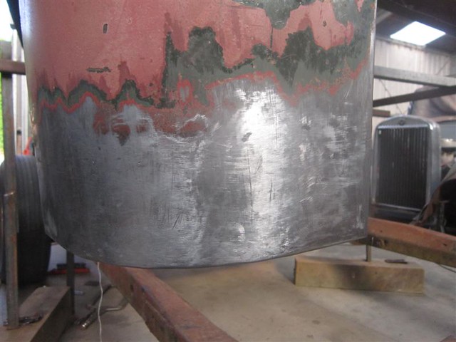

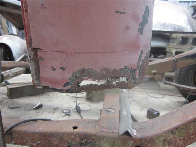

    Next I repaired the rear cab corners..
    rusty L/R corner outer..
    [​IMG]trimmed..
    new section oxy/acet butt welded in (hammer welded)
    and file finished ..

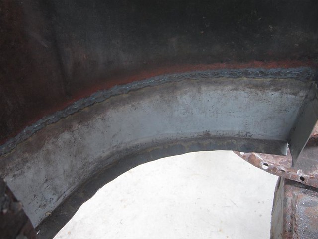

    fleet-master

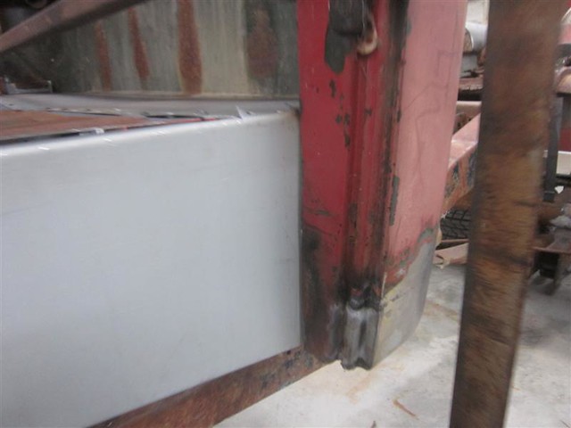

    The R/R cab corner..
    [​IMG]New section welded in..
    [​IMG]R/R corner metal finished..

    fleet-master
    R/R cab corner inside

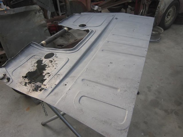

    the bottom side of the floor after sandblasting..
    [​IMG]i trimmed 4.5ins off the top of the firewall ,allowing for redoing the flange along the top in the bender. I forgot to take pics tho. Then I repaired the RH toeboard area by making up a new piece and gas butt welding it in. I forgot to take photos tho. :D:eek:
    I fitted a few new sections into the inner B-pillars and fitted up the new -much deeper- sills (or rockers as you Americans call them)
    In tandem with those bits, I clamped and PK screwed the new rear floor section in place at the new height..

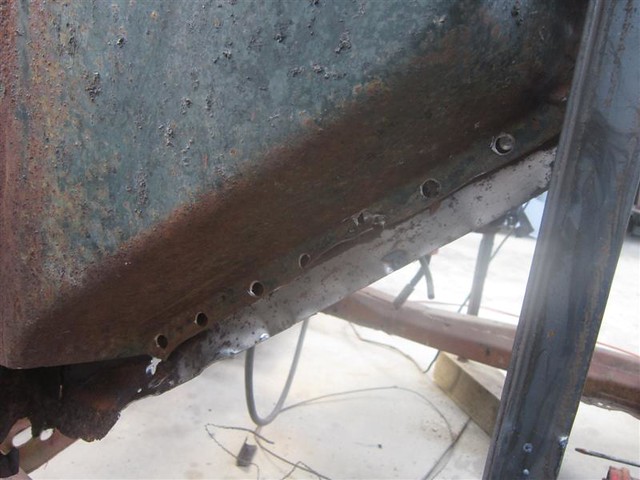

    With the sills in place determining the height, I was able to then re-fit the firewall. The advantage of drilling out spot welds and reusing them paid off big time here..
    The pic shows the plug weld holes across the top of the firewall. The tack weld was an initial one to hold the panel in place. Before welding the holes up I used a skinny cut off wheel to remove the paint as needed to ensure I got good welds.
    I should mention ,(for the benefit of anyone who's not done this type of thing )that throughout the whole process-right from the start on the chassis- I am constantly making sure everything is true and level. The pic shows ,I'm doin ok at this point :p[​IMG]
