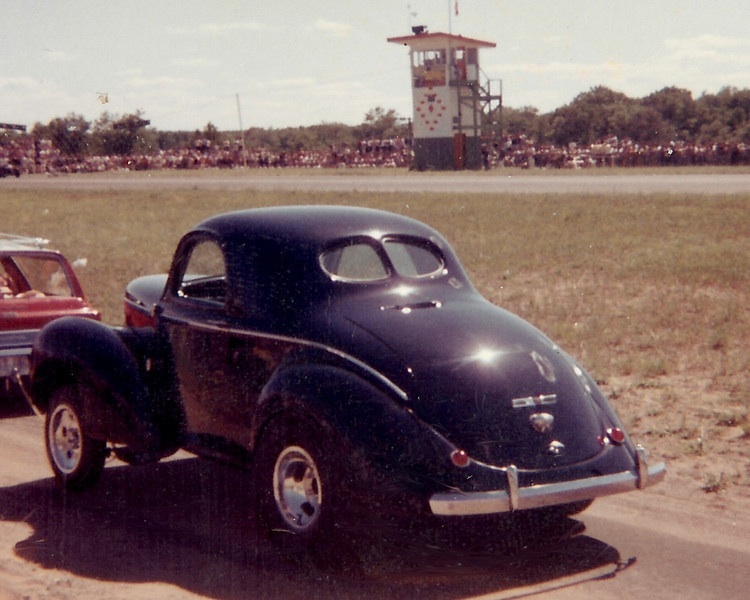

    Our 41 Willys project is nearing completion. This car as seen by the attached pictures used to be raced by Elverne Pfeifer and was NHRA "Best Engineered" in 1964. We have been working on the car for the past 2 1/2 years. If you subscribe to The Rodders Journal you will also see an update on this car in their latest issue, #58.
    I will try to attach several pictures to show some of the progress of the build throughout. We actually have an entire album and video of the car during the entire build. Hope you enjoy!

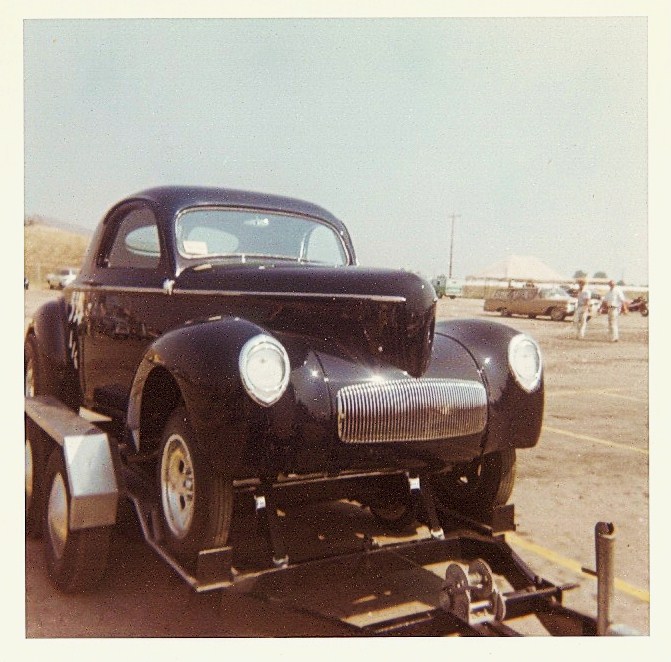

    Here are so more historic photos of the Willys.

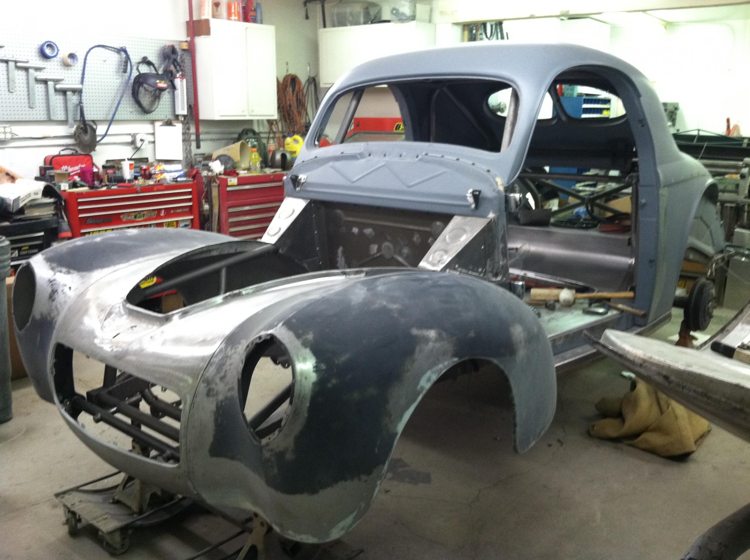

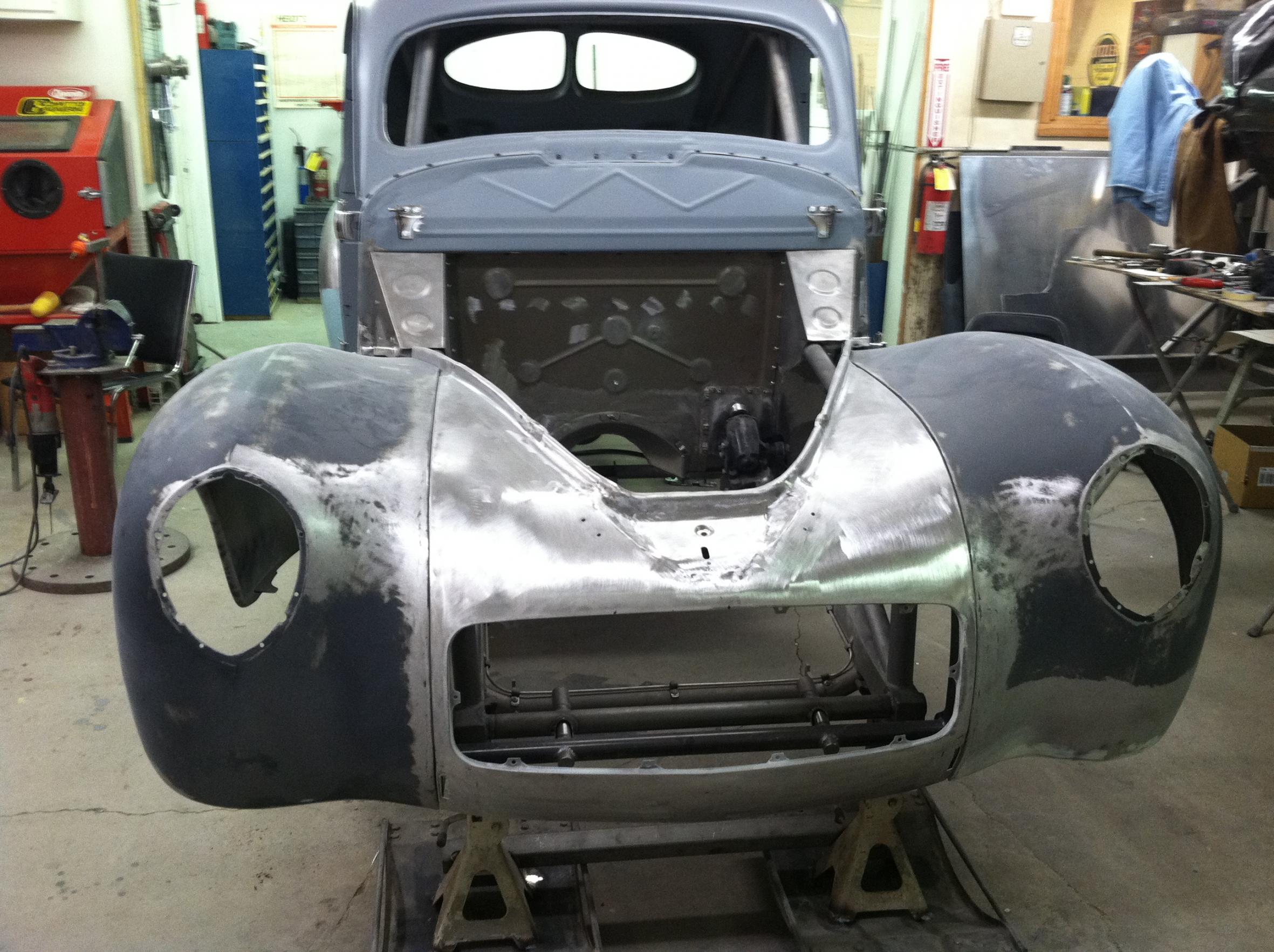

    Here comes the build. The Willys is all steel. The rear fenders have been worked from where they were cut originally for racing. They will now fit better around the new slicks. The body, fenders, doors, etc. have all been gapped and fitted better than ever.

    Attached are a few more of fitting and metal work on the body. I will continue to post more tomorrow and get into the finished chassis pics and body tomorrow. If anyone has an interest in seeing more pictures or details of this car, let me know.

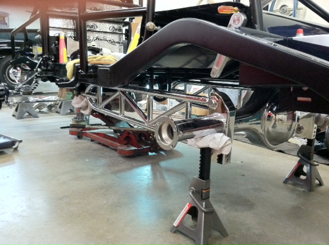

    Back to the Willys. Pictures are of the chassis prior to assemble. Aesthetic Finishers in Piqua, OH was responsible for the powder coating of the chassis/cage and other parts. The firewall is painted to match the body. Everything under the Willys is basically chromed. Pictured is the chrome rear end and brushed aluminum front engine plate. The chrome ladder bars (designed to look like they were in 1964) are wrapped in plastic.

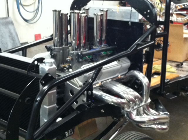

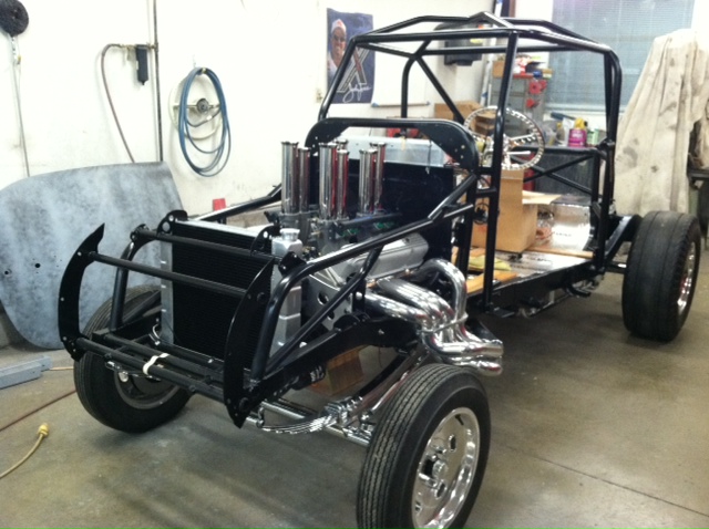

    Ongoing progress as the chassis is being completed. You can see the chrome ladder bars, rearend and chrome front straight axle and springs. LoMan Rods in Tipp City, OH fabricated the one-off ladder bars and two sets of headers for the car. One set of headers will dump into a collector and go into an exhaust (see full headers here). The other set will come off of the flange (from the first section of headers and dump into straight "zoomie style" headers right under the front fenders similar to what it ran in 1964. Most likely these will be on the car 90% of the time since they look so cool!
    The rearend has a sway bar, coil-overs and set up to handle the power with big axles and posi unit. I am planning on enjoying the power in the car so I wanted it to go relatively straight when I get on it.
    LoMan Rods also fabricated the front engine plate to mount the engine to. It is brushed aluminum to match a lot of the other parts.
    The engine is a Chrysler Wedge with Hillborn fuel-injected stacks. It should have 600-700 HP. More pictures to come soon on the engine.

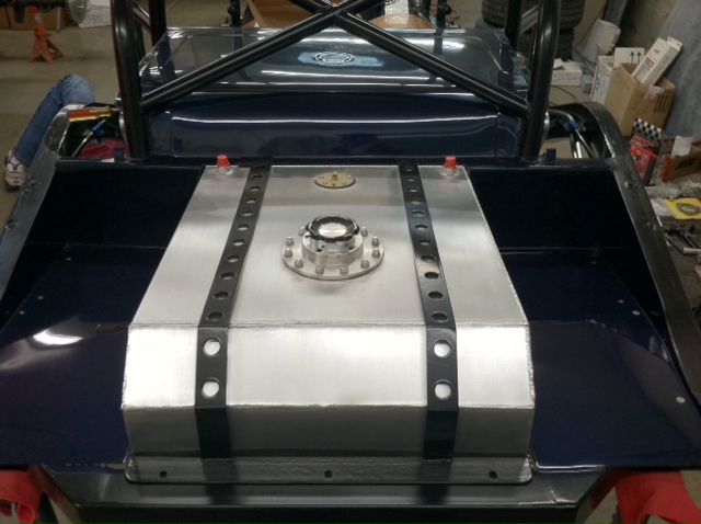

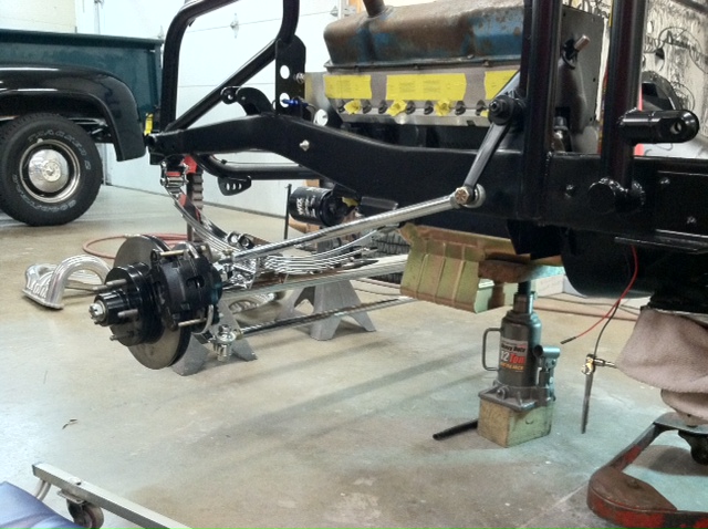

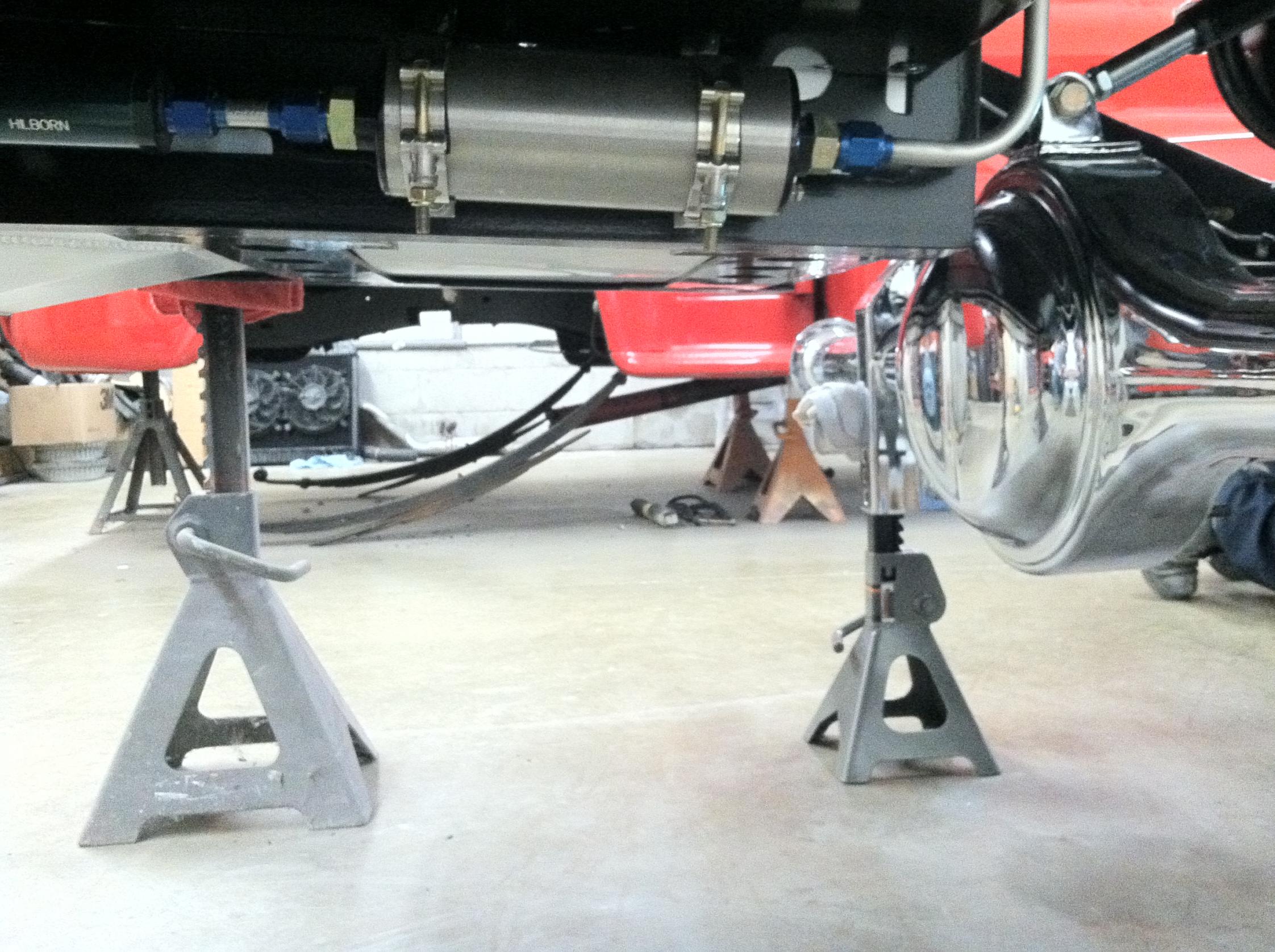

    Here is the front suspension being put on the chassis. All of the springs etc. are chrome. We now have every bolt on the suspension stainless and has a machined head to match the brushed aluminum.
    The rear fuel cell has a machined center and cap. LoMan Rods fabricated parts of the tank and machined the tie downs. The floor in the trunk is painted to match the body. It will carry dual batteries that will rest in trays (on each side of the tank). It will be covered with a painted section made by LoMan Rods.

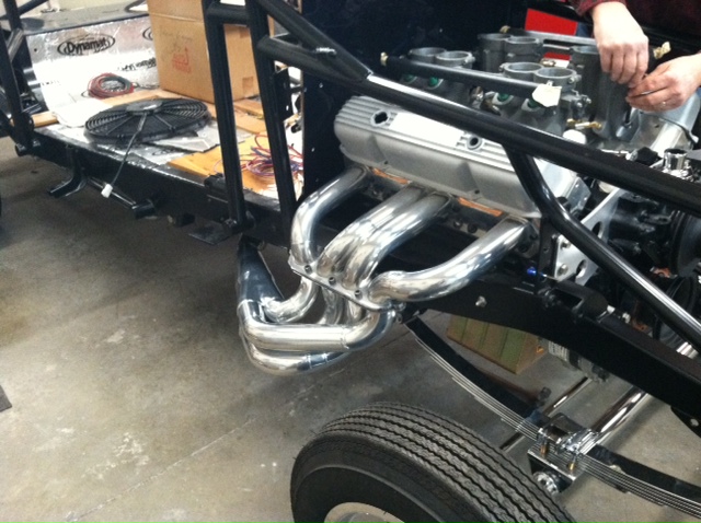

    The chassis continues to go together in these pictures. Note: the curved brackets on the front end. They were designed to fit the front sheet metal together. This piece slides into the front part of the frame/cage. When you unbolt the front fenders from the body, the entire front clip can slide off in one piece. LoMan Rods in Tipp City designed and sells this setup for other Willys as well. This is the first one, of course.
    The full headers were installed at first so when we go to start the engine for the first time it is not as loud and may be easier to tune.
    The polished stacks were made by LoMan Rods. The stacks that came with the Hillborn setup with cheap looking and I wasn't impressed. These were made out of stainless and then polished. Basically everything in the engine compartment is brushed aluminum except for the stacks. I wanted something nice and shiny when the hood came up.

    Engine Update. LoMan Rods in Tipp City, OH made the stainless stacks for the injection, front engine plate, custom headers as well as the brushed aluminum plate under the polished stacks/injection.
