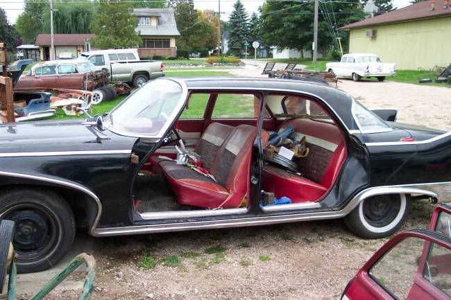

Here's my entry for tech week: making a four door sedan into a two door post.
I started with this car, a nice driver 1960 Plymouth Fury four door sedan. It has original paint on it and drives real nice, but it's ready for a repaint and needs some rust repair also.
I figured as long as I have to paint it, I may as well make it into a two door sedan. To do the conversion, I bought this '60 Savoy club sedan on eBay for $60. I had to drive all the way to Mississippi to get it (last year when gas was cheap) but it was worth every penny. The donor car had no floors, drivetrain, suspension, or hood left, but both doors were plenty solid for me and the sections of the rear quarters that I needed were intact as well. Here's what it looked like when I dragged it home.
So the conversion starts by unbolting both doors on one side. I'm doing this one side at a time.
Then I used a sawzall to cut the old door pillar out.
When I cut the center door pillar out, I was expecting the pillar to be an important structural piece of the body. I figured it would be very solid and tied into the rockers and upper roof rails. It wasn't. In fact, I made my cut on the top side, then I pulled out on the pillar and it snapped right off of it's spot welds. In these pics, you can see that the pillar was not tied into the rocker structure beyond a couple of spot welds, and the cut through the roof pillar was only sheetmetal, no tie-in into the structure of the roof.
