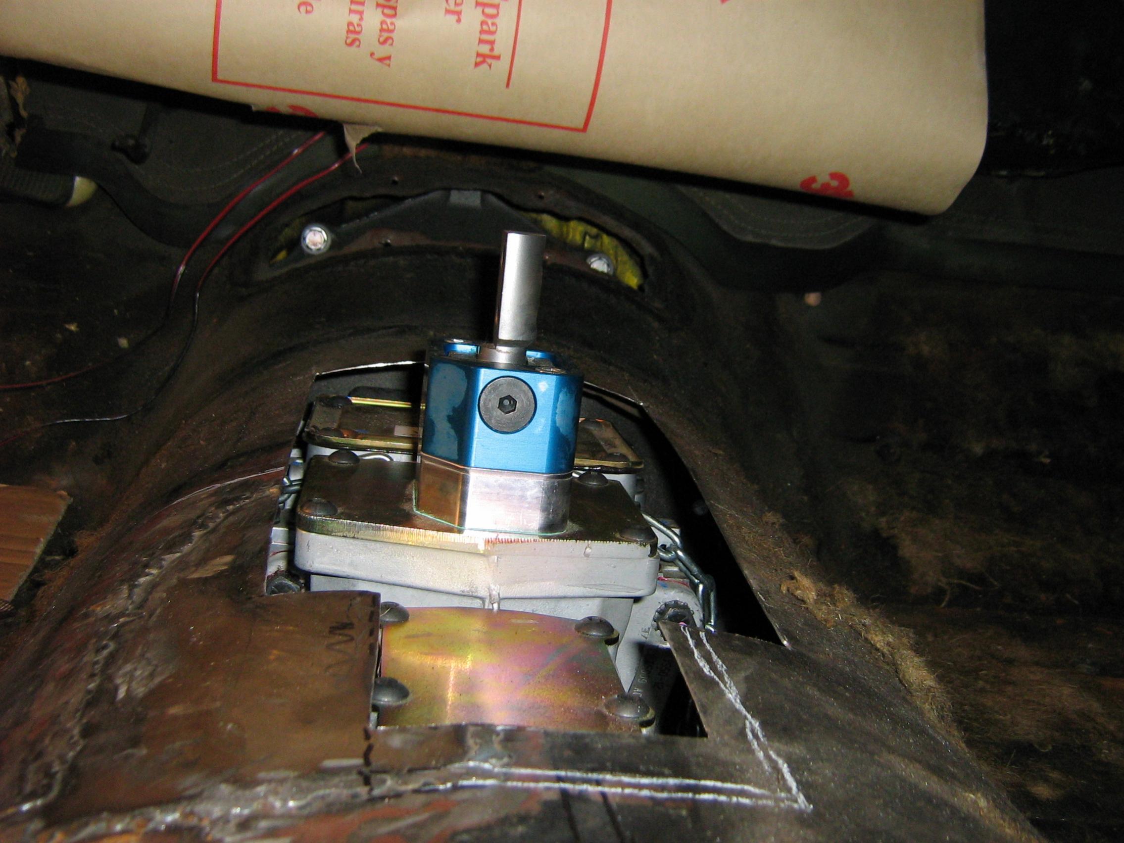

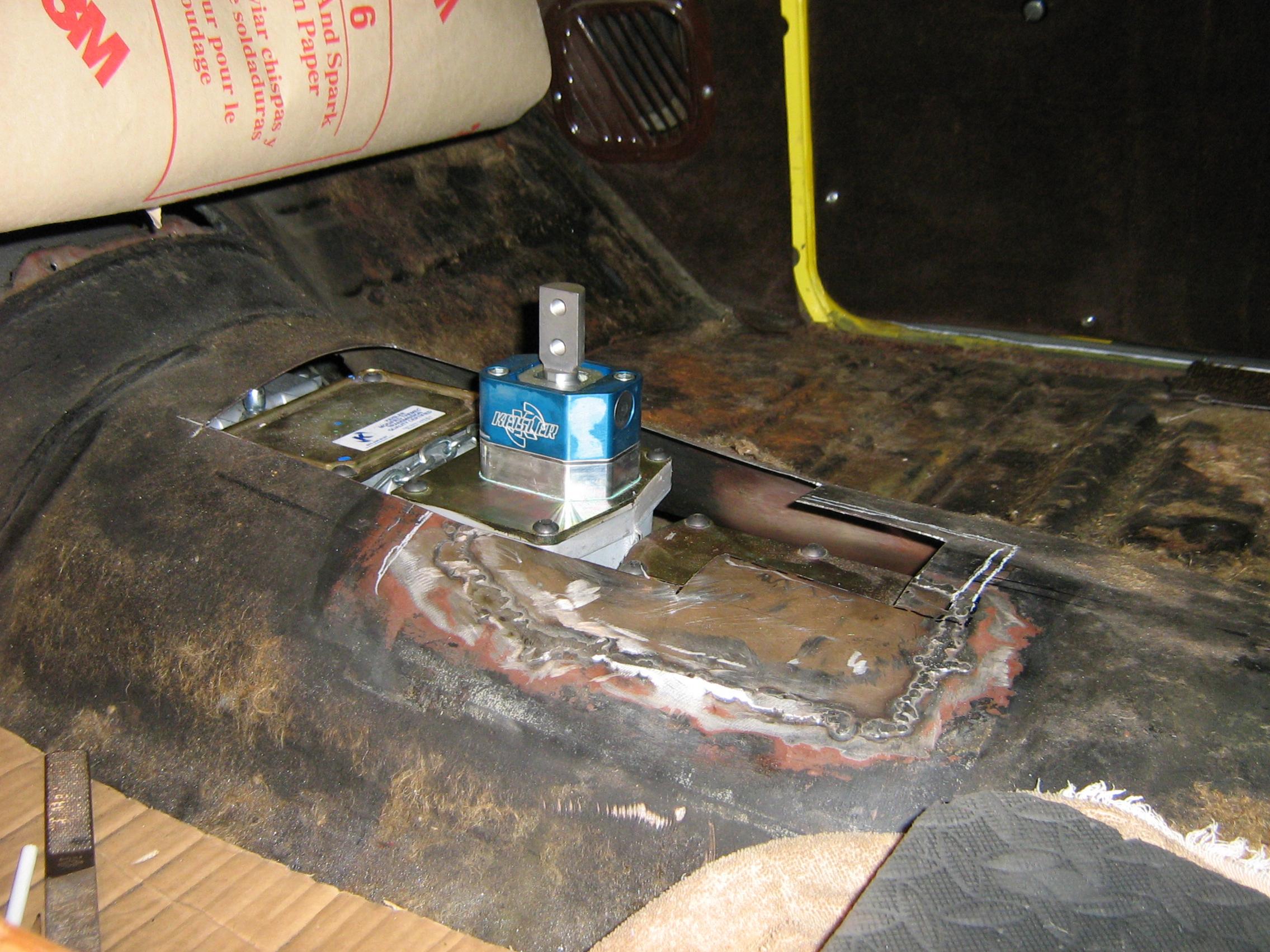

    The floor of a 54 BelAir is very similar to a 55 BelAir. Keisler didn't offer the tunnel sheetmetal when I ordered from them. So, I went with Eckler's tunnel sheetmetal. Used nutserts so the sheetmetal can be removed. The mid-shift location is ideal for bench seats. See my 56 install pix.

    I had a mid shifter on mine in the Plymouth for ever, and it worked very well with the bench for placement, but the shifter itself didn't last very long. I don't know who is offering them now, but I replaced my midshifter four times in the first 7 years I drove the car due to leakage. In this latest rebuild I ended up going back to the stock rear shifter flipped to the forward posistion and reangled my home made aluminum handle to work. When I have back up and running I'll let everyone know how it worked.

    Having read this and a few other comments I'm going to try the rear position flipped and play around with the shifter handle. I'll post up pics when it goes in.
