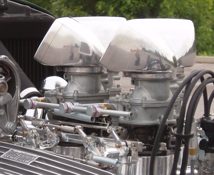

"4 carb units. My favorite for SBC here is the weiand staggered intake with 4 small 94’s or 97’s these units look cool and street perform very well with progressive linkage.
Linkage here is not for the weak at heart but well worth the time. You need to have a machine shop make shaft extensions for the 2 carbs mounted on the pass side of the motor. All linkage is mounted on drivers side you also need to make a support bar that fits over all 4 carb shafts to support the long extensions.
Like this, it took a while to make.

trying to get the bugs out and progressive linkage on a 235 with an offy 3x1 running rochester B's, wouldn't happen to know if it'll run all 3 w/o progressive or if anyone makes/made a progressive linkage?
BTW, your info rocks!!!
you can make your's into progressive linkage it's all about leverage if you lower the center carb linkage pivot hole and lengthen the outer carb linkage pivot holes [may have to extend arm upwards by bolting a extension to existing arm] and install pins with sliding lingake and stops in the end carbs you will now have progressive linkage!!! go look at "inliners international" web site for carb modifications if you can't find ask em they did a article way back on modifing roch 1 bbls if you got a stock 235 it would run a lot better with a dual carb set=up john
