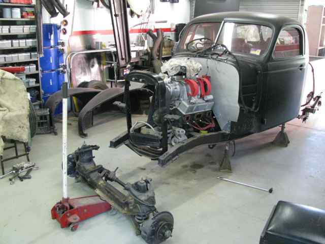

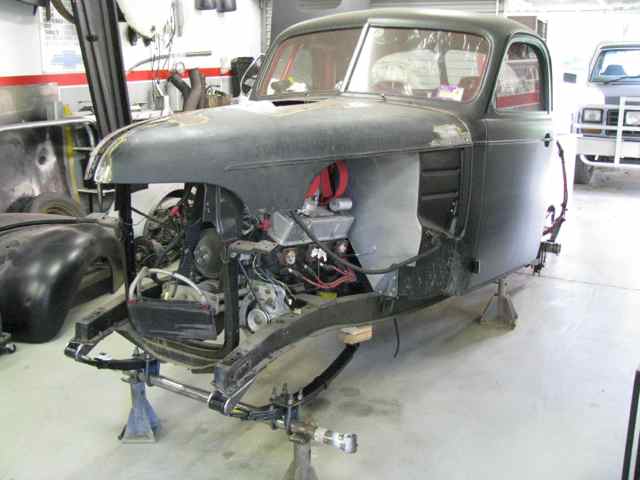

    Work begins, I wanted to set the front axle in the car, removing the least amount I could, to get an approximate idea on how the car would sit when completed.
    I have a local guy that fabricates T-buckets. He makes his own front axles to suit locally produced stubs and brakes, so i asked him if he could make an axle without the drop? Not a problem, supplied him with a width and I had an axle ( with welding certification ), steering arms, and calliper mounts a couple of weeks later. While that was happening I had King Springs make me some front leafs. The man at Kings was very helpful, although he couldn't understand why I would want to remove an independent, rack steered front end, for antiquated suspension and steering.

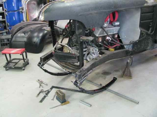

    I tack welded some front spring mounts, the rear of the springs sat on blocks of wood. I made the axle mounts, and dummied it together to see what it would look like and check for foreseeable problems before I went beyond the point of no-return.
    mad mikey and volvobrynk like this.

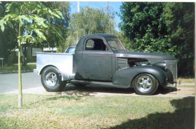

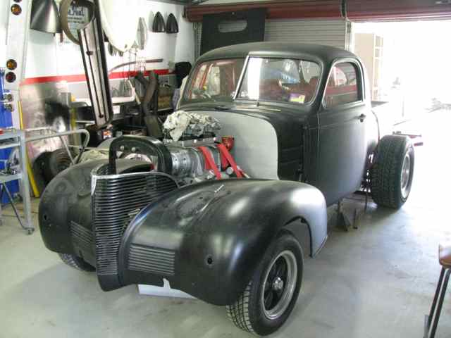

    Now it was time for the visual, yeah baby, point of no return or not this is going to happen.

    i like it.looks mean as hell now! but i have a question, is that front wheel centered in the wheelwell. my old eyes dont see so good but that wheel looks a hair to far forward.is it?
  13. Fatbrosracing
    Joined: Jun 23, 2009
    Posts: 242
    Fatbrosracing
    from Australia
    I agonised over that for a bit. If you put it in the "measured" centre of the arch radius it actually looks like it's back to far. As it sits in the photo, it sits in the centre of the lower point of the opening and bearing in mind this is only roughly dummied up, but as the axle travels up it will also travel back a tad. Basically i fiddled with it until it looked right to me.

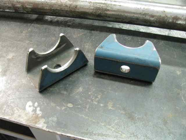

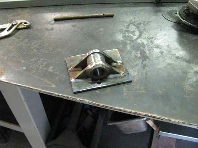

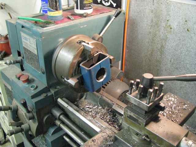

    I made the shackle mounts from scratch, turned some heavy wall tube for the bushes. I find that if I need to make several things the same shape, I tack them together until the majority of the work is done and then separate them for a final once over. I only drilled 2 mounting holes at this stage to allow for adjustment.

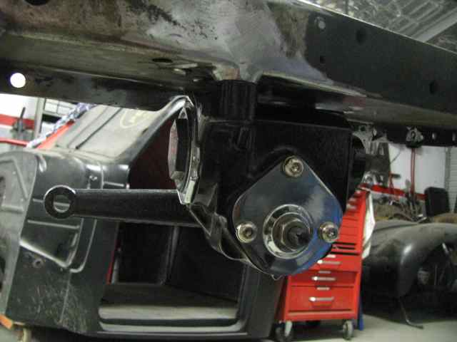

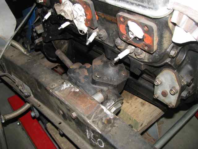

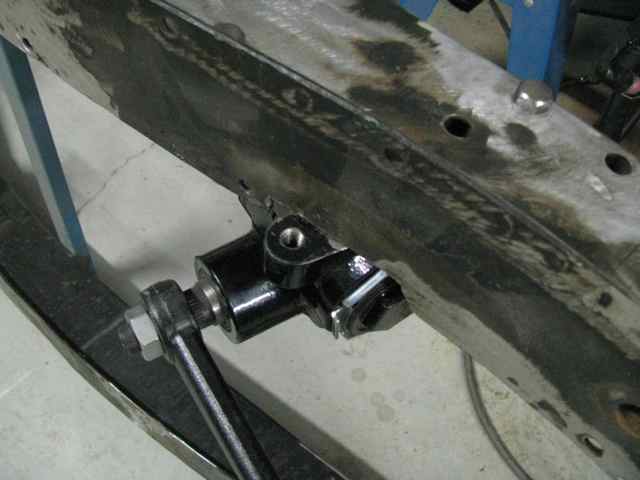

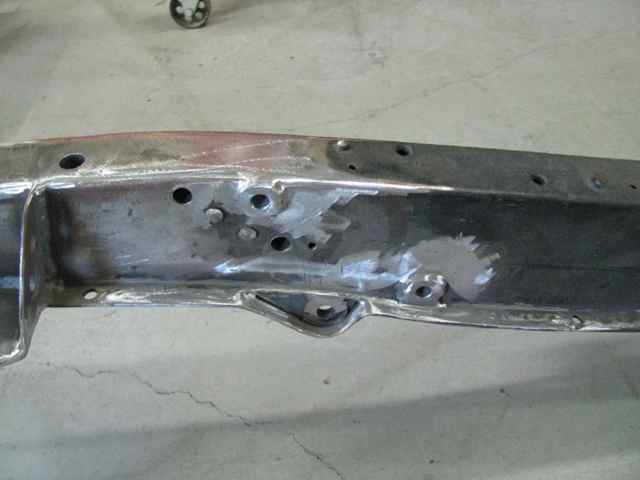

    With the engine lowered to try and level the carbs out a bit, steering was next to be tackled. I was going to use a Holden box but it was a real tight fit. Then I heard the Hoffman Group were doing a RHD Vega style box. It's the same style as the Holden box, but more compact.
    I got one of the first ones in the country, and you know what they say about not buying the "first" of something. It seems the prototype was fine, but when it came to production they must have been looking at the plans in a mirror, when you turned the box left it went right! Not a driving style I thought I could get used to. The guy at Hoffman was sceptical at first, but all the boxes were wrong ... ooops. I must sat that they were great when dealing with the problem. They offered to return my money, repair or replace the box, all at no expense to me. I find that problems occur no matter what business you are in, it's how you deal with them that sets the mark.It took a little while, they had to re-tool for the correct internals, but they sent me the new components and they fitted up just fine. A big thanks to Chris at the Hoffman group.
    At least I had the steering box there to do the mounts. I made some crush tubes with a flange and welded them into the chassis and a braces tab for the lower bolt.

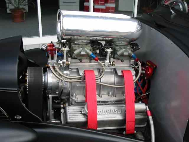

    I hope it will look ok, it won't have the performance to back up the looks initially, but a new blown engine will find it's way in eventually.

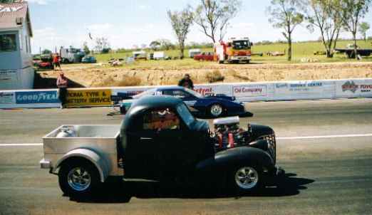

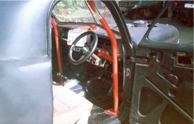

    Found and scanned some photos, when it was a full time racer and as I bought the car.

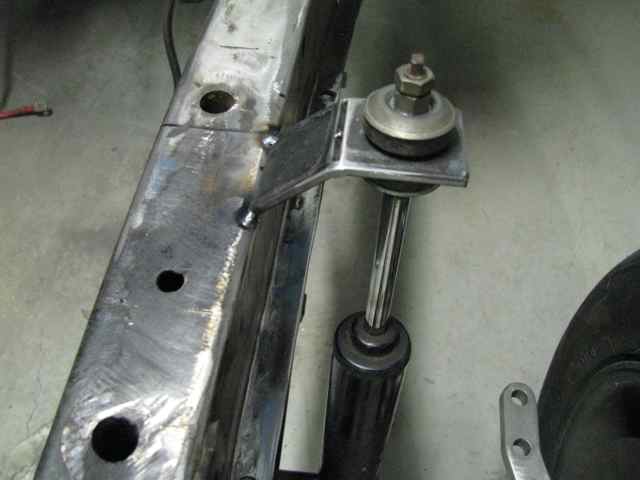

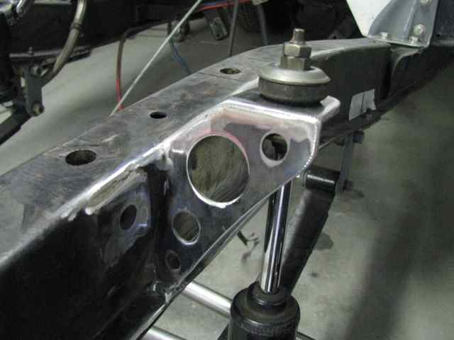

    Front shock mounts, nothing startling here just some plate and some holes. Leaned the top of the shocks back a bit, as the axle moves up it also goes back.
