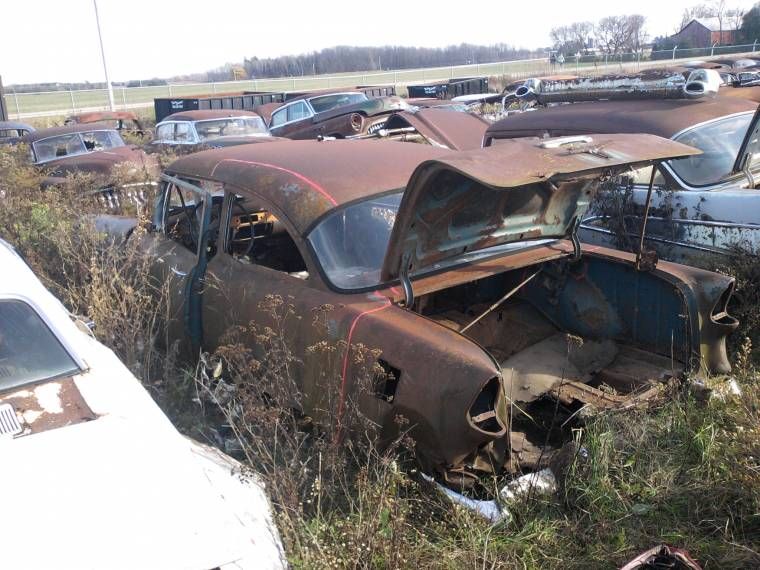

    My dad is usually a muscle car guy, but he wanted to do a "hot rod" for his next build, and he likes '56 Chevys. I had this one at my shop but he didn't want a 4 door, so I sold him on the idea of a 2 door conversion.
    This first pic was taken last Wednesday, first day in the shop.
    I already had doors and a front seat stashed away for a future conversion project, but we still needed door jambs, so I cut them out of this '55 at a local junkyard.
    Before anyone asks me "why didn't you just buy the whole '55 out of the junkyard and build that?" it was wasted. And I mean, really bad. Roof and drip rails rusted all the way through, firewall and floors all gone, doors twisted as you opened them. Even the jamb panels I cut out are going to need a fair amount of rust repair. It was a donor at best.
    I'd say I'm about 60 hours in, here's the driver's side, all put together but not finish welded yet. As you can see, the door is made up of 3 different doors welded together
    (2 four door front doors donated their bottoms). [​IMG]
    And here's the passenger side, which still needs some work to get the gaps right before I weld it tight.

    Here's a pic of the top of the passenger quarter after sandblasting, just to give you an idea of how rusted out the donor car was. The door jamb and quarter sections are the hardest parts to find for a conversion like this.
    I've got lots more pictures of the conversion to post in this thread, mostly of where all the specific cuts get made and what the pieces should look like when they're trimmed and ready to install, should make a handy reference for anyone else wanting to take on one of these conversions.
    I just haven't gotten those pictures resized and hosted yet, I'll post them all when I get a chance.

    I'm figuring about 100 hours including fixing the door bottoms and a little floor pan patching that the car needed anyway. I don't think that's too bad considering the finished product.
    It's turning into some of my best fab work, I really hope my dad keeps this one when it's finished.
    Nope, factory glass with fully functional regulators. The regulators and the inner panel from the donor car are getting transferred over and they'll all work like stock. I'll post pics of that part as well. Did the same with the 2 Mopars I converted and the windows work nice.
