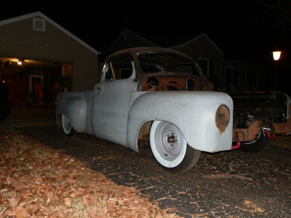

    This build is a full custom 52 stude truck as if done in the late 50's early 60's. Proportions are key, there is such a thing as to much or to far. I am still learning when it comes to sheet metal work, but I feel that I have an eye for recognizing bad work so I will not let anything below par go with the best of my abilities to make it right. The start of this thread is a couple of months behind the start of the build so there are a lot of pics to start. It was a daily driver before I tore into it with a 283 and turbo 350. Started with S-10 front clip(stock springs) and camaro rear end with 6" de-arched leafs as well as 7" z'd frame. The top has 2" cut out of it and a 53 olds dash going in now. The front end hopefully here soon will be getting 2" dropped spindles and block the rear accordingly . The ride height will be a good 3" of clearance. Hope My build gets you pumped for your own project as some others on the Hamb do for me.

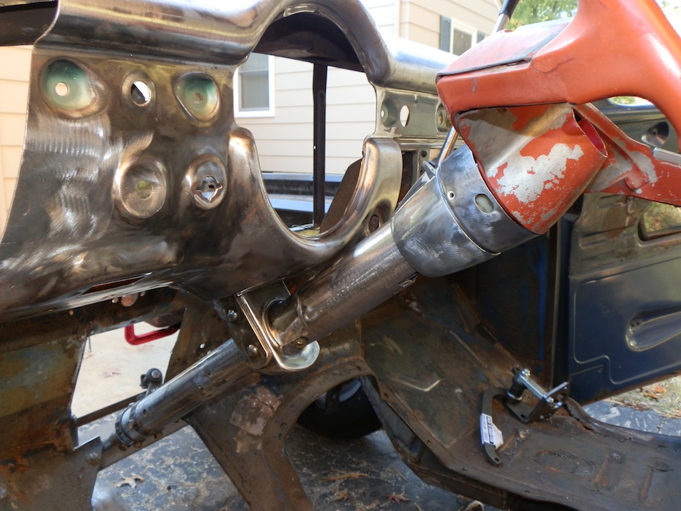

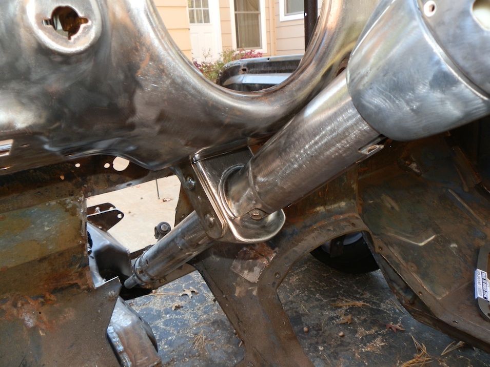

    Dash column drop finally done: 60-66 chevy truck steering column shortened 5" with a 61 impala wheel and a custom mount. Extended column cover to fit flush to mount. A little bit custom and a little industrial.

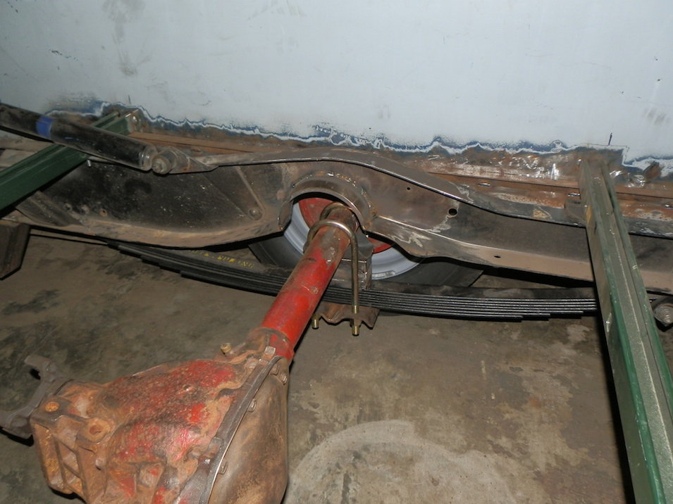

    Put blocks on the rear end and notched the frame, just need to box it up. Once the front springs settle I will drop the rear some more to keep a negative rake.
    I may have to widen the bed a little to get a bit more clearance in those really round fenders. Happy with how it sits now!!
