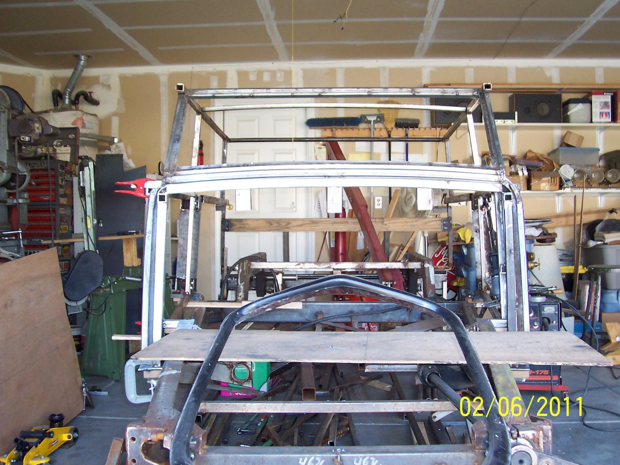

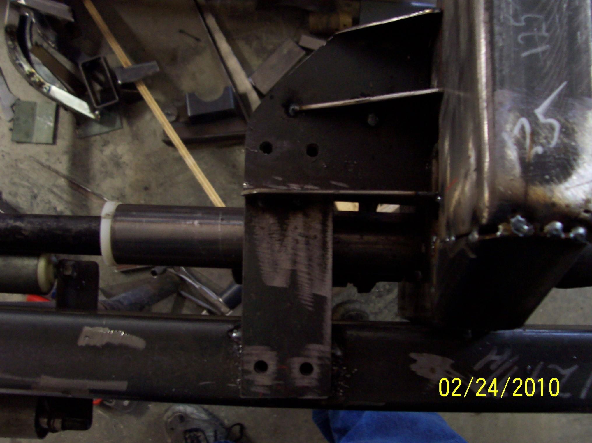

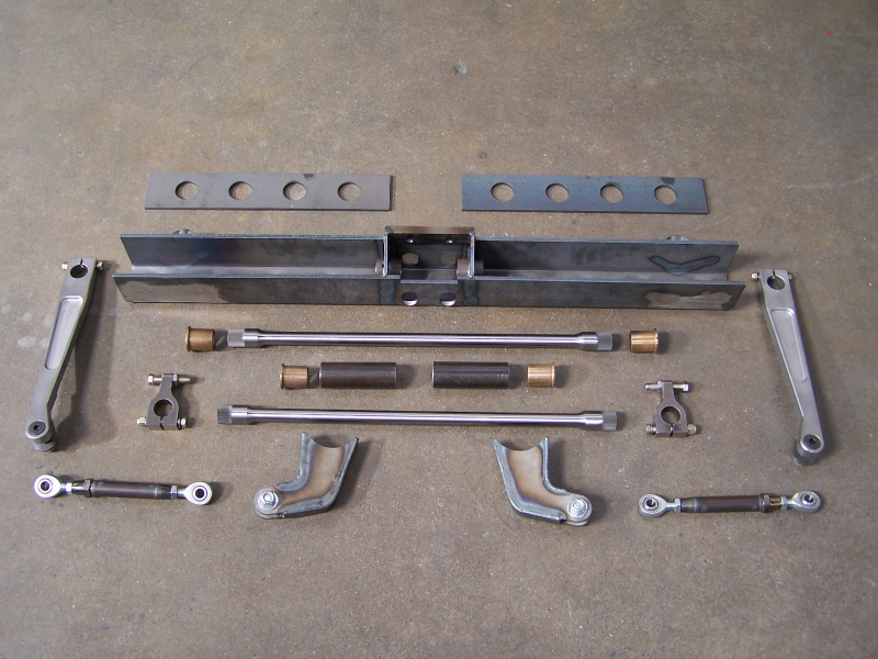

These pictures are not very clear but they show the start of a torsion bar suspension using Toyota and Chevy luv torsion bars. More pictures in my albums. For ease of mounting torsion bar arms, in my opinion the rear bars would be mounted transversely or across the car. The fronts run parallel to the frame.
