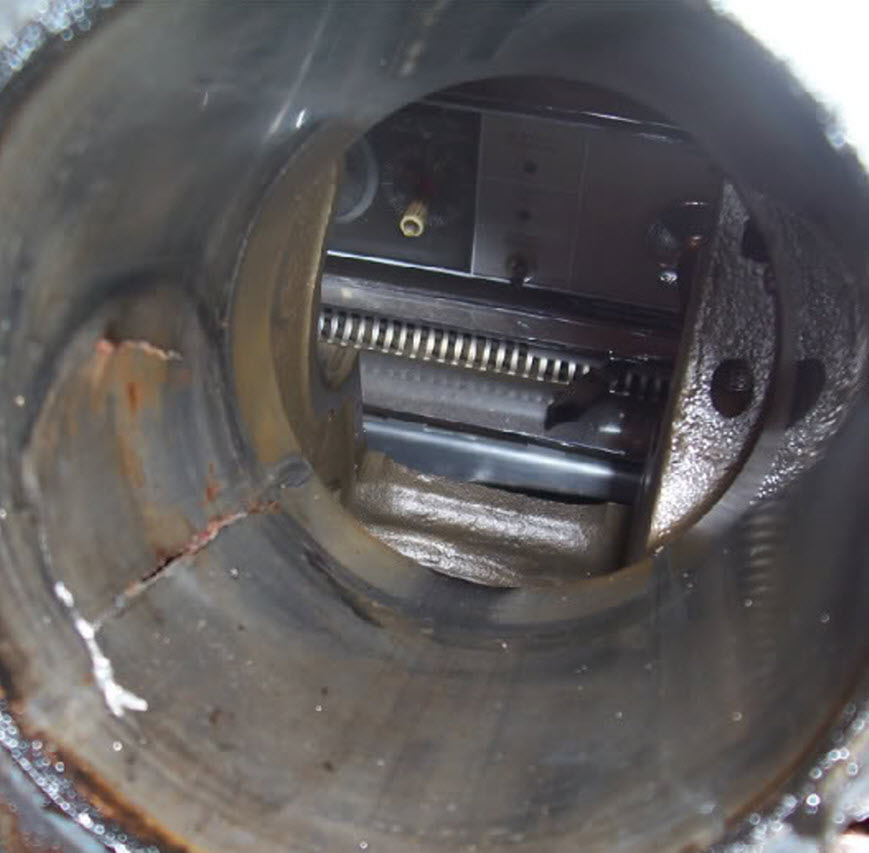

So, here is what we are dealing with:
If the whole cylinder wall has to be machined away, then the only points of rigidity for the sleeve not to move around would be at the deck. As i said earlier, this block would only be used for transportation. Smokey said that wet sleeving a small block chevy is not a good idea but he may have meant for racing.

that cylinder should take a sleeve ok, you still have plenty of support area, and the boring bar will not take this to the water jacket, a good engine machine shop should know this and be able to repair this block, my real question is, you can find these blacks pretty cheap still, I would check craigslist and see if you can just get another block...sleeving isn't real cheap

Get a better block. That one is junk. Save the cost of sleeving and the worry of it springing a leak. I don't know how you could seal a sleeve in that bore. I suppose it might be possible but why chance it?
The only way I would sleeve that block is if it was the original block for a original car. Find a better block, that block took a real hard hit. It may have fractures in places you can not see.

I have installed plenty of sleeves. The block you show in the pic would be very risky to sleeve as the crack is too close to the bottom of the cylinder !!! >>>>.
DOH!!...
Screw it! Get another block!!!!...

The thing is, i have everything except for one rod and piston---from that cylinder which got bent and cracked respectively, and the head(s) may be cracked/warped.
Would that change anything? Because in order to swap everything over to a "new" block all cylinders would have to be re-honed at the very least? Possibly the mains might have to be line-bored?

Default Re: cylinder sleeving
I had I had I did I did !!! Here is the long and the short of this story. You have to leave a step at the bottom of the cylinder for the sleeve to sit on. I can see that the crack is too close to the area where the ledge will be !!! This is a Big Red Flag !!!
And the thing about a wet sleeve !!! You already have a huge chunk that's going to fall out of the block !!! And the machine shop guy won't be happy when the chunk comes out while he's boring the cylinder cause it's most likely going to tear the shit outta his boring bar !!!
Now as much as I know it pains everyone on here to see another smallblock Chevy Die this ones Dead !!!
Oh yeah this is just my opinion but I do this shit for a living >>>>.

Looking at what I can see of the pictures I would say the block is toast. Hit a up a swapmeet or craigslist for another block. If you really have to use your rotating assembly I would definately look at getting the crank checked out. Then you will need to get a rod and piston to match your others, balance the assembly and assemble. um maybe you should just get another running engine.
__________________

He is actually in pretty fair shape of he wants to build an engine, he is short a piston and a rod for his lower end, they can be found.
Small block chevy blocks are a dime a dozen, the down side is that he will probably have to bore whatever he finds, which puts him back in good shape cause now he doesnt have to come up with one piston to match the rest.
granted I am a little off center but I would cabbage myself a rod and a block and go from there.
