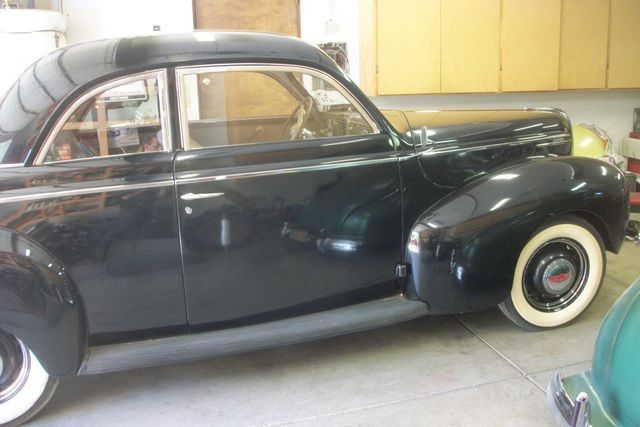

    Here she is in all her stock glory! As you can see it's a really nice car that has been restored sometime in the last 15 years. You know, with a car this nice and original it's sometimes hard to start cutting on it, so I had to think about it for a little while.
    Ok, I thought about it for 2 seconds, now it's time to cut! First thing to go was the fuzzy dice!

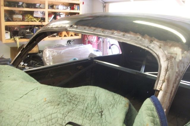

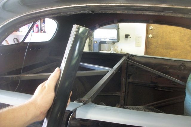

    Next I took my time and carefully took all the upholstery out and wrapped it in plastic so we can reuse it. After everything was out I braced the inside of the car and started cutting. I always like to start with raising the front windshield into the roof to get rid of the big "forehead".
    Next the B pillars came out.
    Then I cut around the back window 3 inches.
    Now the roof can come off!

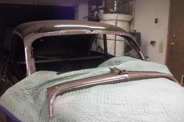

    While the roof was off I went ahead and stripped all the paint off and cleaned out the insulation from the inside.
    Next I made an adjustable jig to hold the back of the roof. This sure made life easier because I really struggled when I chopped the Mexicali Merc roof.
    So after I cut 5 inches out of the front posts I put the roof back on to to see what it would look like. Obviously the back looks funky but right away I could see that 5 inches was the right cut for the front.
    Next I cut the C Pillar roof corners out and started pie slicing the the C pillar. Now I could start messing with the flow of the roof
    After messing with the lines a little and lowering the back of the car, put skirts on it, cad caps and then it was time to roll it outside for a look.
    It's a lot more mild of a chop but it will come down slightly when the A Pillars are leaned back to meet the roof. Also the stainless window trim will make it look an inch lower at least. This to me looks totally pre-war/early post war. I'm diggin it!
