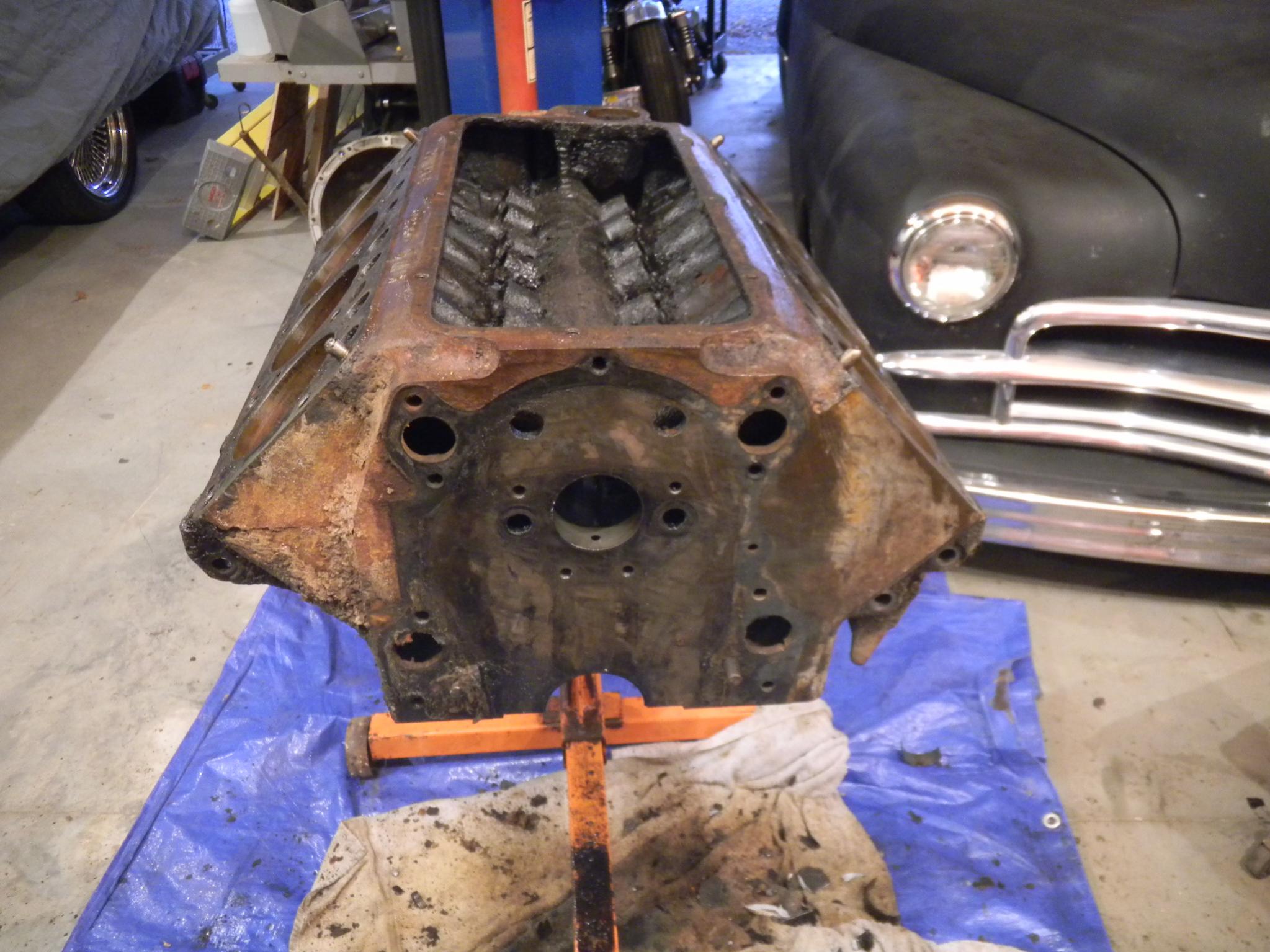

    Well here goes nothing.... i just got a 54 chrysler 331 hemi. The plan is to tear it down, rebuild it close to stock with some minor performance upgrades and to show you guys how i do it. This is my first ever car motor rebuild. I have rebuilt harley motors in the past but never a V8, let alone a hemi. (so with that in mind alot of you know more than i do so bare with me). With alot of help from 73RR, Bass, and some local guys i think i can make it.
    I have been reading alot of Hemi tech and it seem like everyone wants to throw alot of cash and parts at these engines. This is going to be a simple, fairly stock build... I figure going from my stock flat 6 to a stock hemi should be a noticable upgrade without putting a blower on it. I am looking for long term reliability, but will beat on it a little now and then.
    I got it out of the car and on an engine stand last week. I highly recommond a factory service manual for tear down and rebuild. Read through it several times before doing any work.
    Started tearing into the motor tonight. From the looks and smells this motor has been sitting for long time. Still full of antifreeze and oil, but boy does it stink.
    She is rusty, crusty and stuck but doesnt look as bad as i thought it might.
    Thats about as far as im going for today. Just taking it apart for now. I really haven't inspected much. Need to get my work area cleaned up and finish tear down. Hope to ge the block to a shop near by this weekend to get cleaned up and checked out.

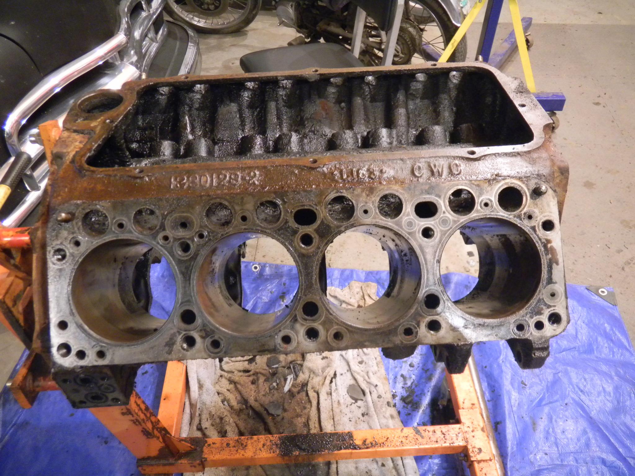

    UPDATE- Hey i did have to use the claw hammer on the teardown. Got the timing set off, cam out, oil pump off, and still stuck.
    So was down to just the cranck and pistons and still stuck. Time to take the rod caps off and get out the hammer. Flipped it over and with a long rod and hammer i started tapping the insides of the pistons. 5 came loose without too much, but the number 1, 7, 8 took a little more "effort" So got all the pistons and rods out. Some of my pistons now have holes in them but wasnt planning on using them anyway. Rods all look good. Cam looks burnt and some of the lifters have alot of wear. Probably not the best way to remove pistons but no damage was done to the rods or the block so i considered it good.
    Thanks

    Everything looks good. I think its an original motor never been touched. Has round 90k miles on it. Plan is to reuse/rebuild bout everything but pistons, cam, and pushrods. Gonna post pics soon.
    Hope to get the block to the machine shop and get it checked for cracks then start ordering parts.
