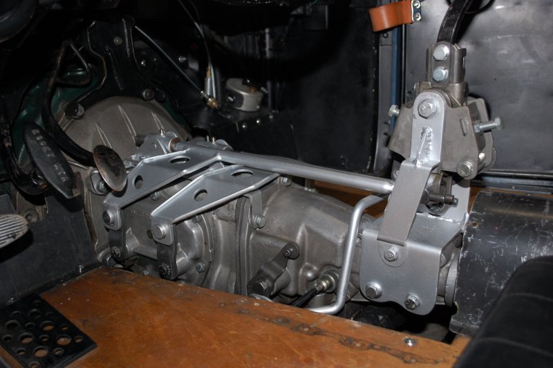

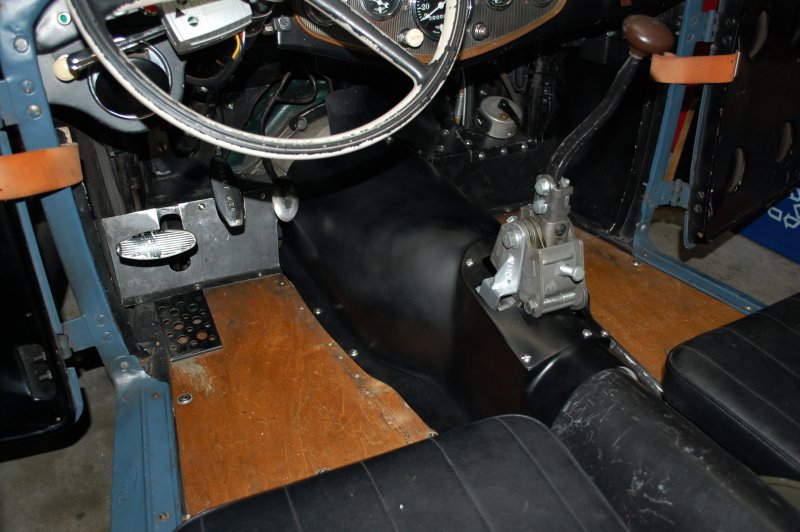

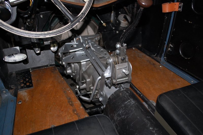

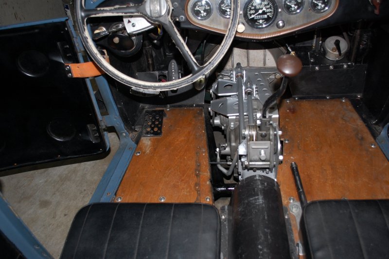

Although I could not find the Speco Thomas center shifter I succeeded in fabricating a center shifter for the Muncie tranny in my garage at last.
It didn't work at the beginning though I found a small photo of a center shifter for Saginaw in web and copied it quite thoroughly.
I guess the Saginaw's shifter didn't function well probably.
However, the linkage tops has been improved to a accurate pendulum type by advice of my friend's race mechanic.
Because the shifter with which it interfered on the back side of my thigh moved, my Hot Rod became comfortable.
Above all, it is quick like a race car, and rather it's working more smoother than an OEM shifter.
And it was also difficult to me to build the tunnel with the metal work because I was amateur fabricator.

That shifter looks fantastic. I have never seen anything like that before that fit a Muncie. Trans cover also looks nice.

A lot of thought and fab work went into that. I'm really impressed with the quality of the work. I can see that the shaft and bearing system you designed would make for a smooth shift without any flex. Great work!
