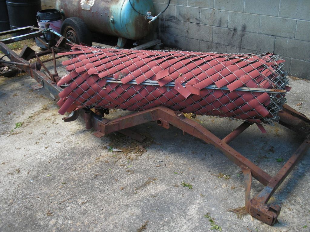

    The chassis it's been out in the weather for years. This is going to be cleaned and put back just like it was. The axle is original willys with henry j brakes and about 5 degree castor blocks. Note the barn door hinge welded on the front that was for the tilt front end that was added in the later 60s it will be left that way.[​IMG][​IMG]

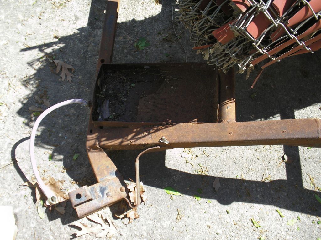

    The ladder bar brackets and drive shaft loop. The reason for the bracket welded on the back of the original is at some point Gene said that the rule changed on wheel base for A/Gas so he just moved the rear end back 2 inches.[​IMG][​IMG]

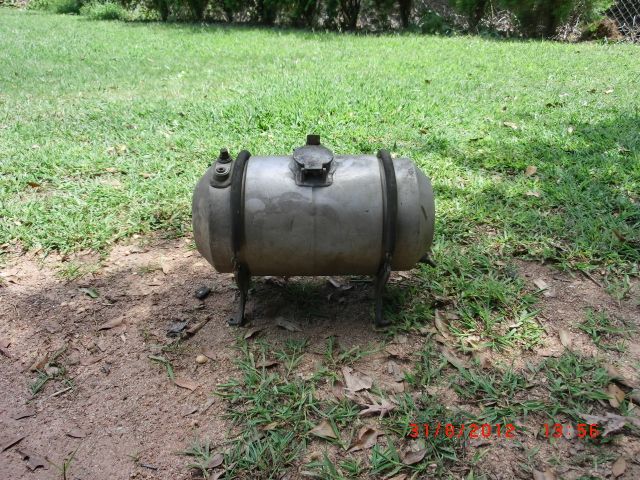

    The moon tank that was in the car from the start.[​IMG][​IMG]

    Another shot of the tank[​IMG][​IMG]

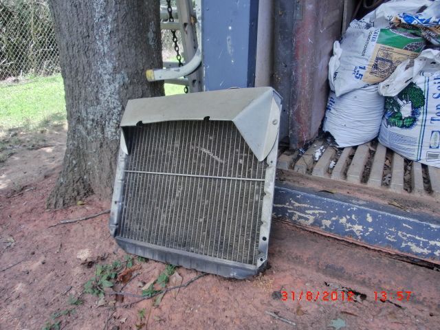

    Ok here's something I'm going to have to eat a little crow about I didn't know that there were any aluminum radiators in the early 60s and there were not many. Cromer said this one was from a AFX car from around 1964. I bet there are not many of these left and it's in good shape.[​IMG][/IMG]
