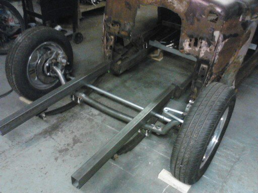

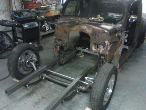

    Well my son bailed on this build so i bought it from him and started tarring it down , i'm gonna put a sbc in it and a gasser tube dropped axle in the front with parallel leafs.
    Heres some pix

    Looks good so far.. Cool body style...

    too bad your son bailed on it....woulda been a good project to learn on.
    what is the gas filler neck from ?

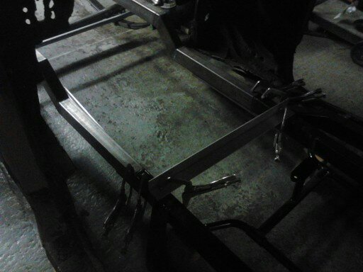

    Did a little more work on the chassis , i Z'ed the front frame and tacked the spring perch mounts still lots more welding and fabbing i will post pix as i go.
    I have a sbc motor for now but in the future i would love to put a blown 392 hemi .
    The is going to be a hot rod i'm not building it as a legal gasser more of a street machine to play with .
    Thanks for all the info and comments good or bad lol its all good.
    Anyway heres some pix enjoy , i'm loving the looks of this beast.

    Man, you have got that sitting exactly where it needs to ride, love the stance, wait until those fenders go back on at that hieght, your boy will wish he never pulled out of the deal.

    Today i squared up the frame and welded the new front section to the rear frame then i set the wheelbase and made some plates to hold the leafs in place , tomorrow i will weld the front leaf hangers into place and mount the body at the front (firewall) then i can roll it out side and get a good look at it.
    Here's some pix of todays work
