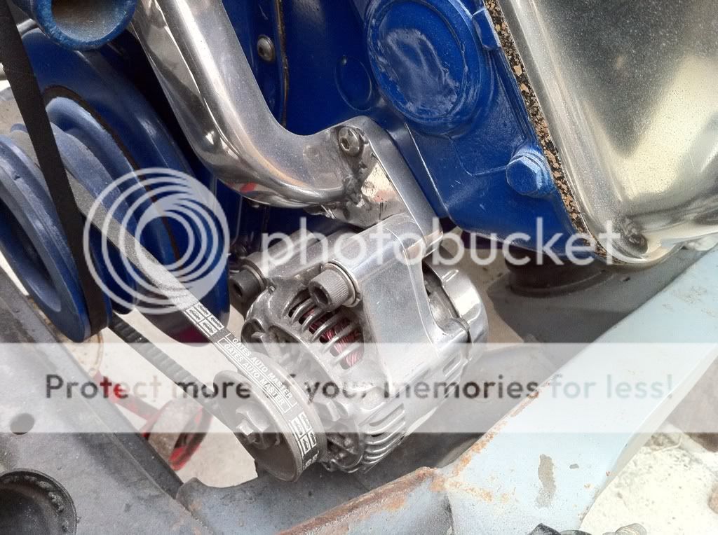

I used a Denso unit from a small toyota (with a small mod to the mounting boss)
http://i816.photobucket.com/albums/z...d/f42a7348.jpg

Old 08-03-2012, 05:25 PM   #25
gonmad
gonmad's Avatar
Join Date: May 2007
Location: S.W. Missouri
Posts: 820
Default
Thanks guys, I can't run a Powergen because they don't make one with the PS shaft coming out the back. I do like the idea of running an alternator off that, but then I'd loose the power steering, which I don't want to do. I really like the look of the stock setup, so that's why I'd like to hide one under it all and just "unhook" the wires from the stocker.
Click image for larger version
__________________
Jimmy
58 Nomad - 348 Baby Rat
69 Camaro - twin turbo'd
www.fquick.com/shmoov69
online   Reply With Quote

Default Re: Small bodied alternator
Quote:
Originally Posted by d2_willys View Post
Get a smallish alternator and replace generator with one from a 55-59 Chevy that has the Power steering pump drive from rear of generator. Make a simple coupling (they sell those springy thingy couplings that make it flexible), then mount alternator using power steering bolt holes on generator. Saves you a belt too.
I'd like to see some pic's of that setup.

Quote:
You could put a newer power steering pump (1960 up) at the front of the engine. That would allow the alternator on the back of the generator. But I do understand the "keeping it stock" idea. Good luck, I would go with Nippon Denso alternators, pretty small in size and can be tucked into some crevice where it is hard to see.
__________________
Dual range hydros rule!
Wise man say to 53 Olds with Dynaflow owner: SHIFT TO LO & GO!
offline   Reply With Quote
