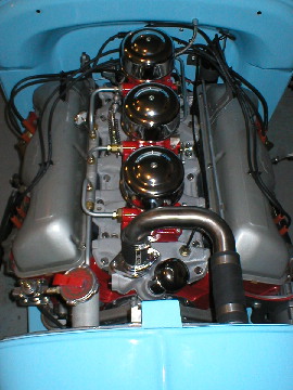

I am trying to figure out how I want to run the fuel lines on my tri-power setup on my sbc in the lander. I want to run some red fuel line off of the firewall to the carbs, but how do you run the fuel line from the pump without making it look all hokey?
Do you just run an electric pump and bring the line straight up the firewall?
.....Or do you run a line across the top of the motor from the mechanical pump to the firewall and then back to the carbs?
Show me what you got, playas!

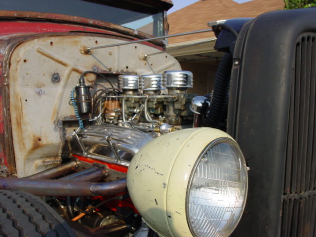

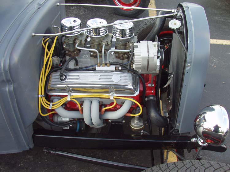

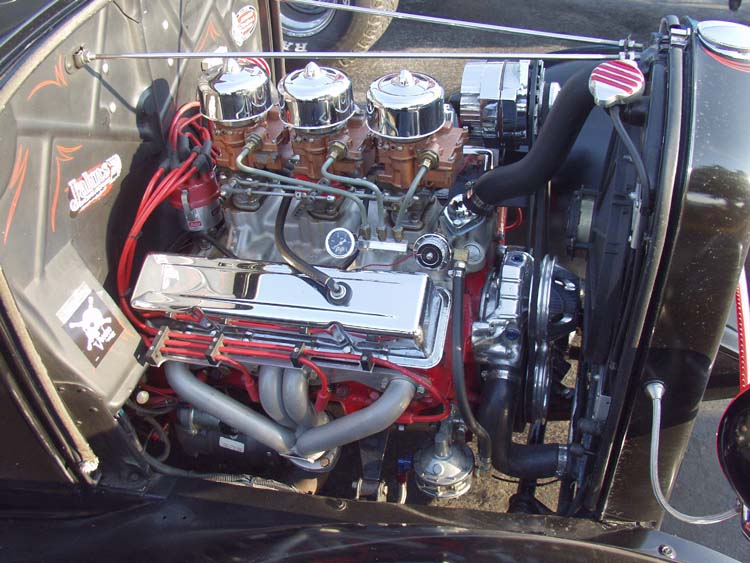

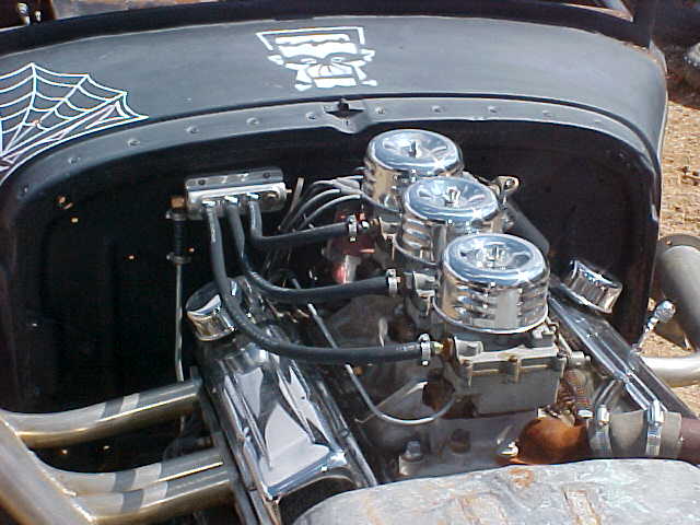

I have been watching the same thing for quite awhile - in fact I posted a similar questions. I swiped some pics from many HAMB'rs that I will post...hope I do not steal anyone's thunder here...
Click image for larger version
Name:	40 ford firewall B&W sml[1].jpg
ID:	121359   Click image for larger version
ID:	121360   Click image for larger version
ID:	121362   Click image for larger version
ID:	121363   Click image for larger version

It seems to me that everyone has run hard lines to a fuel log. That is what I have on the spacetruck, but I wouldn't mind trying to run some clear red lines though.

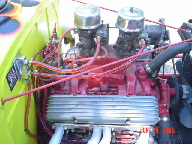

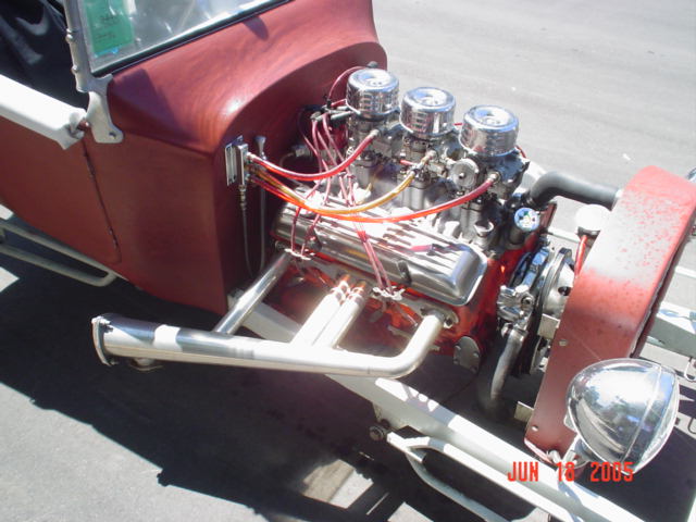

I can not find the one I was thinking of with red fuel line but here is a couple of more...
the 2x2 just 'cause it looks cool
ID:	121403   Click image for larger version
ID:	121404   Click image for larger version

Red fuel lines are probably to blame for chemically dissolving from the gas and burning more cars to the ground than everything else combined.
If you want them for looks, for show only, don't run any gas thru them, as in show-car non-op.
If you want them for the color, why not slide the red plastic hose over a polished hard line?
looks cool, no Landers spaceship fireballs.
A car caught on fire on the first Ranch Run.
It had the red plastic fuel lines, they dissolved and pumped gas onto the hot exhaust. A local with a fire extinguisher who happened to be right there where it happened saved the car.
It's got "ugly" black hose on it now.
SCTA rules won't/wouldn't(?) let you run more than a foot of hose in the entire fuel system, for good reason.
__________________
Not my fault, I was at camp.
offline   Reply With Quote
