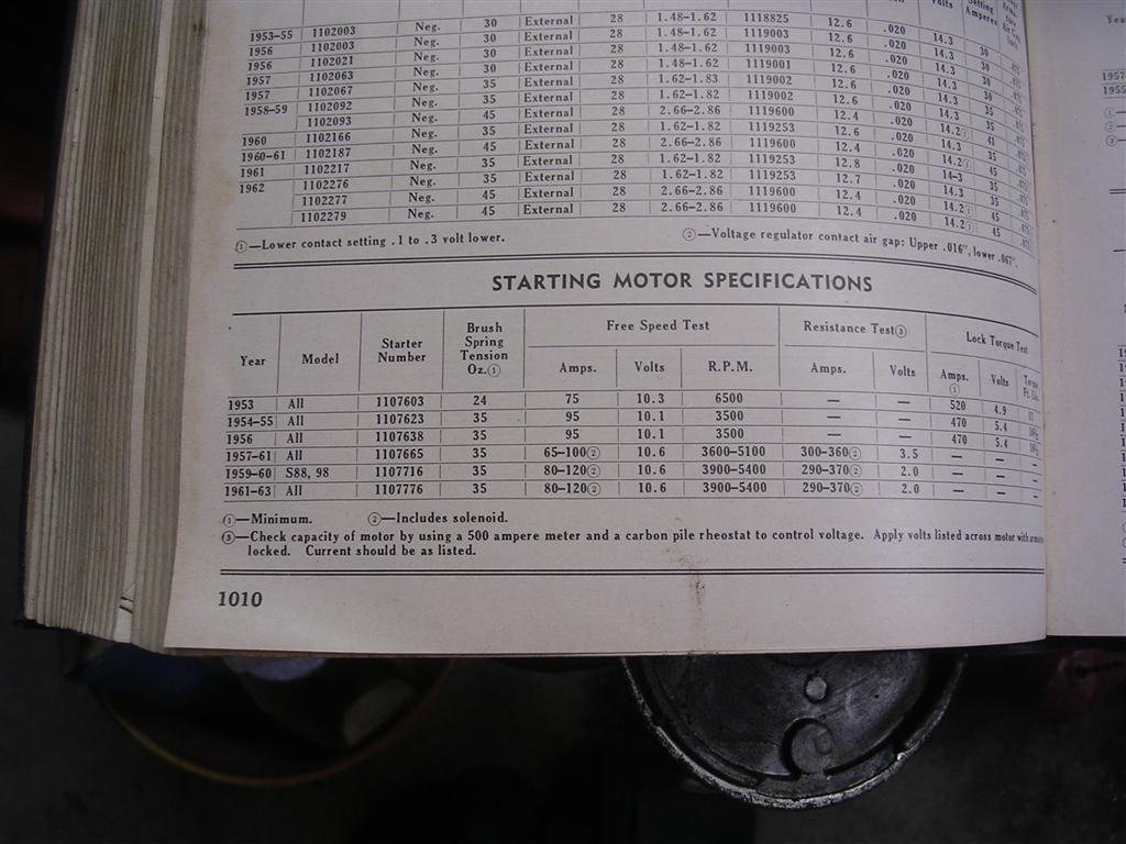

  13. F&J
    Joined: Apr 5, 2007
    Posts: 13,222
    F&J
    Well, it's misleading, because right after it says 49-55 are equal, on next paragraph, there are specs on "intake port sizes", which shows there is a difference in 49-55 if a person understood that the manifold sizes would be changed as well. A new guy might buy a 49-53 303 small port/small runner intake, to use on a very souped up 324, which really should have the 54-up big ports and larger runners.
    Other very minor things:
    -head cast number #3 is missing, it would be a 1953
    - starter voltage; 53 is actually a 12v, and is the only 12v starter for the smaller flywheel ring gears.
    -"1949-1964: Manual Transmission available" should read: 1950, not 49 on V8's. Also, 1950 should be mentioned as a one year only transmission similar to the Cadillac. One year only bell, too.
    Good job on putting this together, ... a lot of the post 56 info, I had not seen before, and I am still reading it all :) thanks!
    kidcampbell71 likes this.

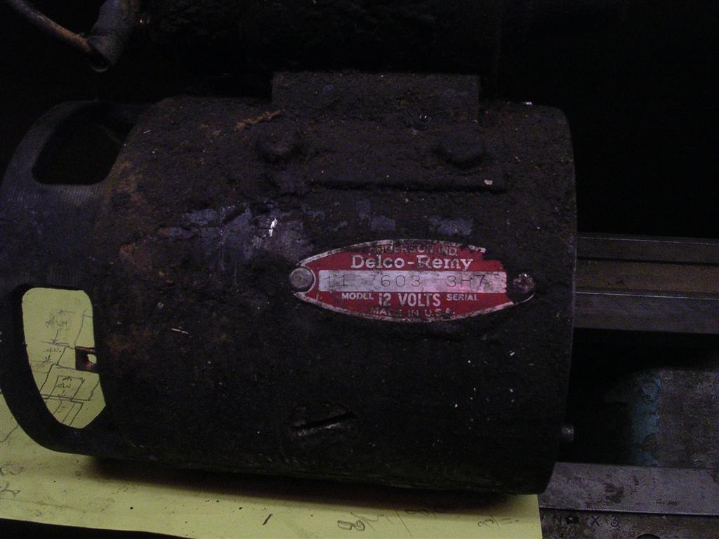

  16. F&J
    Joined: Apr 5, 2007
    Posts: 13,222
    F&J
    No, 1953 was 12v, and I never knew that until I bought one last year. Here is the chart showing the 53 part number, and a pic of the 53 starter, same number, and a 12 volt tag.
