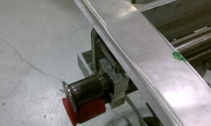

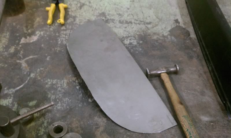

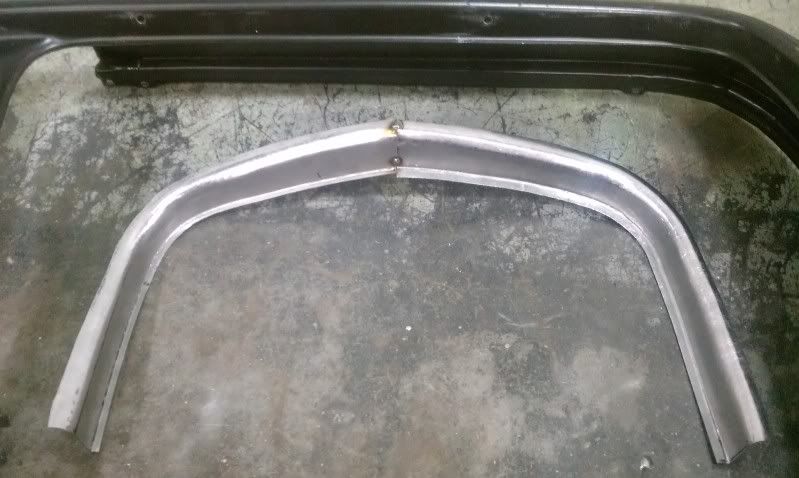

After much hemming and hawing over where to begin, I started with the inside upper corners, first bending them in the brake to form the lip that the insert will sit against, then using the hand shrinker to make the curve.

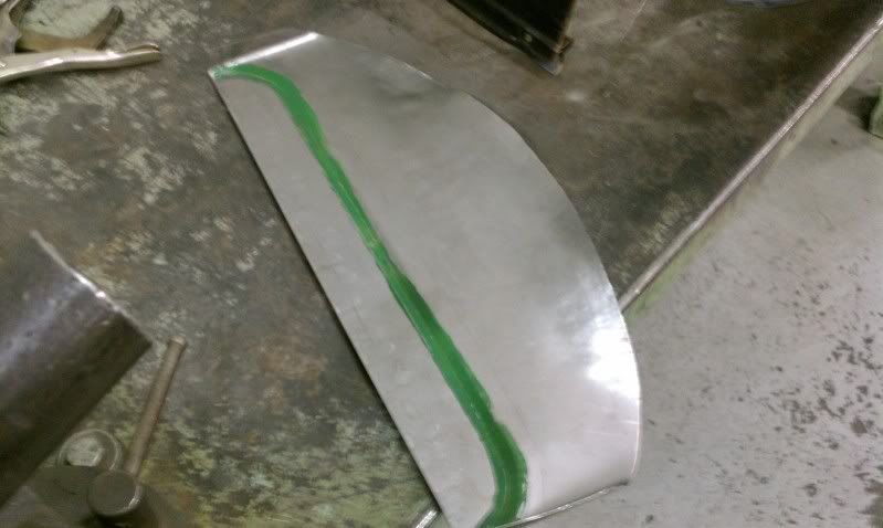

Once that was close, I started forming the reverse curve, first using a hammer and a stake in the bench vise, then moving on the the planishing hammer with a lateral stretching die in the bottom and a slightly crowned die in the top. (I guess I didn't get any pictures of that part, I was having too much fun playing with the loud tool.)
At that point it was close enough to move on to the next piece, trimming and final fitting would come later. It may not look like much at this point, but I was pretty darn thrilled to have the first little piece done.
The mirror-image piece on the other side was formed in the same way, then the two were trimmed and tacked together.
Now may be a good time to mention that it wasn't quite as easy as these pictures may lead you to believe. I'm not good enough at this yet to always hit it on the first try. Here are a few failed attempts on their way to the scrap heap...

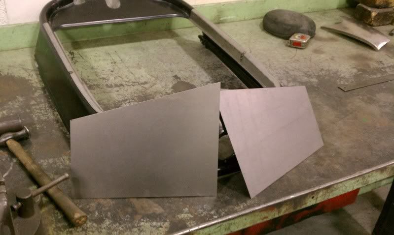

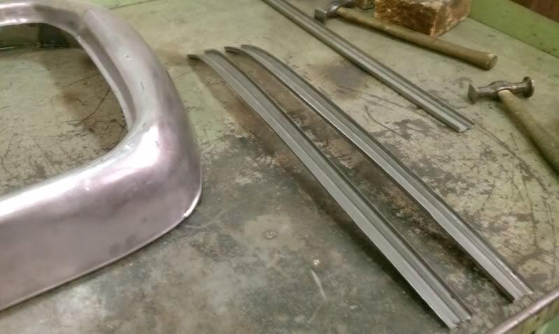

The inner-side pieces were much easier to make, requiring that the metal only bend, not stretch or shrink. A hammer and stake made quick work of these, then they were trimmed and tacked.

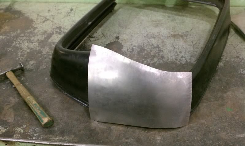

I moved on to the outer-sides next. These took some tinkering before I figured out the right sequence to make them. I ended up shrinking the upper corners, then smoothing the tool marks in the english wheel.
Once the shape was close, I scribed the contour of the trailing edge of the shell. There is a ridge around the back where it meets the hood/sides, and this was formed by following the scribe line in the bead roller. This bead became a fold line where the back edge was hammered over, then additional tweaking was done by putting this edge in the hand shrinker.
At this point it was pretty close...
With one side done, the other went much more smoothly.

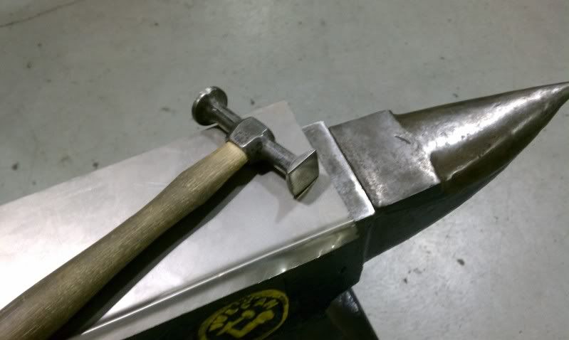

With the sides completed, I started working on the lower inside corners. These were a bit trickier than the upper corners, and after the usual trial and error, I figured out that the flange could not be made in the brake, but rather needed to be curved. The bead roller was once again put to work, followed once again by the hand shrinker. I don’t know how I’ve lived without one of these…they’re useful for almost any sheet metal project.)
The curve was once again formed with the planishing hammer, then tweaked with a hammer and stake until it the fit was right.

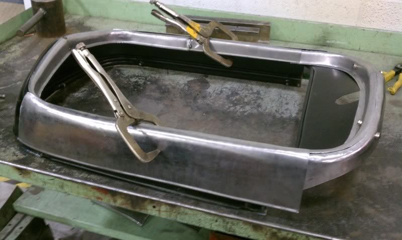

Once the other side was made, I couldn’t resist clamping everything together to see how it looked.

I had to stop and clamp it all together again, just to take a look. Everything still needed to be trimmed and fit together, but I couldn’t resist having a look at all that shiny metal that was starting to resemble a deuce shell.
(I spent way more time walking around my workbench looking at it like this than I should have.)

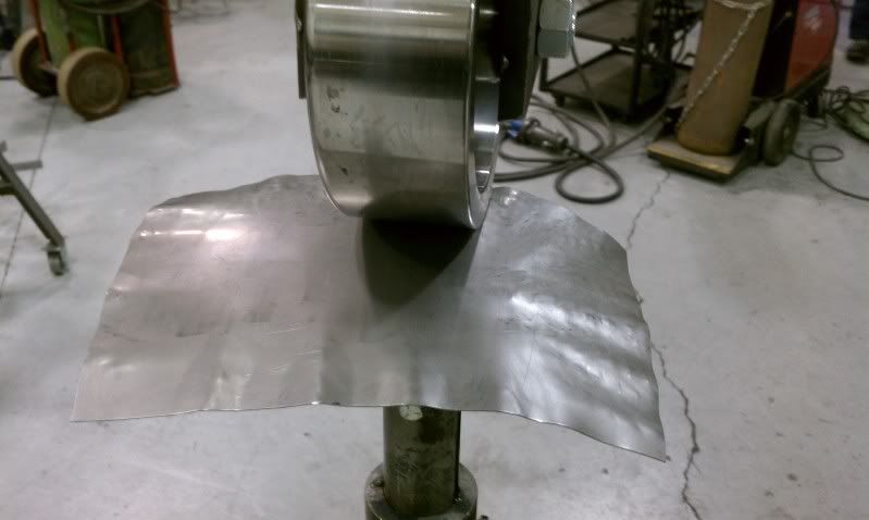

On to the inner pan behind the shell. If you’ve ever looked at one of these, you know that this is kind of an odd shape. It needs to stretch in the middle, but shrink at the corners. I tried a few things (which I won’t go into here, it wasn’t pretty) before settling on the planishing hammer to raise the center.
There is also a bead at the top of this piece, which was “traced” from the original shell, then run through the bead roller using the dies pictured. With a little tweaking on the pressure, these dies made the perfect “step” to match the original.
Pictured here is the contact patch of the lateral stretching die in the planishing hammer that was used to form the “eyebrow” in the center.

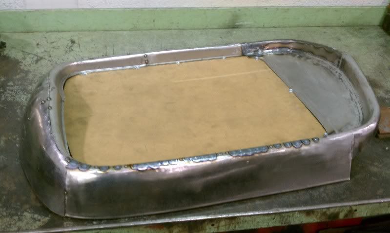

With the bottom tacked in place…
…it was time to TIG weld. The wood is there to serve as a jig to keep the whole works from turning into a pretzel while welding.
The next step was to finish all the welds. I used a 5” grinder with 36 grit Rolocs to knock down the high spots. To keep from over-grinding the rest was done with a file, 80 grit paper on a block, and finally with 150 on a DA sander. The high and low spots were worked out with a hammer and dolly.
