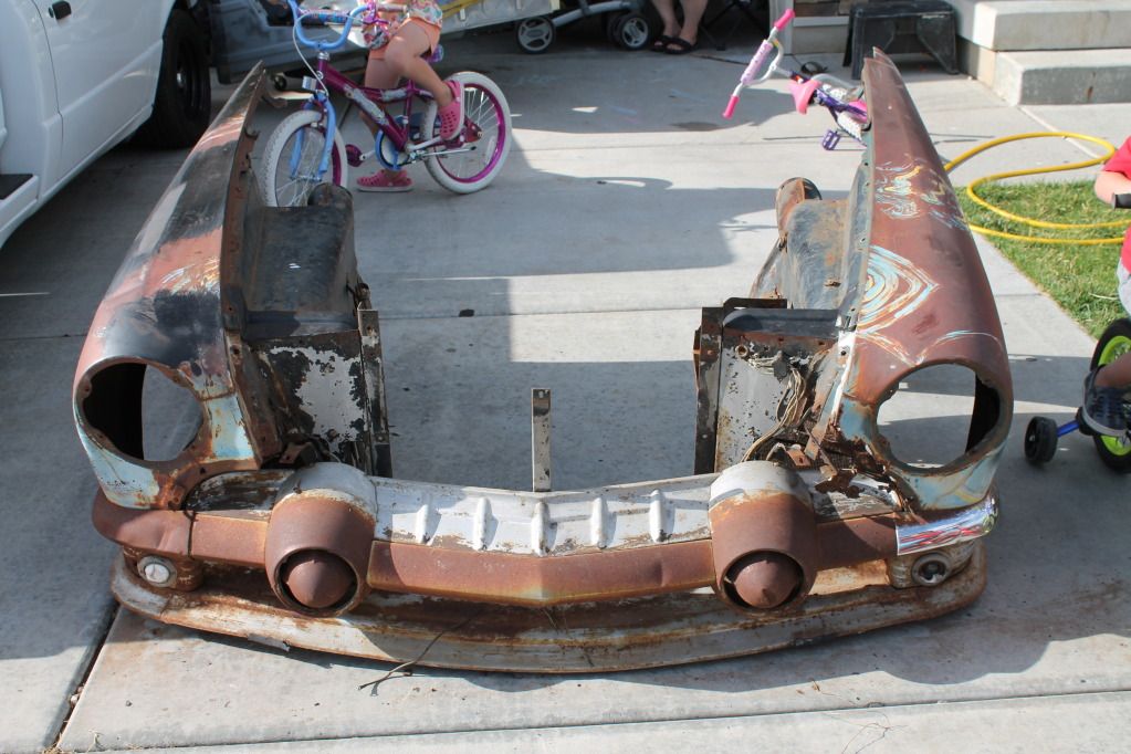

Can a front nose clip on a 1951 Ford shoebox fit on to a 1949?? Im getting a 49 for a parts car but the body looks to be in way better shape than my 51. But I like the 51 front clip more than the 49.. Thanks

I got the front clip off the 51. What a pain in the rear.. The hardest part was finding the bolts in the undercoating. Now its time to pull the drivetrain.

so where is the pics?
we are a bunch of picture whores
