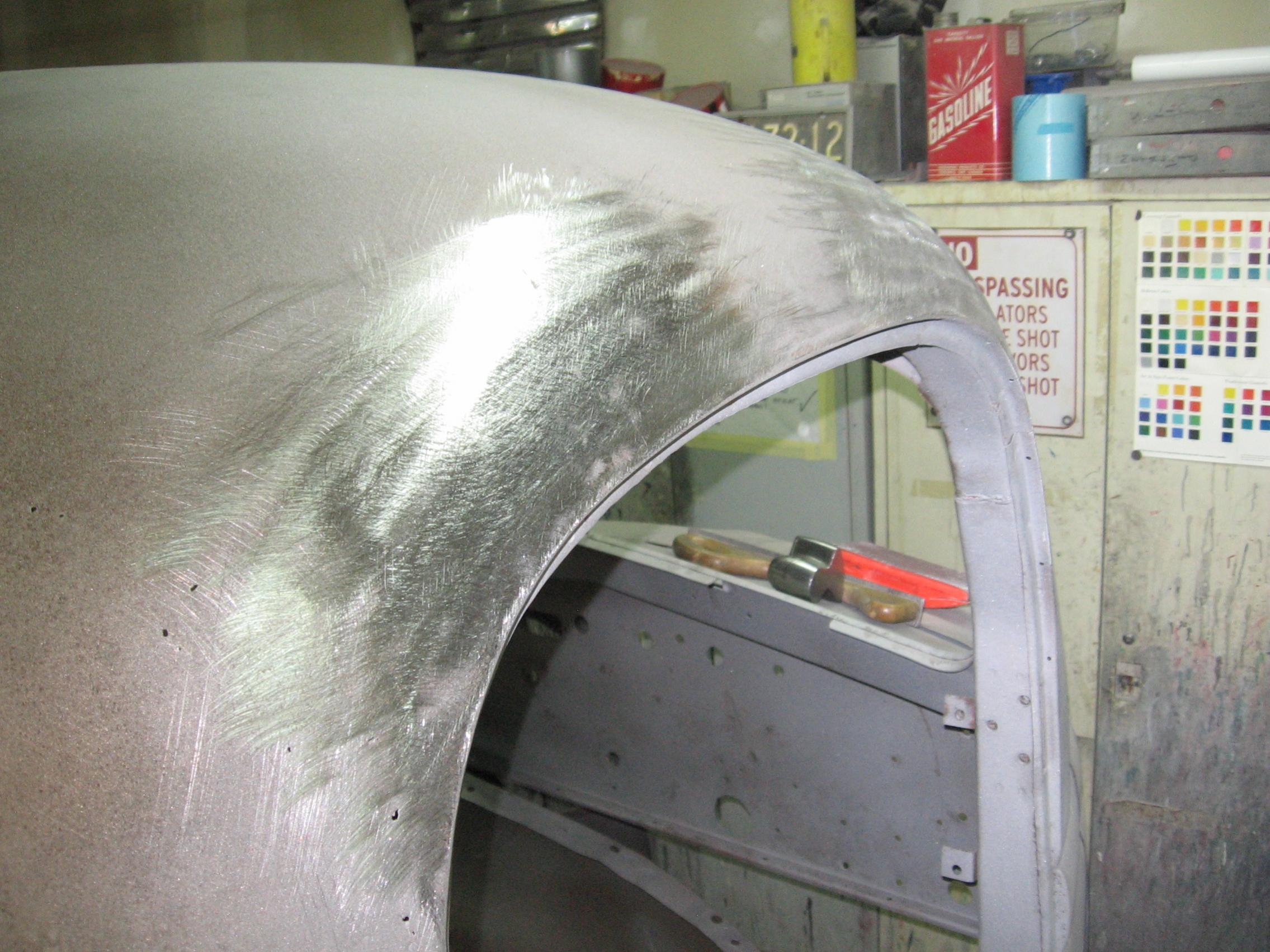

I've been beating it with hammers and dollies,
There are a few dents I will document with photos and post them up
Kind of a long, not exciting part of the project.
But it is forward progress.

I am deep in the metalwork phase of the project.
Not very exciting.
The back of the cab and roof are the worst, but it's all repairable.

I believe I am within acceptable limits and all the steering parts will be new.
The brakes are all 3/4 ton Chevy disc/drum and will all be new components as well.
I am deep in the metalwork on the cab, but I will post up a few updates with pictures of certain dents and repairs.
Yup, I think it will be a fine looking truck when it is all done!
