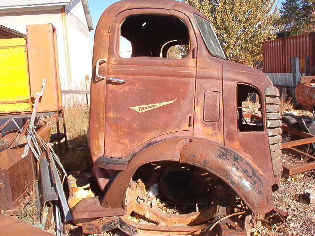

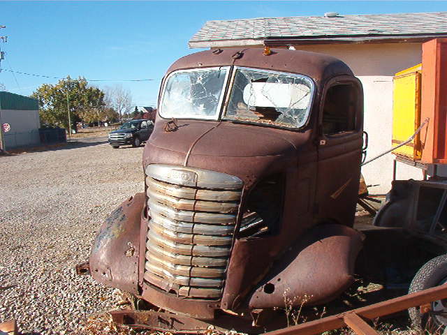

I bought this cab off our local online classified site just about 4 years ago.
I fell asleep in front of the computer while looking for an ot 69 Chevy truck. When I woke up, I wiggled the mouse and this picture was on the screen. I went to bed and when I woke up, the first thing I thought was, did I dream that ?
I checked and sure enough,the ad was there.
I sent the guy an email and he called me back within an hour.
It was located a little ways out of town and there was no way I could get there till that night. I told him,consider it sold, but I know how it goes, if someone is there before me with money...
He said I better look at it before I commit and he would hold it till i've seen it.
That night my daughter and I drove down and once I saw how complete the cab was, I couldn't get the money out of my pocket fast enough.
Then I said, now I have to figure out how to get it home.
The fellow said he was hauling stuff into town the next day and he would put it on the trailer and bring it in.
24 hours later it was sitting in my garage!
I really feel this was one of those things that was just meant to happen for me.

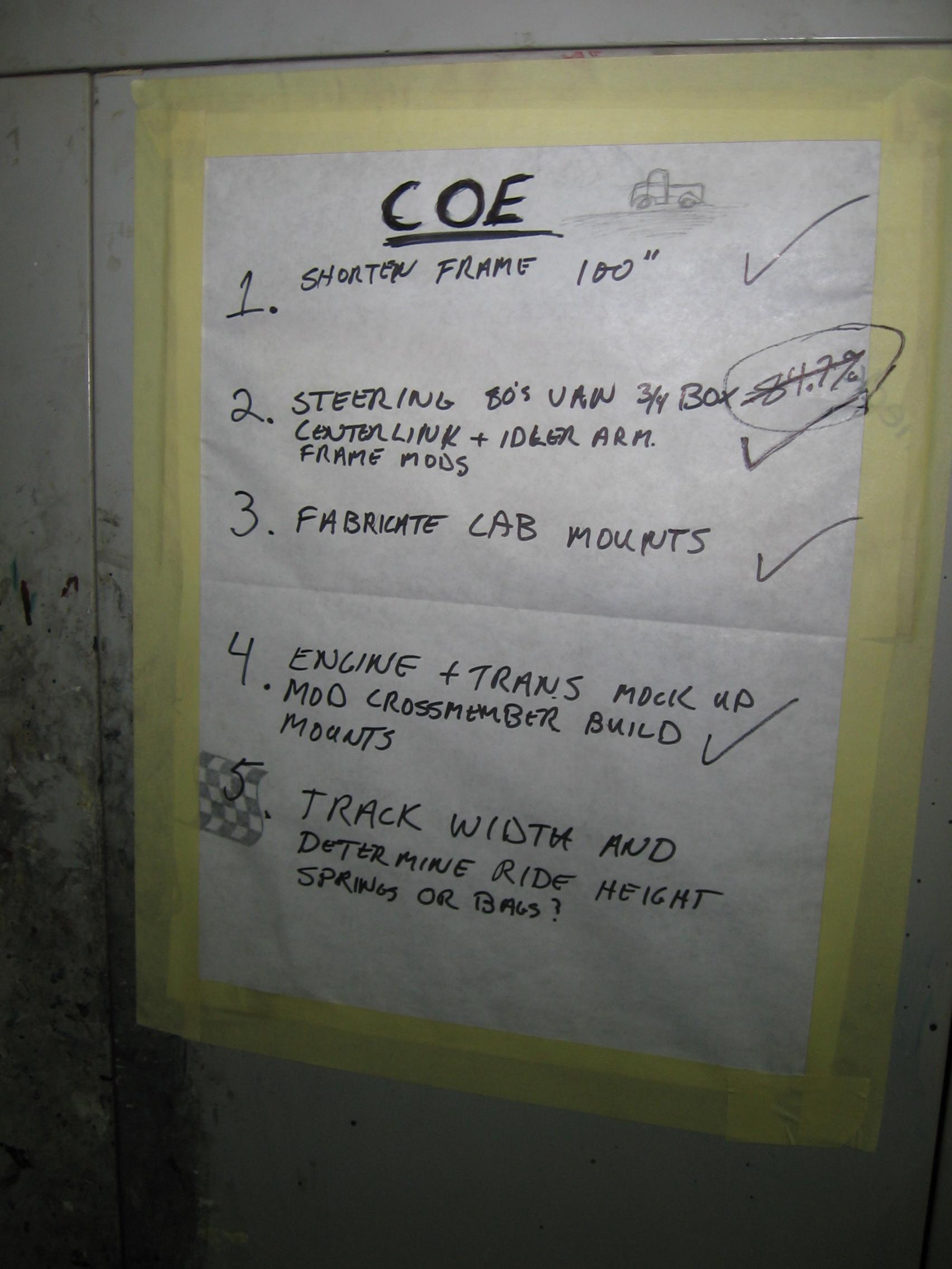

I had set the cab onto the frame and put the truck in my yard,I needed the space.
In January I decided I need to get on it and had a plan to get my list of 5 done.
A friend of mine kept telling me I need to have a build book, so one day I drew this pic and said,Here, this is all I need.
The first thing I did was to refine and finish my front cab mounts, then build my rear cab mount,Check!

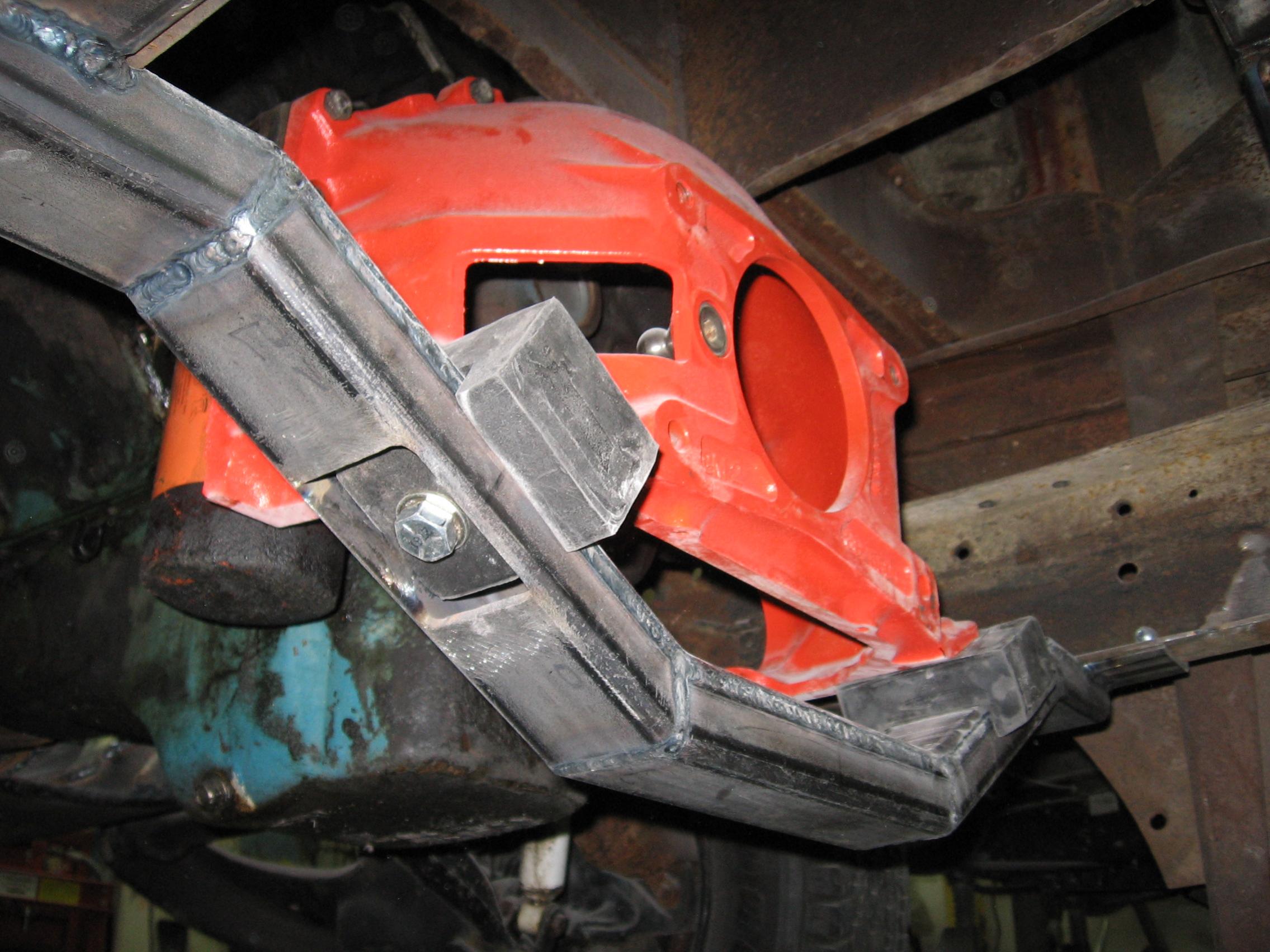

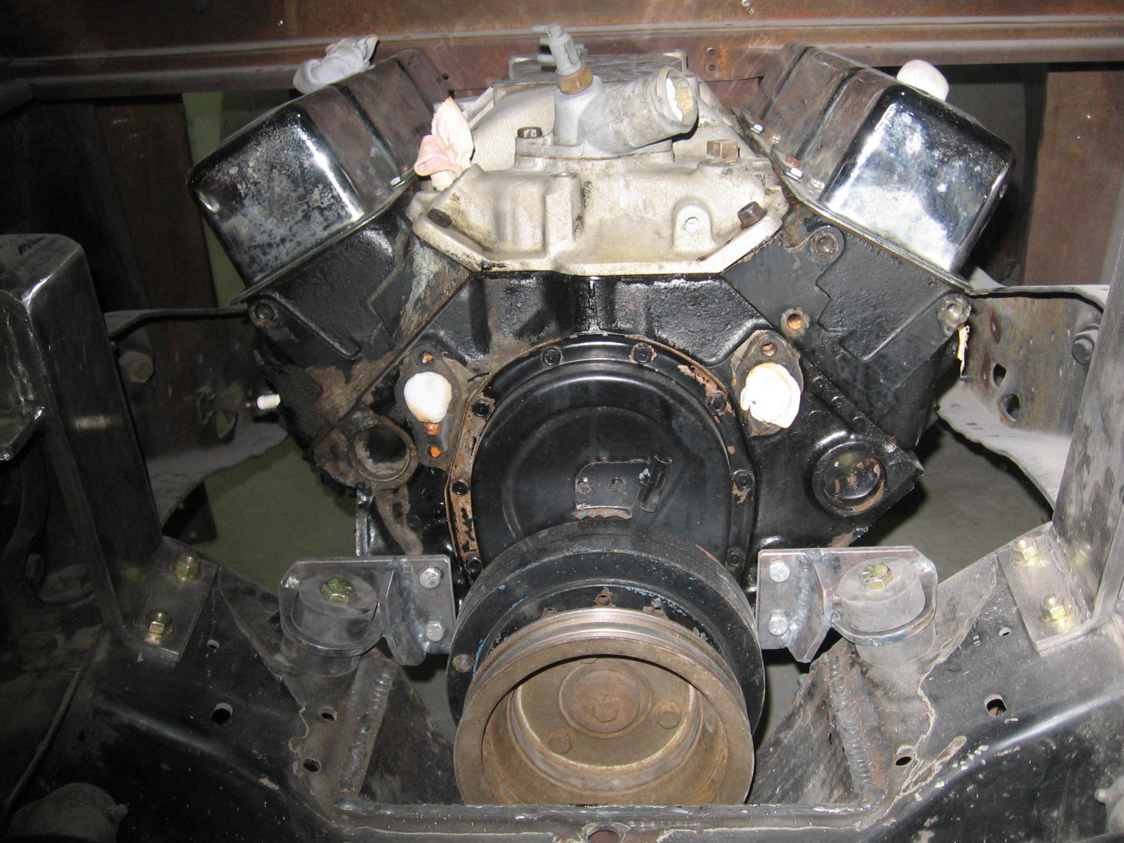

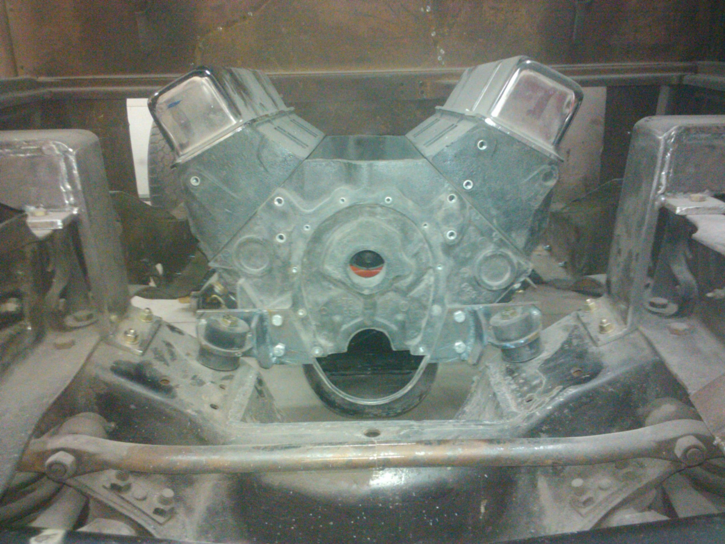

I borrowed a plastic mock up engine and started making the mods to keep it under the floorboards and still have lots of foot room.
I moved the engine back and down, this involved cutting and shelling the crossmember so the harmonic and crank pulleys could sit there.
I did a lot of measuring,and then I bent up a piece of 1/4" plate to be the shell and cut a piece for the front wall of the recess.
I have enough room to put a fanbelt down in front of the pulley,perfect!
I pondered the engine mounting for sometime,and went with the 55-57 style front mounts. Thanks Cactus for sending me a pic of yours.
The pads sit very nicely on top of the crossmember and holes from original mounts were in the perfect spot.
I built the mounts out of 1/4" plate. My trans plans changed, I don't really like the thought of wires coming out of a trans, so i figured I would complicate things further and run a T5. I used a '69 truck bellhousing and built my rear mount from 3/16 x2 1/2 x2 1/2 square tubing,heavily modified.
I will change the tailshaft to a s10 so the shifter is forward, but it will still be an engineering /fabricating marvel to make the shifter linkage. i'm up for it.

Do you have enough room for exhaust manifolds with the engine moved down?
Thanks for the pics, my engine will be mounted similar.....someday.

The last on my list of 5 was the track width and ride height.
My goal is to have this be under 7',so it will be able to go into a regular garage door.
My garage has an 8' door,so it's not really an issue here,but 7' was my target.
I put the real engine in place to get the weight and found it only dropped about an inch. I pulled the coils out of the front and not wanting to take out and reinstall them twice I decided to whack one and a half coils off.
When I dropped the jack,it was one of those moments that make you smile.
I hung the fenders on and stood back and looked.
The track width was increased by using 2" spacers.
I found them online,but called a local 4x4 place and they had some coming in.
1 week later I was holding them.
I installed them and now had that issue fixed.
I realize now that I should have gone with just 1 coil, the truck sits nice, but the steering is limited by the tires hitting the body.
I will put another set in with just 1 cut off and play with tire size.
Originally I was going to run the Duramax wheels seen in earlier pics,
I really like the looks of them,they are all inset so I was planning on having them modified to fit the need.
The black off road type wheels that were on the frame are the right offset for what I want, so they will be my blueprint.
I am now planning on going with stock type 8 bolt steel wheels ,painted to match,with some type of cap. I think it will give me more the vintage 40's look I want to achieve.

So with my list of 5 completed,it is time to tape a new piece of masking paper up and get out the Sharpie and make the next one.
The cab will be going on a dolly this weekend,then off to sandblasting and the metalwork will begin.
The frame will live in my yard for a couple months as I really need the room in the shop. I will keep updating as progress happens.
I am glad I stuck to my guns about getting the first list done,despite it taking a lot of real estate in my shop.
I feel the project has really come a long ways.
RMR&C ,There looks to be enough room for exhaust, I have a set of headers coming this weekend,and will post a pic with them installed. Worst case, I may have to run stock manifolds.
Thanks for checking it out!
