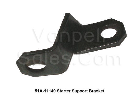

Here's the bracket from Mac VanPelts catalogue. http://www.vanpeltsales.com/FH_web/i...prices-pg3.htm
