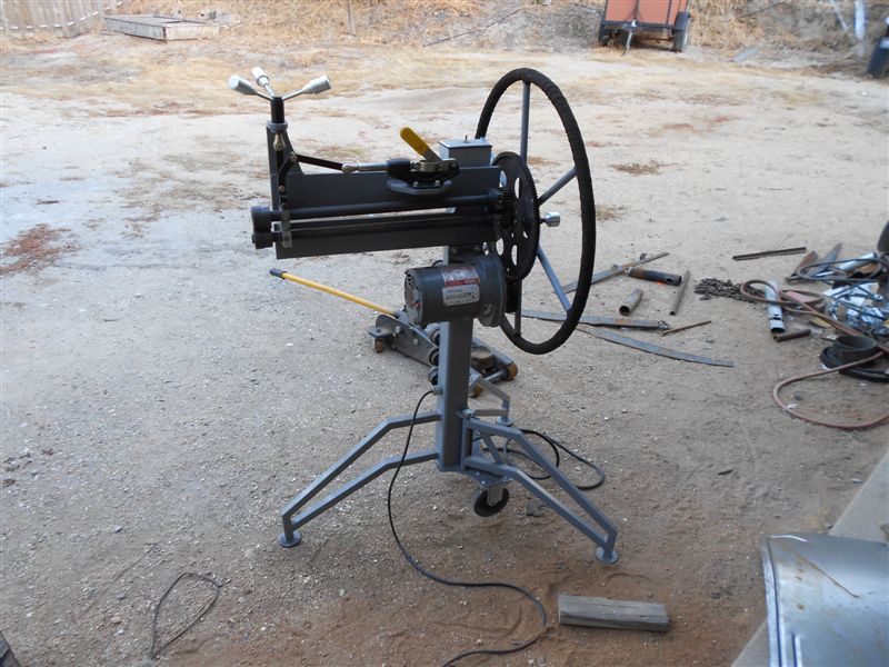

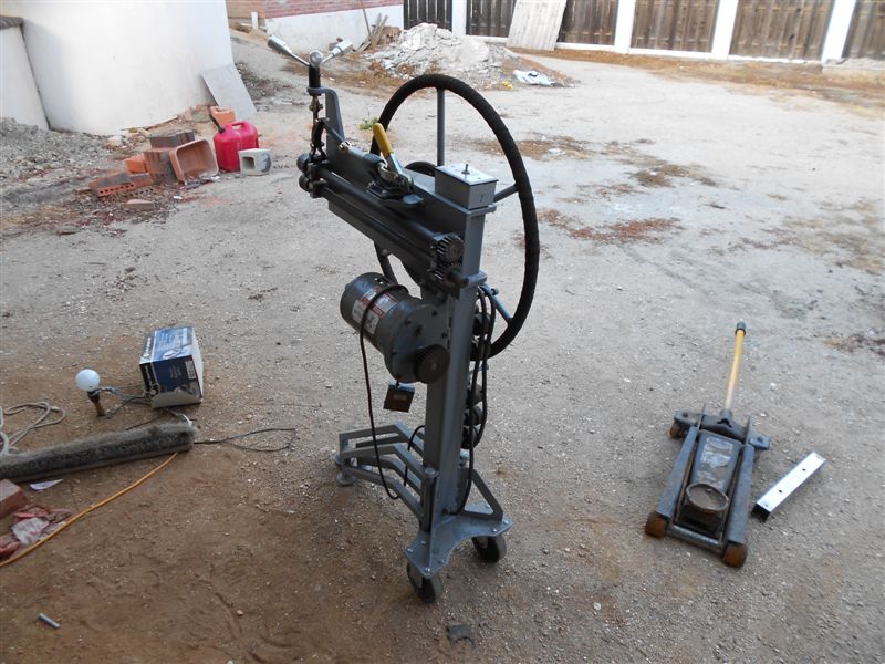

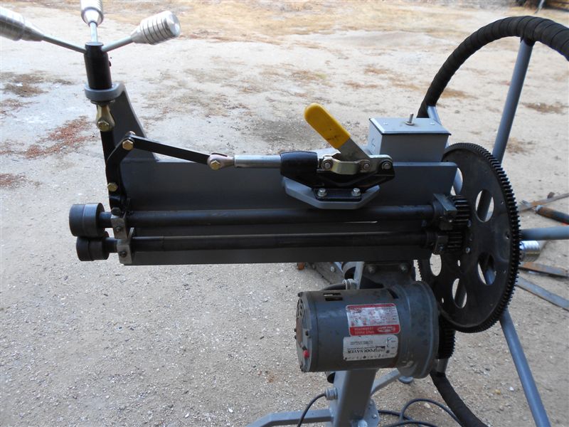

Here are a few pics of the one I modified, For the price I think they are a good deal. I found a gear reduction motor for $20 at the recycle center that got the whole project started. Handwheel was built out of 1/2 emt wrapped around a tire about 30" diameter, good leverage and easier to reach on larger panels. Legs fold in and wheel stores on the side so it takes up less room when not in use. The quick release is the best mod of all it allows the same preasure each time and its quick. as stated by others the set screws are junk, I welded the lower shaft blocks to the frame to eliminate any movement. The end play on the shafts will give you an uneven profie to your beads, after I got everything set where I wanted it I drilled and threaded additional set screws that are threaded through the collars and gears all the way into the shafts. The motor is geared for a shaft speed of about 8 rpm. seems to be slow enough for good control yet the longer runs go fast enough to not get bored. I had most of the parts in the scrap pile, but if I was paying myself for my time it probably woud be cheaper to buy a Mittler Bros or Bailigh.

Three Widow's Garage, nice work. I bought Woodward Fab and have used it on light stuff only so far. It work's good for that. I like the way you braced it.

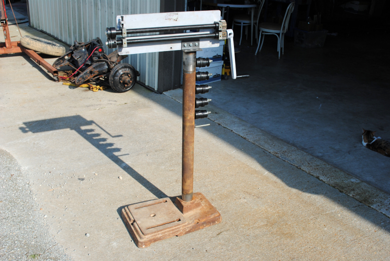

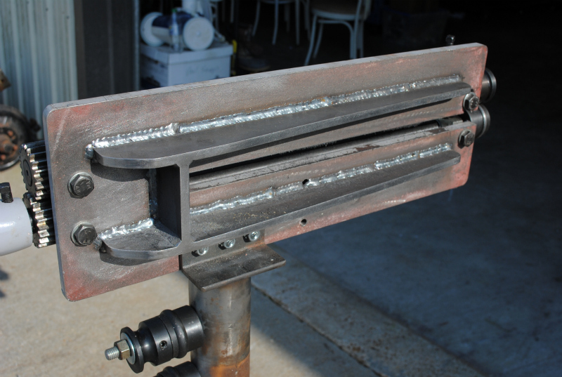

I also have the Woodward Fab bead roller. I braced it up and replaced the adjusting screw with a new block and a 3/8" fine thread bolt. About six months ago I bought a stainless steel boat steering wheel from a fellow HAMBer. I took the drive shaft to the local technical training school where a machine shop student cut a taper and key way to fit. He also drilled and tapped for a retaining washer and bolt. At some point I am going to paint it with my signature red.

My wife bought me the woodward fab unit too. Times were tight, but she wanted to get me something for Christmas, and she had heard me talking pipe dreams to a friend.
There was another guy on here, that added some 3/8 or 1/2 steel, much like the pictures above, he said it sturdied it right up...
