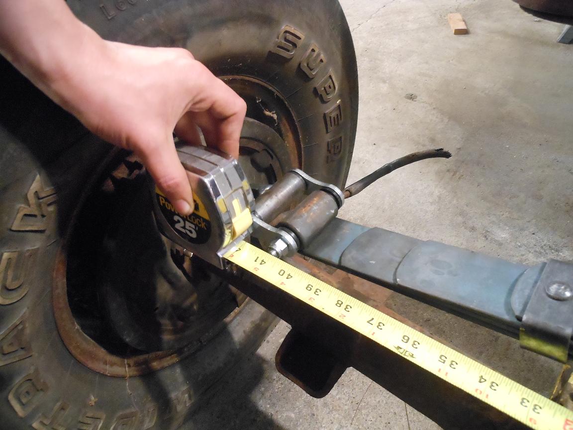

    I am installing one of those springs in my T-bucket,and in the questions and answers part of the description they recomend 45" for a model A roadster. That spring is going to have to be disassembled,spread and installed one leaf at a time. I worked in a spring shop for many years, I have a factory made spreader,but I could not spread the spring that much.(safely).The reverse eyes make it even more interesting.

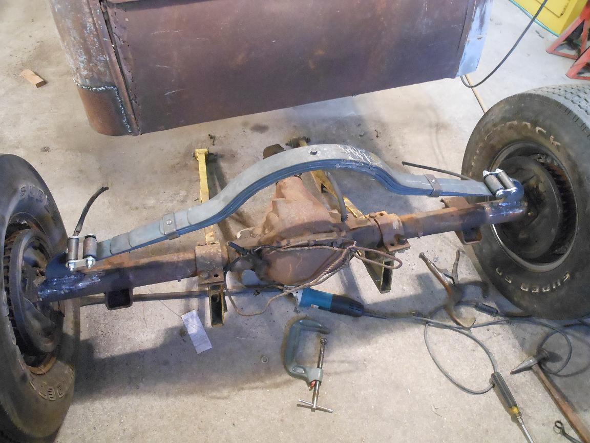

    Also here is a picture of the new spring along side the old one that had me so confused (that I got for free from a fellow who thought it came out of a Model A) Geesh, must have been a cement truck ?? :eek::rolleyes::(
    Thanks much, and in the next few days I will try to figure out how to safely stretch this one....

    There are certainly differing opinions on the proper spacing of the hangers,I have mine clamped and jigged right now at 42".I did a google search and found one "opinion" that verified my calculations for the 38"spring. I am going to weld mine in tomorrow,I will keep you posted as to how it works out. My 9" bronco rear end is only 50 1/4 between the backing plates,so the previously stated 49 1/4 measurment would be pretty tight.

    I have my perches tacked (heavily) in place, and after some phone conversations tonight, I plan on taking the spring apart tomorrow and spreading the bottom leaf to fasten to the perches, then add the other four leaves back on...

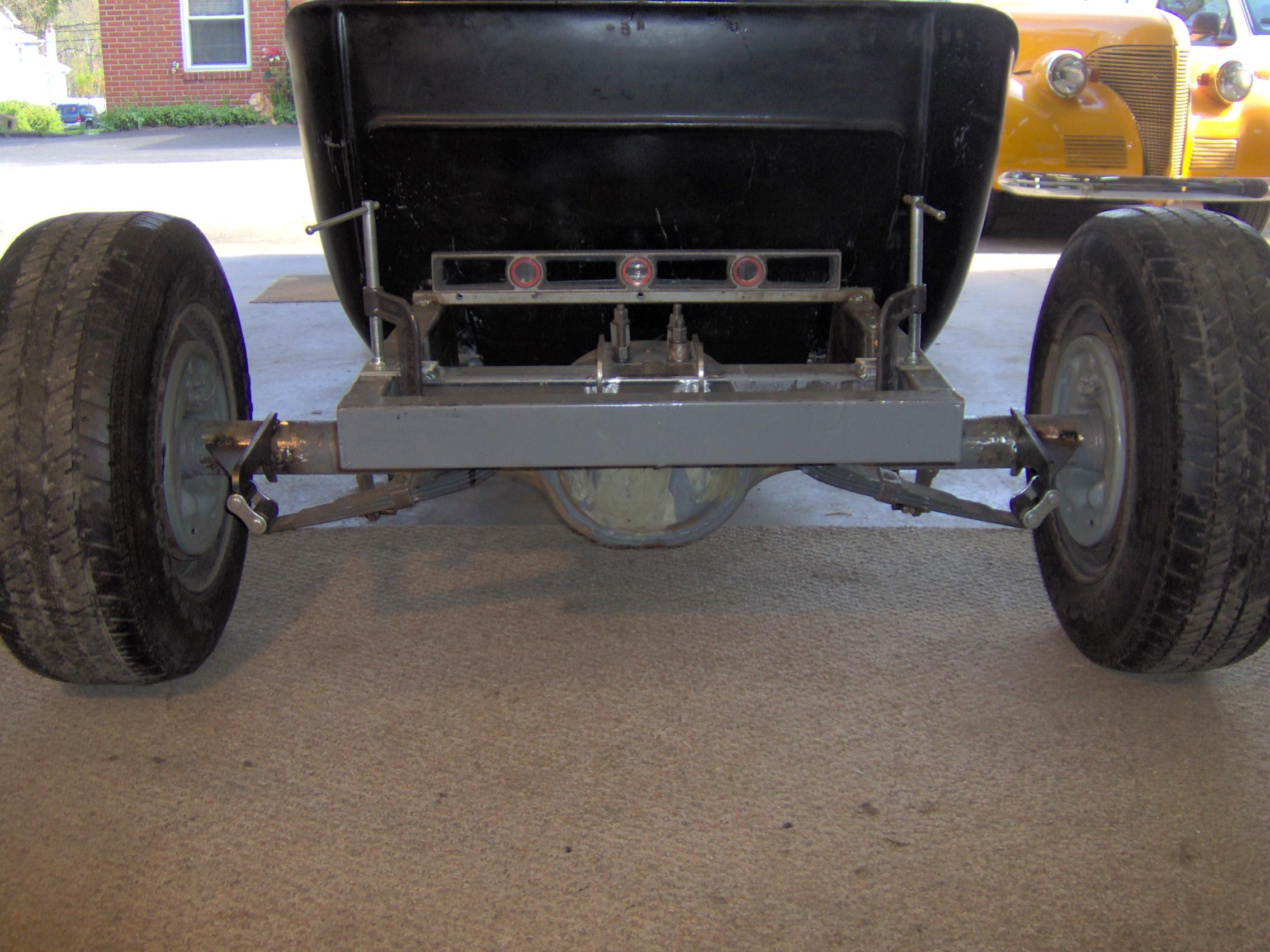

    i put the speedway spring on the back of my roadster.as stated on other posts you will need to disassemble it to mount it.you will also have to make spacers for your crossmember because an "A" spring is 1/4" wider than a "T" spring.on mine i ran the model a top leaf and made a bottom spacer from a model a spring then used canvas to shim it in the crossmember.it lowered the car alot and it looks okay.

    the proper distance for the spring hangers(mounts)for this spring is 43" center of the shackle eye to eye.this will put your spring at the proper shackle angle when under a load.the spring will be hard to mount but the tension will be correct.also remember to set the hangers to the proper angle to the pinion as not to cause binding in the suspention.this would be 0 deg on a banjo or 3 to 5 on an open drive.here's a pic of mine.
