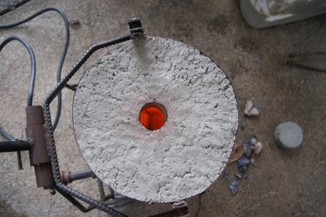

    so my club member and I losthope picked up a used furnace on craigslist a few months a go.

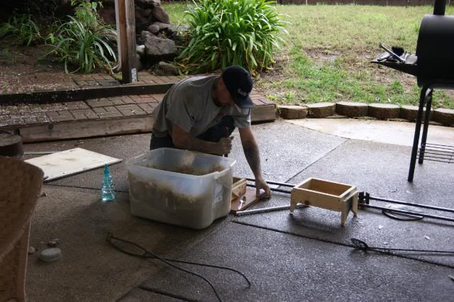

    he is the resident wood worker in the club.so he built the boxes.
    in that pick you can get a pretty good idea of how he did them.
    as i fired up the furnace to melt the aluminum he started the first box.
  2. [​IMG]
    the first pour we poured directly into the plaque. it didn't really work out as seen here.
    I think the aluminum blows out the sand if it hits the mold directly.
    the next pour we decided to only use part of the box. while this might work.It did not for us.
    as seen here.
  3. so then we decided to do it the way loudpedal does. and cut a vent and a fill hole with channels to direct it the plaque. as seen here.
    and although they are not perfect we made them our selves. all i can say is practice sand mixture for sure helps.and here we are now.
