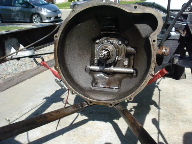

The Model A uses a ball & socket arrangement to hold the front wishbone to the bellhousing. Here is a picture of a front yoke:
Most old Ford parts suppliers sell a repair kit to repair old worn wishbone balls…
The kit costs about $10, I bought mine from www.sacramentovintageford.com
But you can also buy them on e-bay.
They look like this, and you will need two… one for the front, and one for the rear.

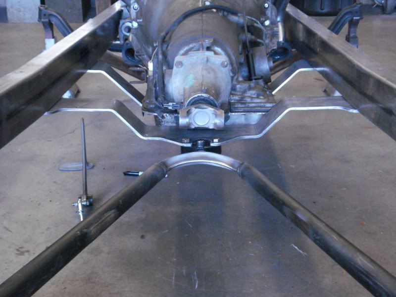

Because the rear suspension on an old Ford originally uses a torque tube… and I am using an open drive line (drive shaft)… I decided to use a front yoke mated to a rear ’36 Ford wishbone, in the rear.
I ended up with the front wishbone mount needing to be 4 ¾” below the frame rails and the rear transmission mount/rear wishbone mount needing to be 2 ¾” below the frame rails.
The nice thing about this set up is that you can use a stock length Model A wishbone in the front, and the mount will be at about the back of the bellhousing, where a manual transmission mounts.
The wishbone clears the bellhousing perfectly.
The other nice thing is that the crossmember that holds the rear wishbone also doubles as the transmission mount.
As you will see, there are two little holes that are drilled in the rear crossmember that the transmission mount, mounts to.

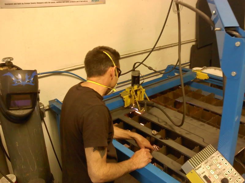

Once we had the dimensions of the crossmembers figured out, my good buddy Chopper Bob got to work on Solidworks, designing the mounts:
And then he plugged in his Plasmacam… and cut them out!
The material is ¼” steel plate.
Now please understand folks… you don’t need the fancy machines to do all of this… just a welder, a drill, a jig saw, and a torch will suffice.

Now that we had the basic parts made… they were trimmed up, and bolted to the bottom of the frame using weld in bungs.
Here you can see the mock up of the rear suspension…
And the rear end held in at ride height with some red straps.
Measure twice, cut once!
Here are the little brackets that I made and welded on to the axle housings to mount the rear to the '36 bones. They are made from 3/8" steel:
Welded in place… I later welded gussets on the rear ’36 wishbones where I had welded the yoke on.
Yes, they are strong enough. I have used this set up on a 12 second roadster that I beat-on for years…
Just make sure you use the ’35-‘36 bones… or build some from scratch using 1 ½” .120 wall round tube.
