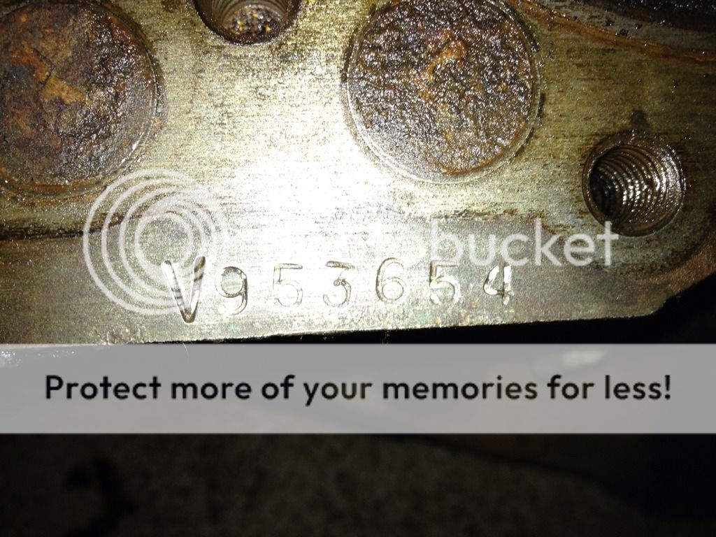

I just recently got a 1956 Olds that I just wanted to do regular maintance to it, but then decided to get another core motor that I could rebuild on the side and then just swap into the Olds.
So I found a 1955 324 here on the HAMB ang got it delivered yesterday.
Here I'd like to document the rebuild and hopefully some of you guys can give me some advice to go in the right direction with it.
Last time I had a shop do the whole rebuild thing, but that was a pretty bad experience...
still on the truck:
Some concern, the freeze plugs in the heads are gone:
The Olds an it's future heart:
Got a nice Edmunds intake to put on:
Now the fun part of tearing it apart begins...
Not of concern, as the head plugs did rust out from sitting. Also the real small ones on the sides of the heads below the valve covers, do rust out if left sitting.
I gotta ask a question on your 56 swap. Is your car a base model 56 88 with the older hydramatic? or is it a Jetaway? Does it show a "P" for park?
I ask, because the cranks are supposed to be different, at the pilot bushing area.

Dave, the current engine is somewhat alright, but I wouldn't trust it going to Austin for example. I'll probably drive it to Williamsburg in April, but will be lucky if everything goes well.
Right now it doesn't start. Not sure yet what the problem is. Most likely bad fuel pump.
Did I say: Tearing a motor apart was fun? I guess I have to rethink that statement.
This is the second motor for me, and after the first one I thought it couldn't get any worse.
The first one being a flathead.
Man, was I wrong. I can see now why somebody would want to sell this motor. (I'm not saying the guy that sold it to me, knew about the condition)
The good news, I didn't break a single bolt.
The bad news:
Can you find the cam
The bores look pretty good despite all the sludge.
Also, there was more water draining, when I pulled the plug, than oil
What's the best way to get the distributor out?
I want to send it out to Bubba for a rebuild. But I wasn't able to move it a bit...
Please, somebody tell me they fixed worse than this!

My only concern is why there was water in the pan. Was it outside without an oil cap or valve covers off?
The sludge is from non-detergent oil, short trips, and when the old cars started to burn oil when they were "old and worthless", the owners just added oil, never changed it very often.
Many hambers have saved Rockets that had all 8 pistons frozen with serious rust, and had pitted bores.
Soak around the distributor base from the outside and inside with PB Blaster for a couple of days, then a little tapping should get it to move.

Yeah, while I'd never expect to see a modern engine look like that, most of the '50s engines I've ripped apart had similar sludge formation in them. I don't think that Edmunds dual intake will cover the ports on a 324 head, though.

It didn't look like the motor was sitting outside. All the covers were on, the valve cover was loose (no bolts) but that shouldn't be a problem, right?
There was no breather on the carb. The carb is frozen up too!
