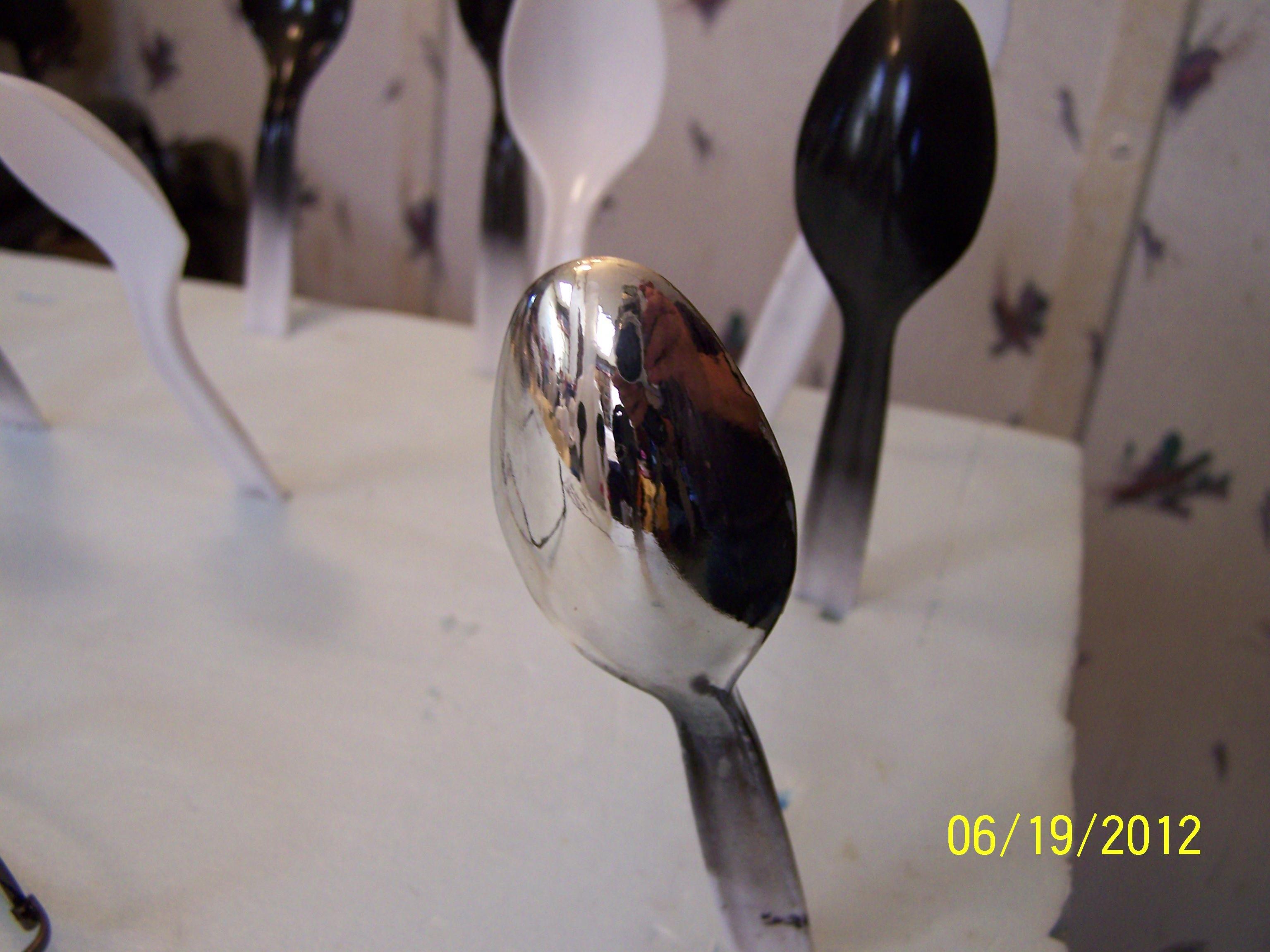

well guys Alsa Chrome Fx pump system just went up to $399 ouch..! thats $100 more than I paid on january...
http://www.alsacorp.com/products/chromefx/
I am back to spoons.. but only to show how good they look to my future customers...
my own tinted chrome cleared spoon vs real chrome
