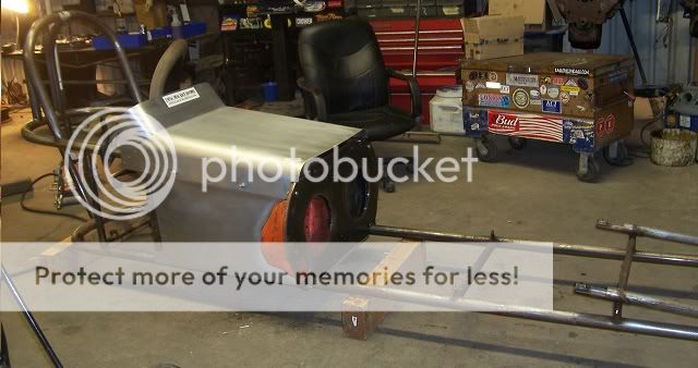

A Little progress has been made with some details being addressed. I shortened the cowl to the angle of the engine plate then filled the gap between the eng plate and cowl with some 1/8" aluminum sign material, tuff stuff
To mount the plate I used Chevy VC bolt "load spreaders", I wasn't looking forward to more small tab making.
Here's the view from the back side.

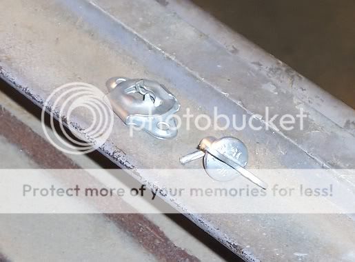

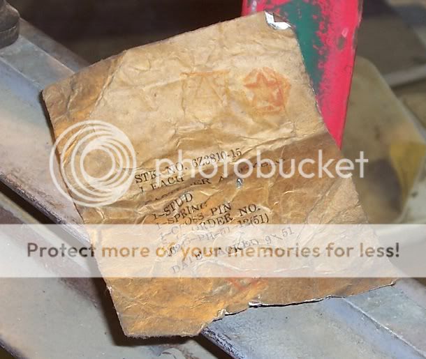

Finally found a tank, need to have some repairs, make some straps and clean it all up.
Before the night was over I had to try the T body fit after the front of the body was completed. The mounting of the T body is coming to me and although I'm not looking forward to the glass work I'm salivating at the thought of how low the body will make the car look when I figerglass in the Tonneau cover.
Very cool. I also have an original Moon tank that needs some work. If you fix yours post some tech info and pics on how you did it.

I'm no Tom Hanna but I'm pretty happy with the TWINS Body progress. Down to the last of my aluminum which a friend gave me off a trailer that had been damaged. Just made it

So what did you do for patterns? Posterboard patterns?

Everthing 'cept the rear was done with measurements and bent 1 shot, the rear I made a cardboard pattern, cut the piece big and trimmed to fit.

Here is the 350 Stormy Byrd gave me (fresh rebuild) that is replacing the 307..........I'm getting excited!

Join Date: May 2006

Tonight I got out the shears and made up a couple of "Flash Shields" for the carbs. The holes you see in the tops are to tighten the carb top screws which double as the shield mounting.
