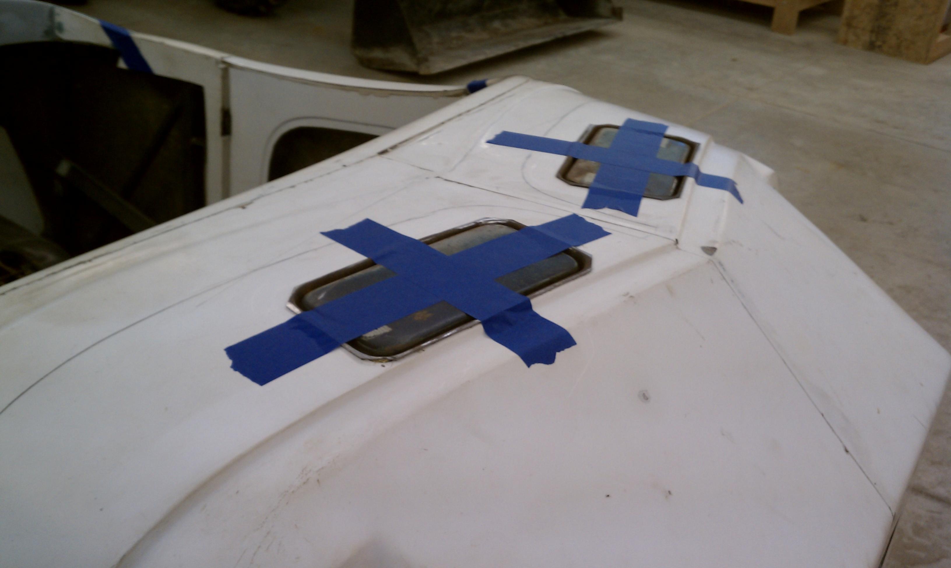

Click image for larger version
No replicas have cowl vents this one does!!!
Cord has very similar size so we fitted a pair of cord cowll vents
The deck lid is for a Speedster motorcars but we had to use what we could to make it fit
The cockpit is 6 inches longer now!
