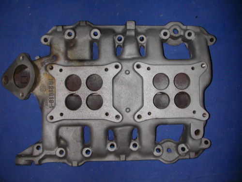

Will this fit on my 1956 330 Desoto Hemi

    It's an intake from a 57 Desoto and lookd like it will line up. Part # 1821319-1All help is appreciated. TX

  2. The manifold will fit . The 330,341,and 345 all use the same intake. I have a 57 factory 2x4 intake for my 345.

    1. Early Hemi Tech
    56 and 57 Desoto intake. Other than that, you are good to go.

    Can I ask a stupid question? What is the extra hole for?

    Jeesh, I went away, THAN thought: I'd better ask Tom how critical that is, since my long-term dream is still to build a 330/341 DeS. SO, if it's a stupid question, it makes two of us, bro! LOL
    My assumption was that it was for a better mount for AC, etc. So, I guess my real question is: Does it become irrelevant, if it's going into a '56 DeSoto? Oh, and does the regular '57 4-barrel intake have this same cast/drilled boss?

    1. Early Hemi Tech
    The hole is for a nipple for the bypass hose to the water pump.

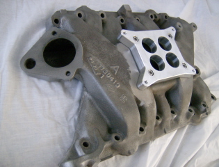

  9. Any one have a spare single four barrel intake laying around for my raised deck?:D
