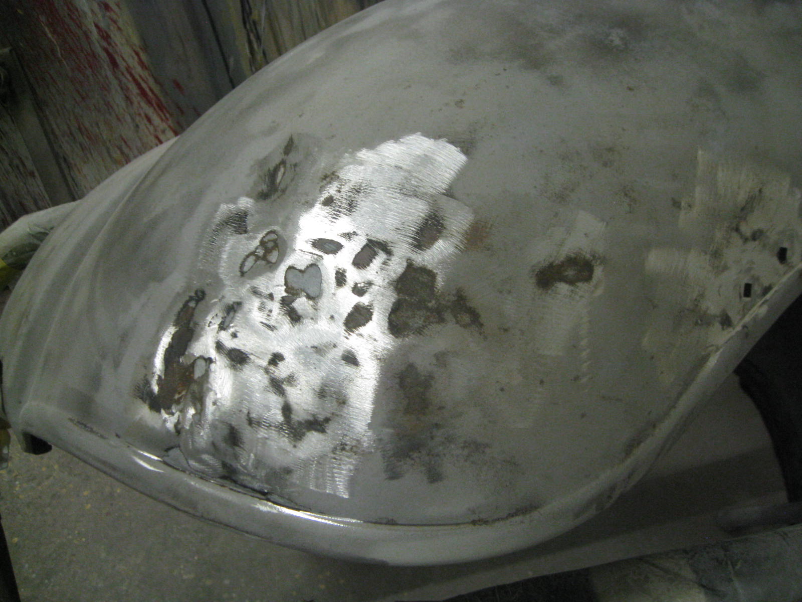

  24. the metalsurgeon
    Joined: Apr 19, 2009
    Posts: 1,237
    the metalsurgeon
    from Denver
    Onto restoring the LH front fender.The fender was in fair shape mainly dents filled with bondo_Once the body was ground out i metal finished the fender ready for primer.
    my weekly metal work blog www.themetalsurgeon.com
