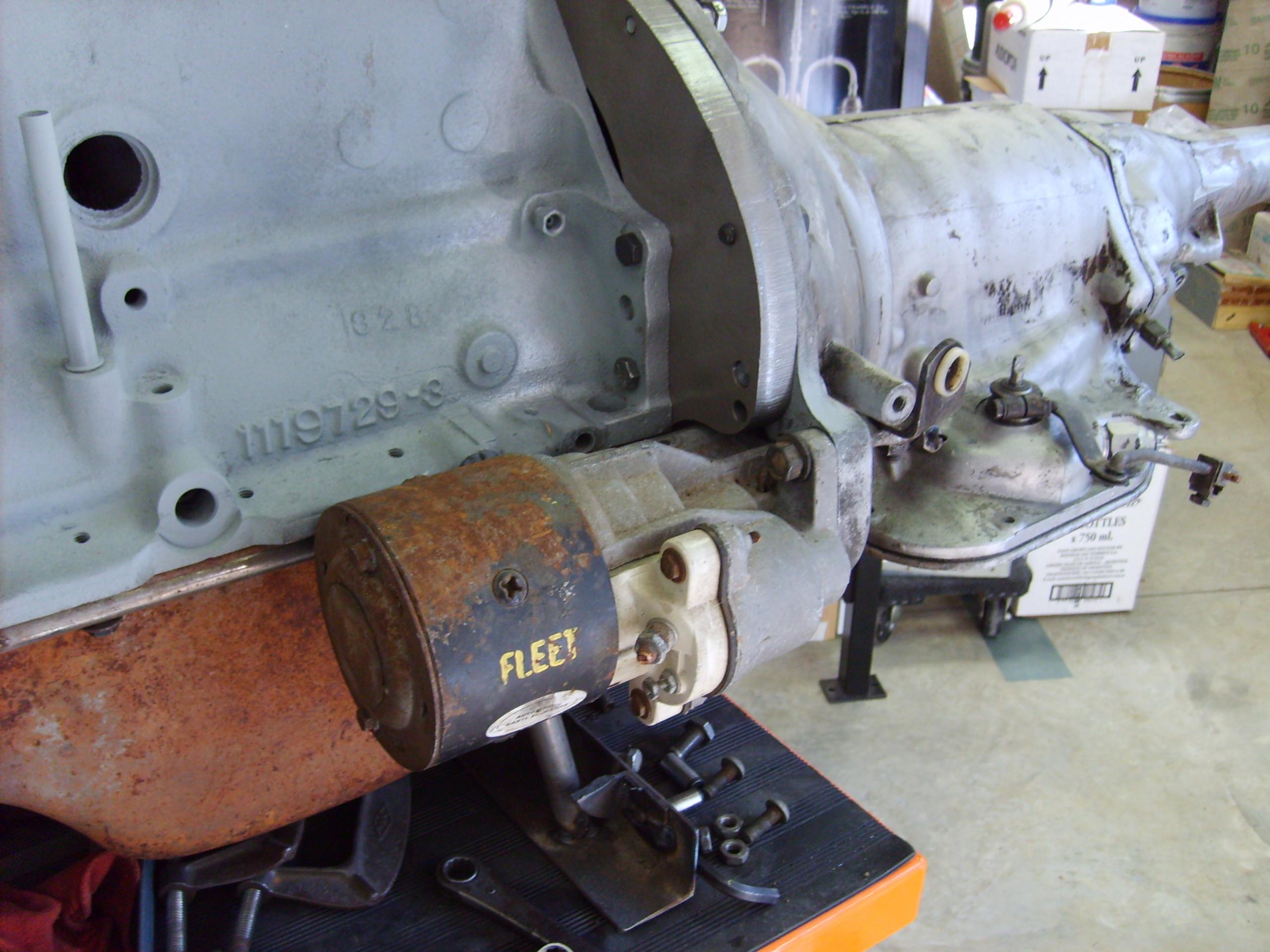

Quote:
Originally Posted by Modeljunkie View Post
The trans in question, at the moment, would either be a GM 700r or the 200r4 since I can only find one adapter for the back of the block for either of those two in 4 speed auto transmissions...my wife has requested that if I change transmissions that I make it an auto so she could drive it too. I'd kind of prefer to keep it all mopar, but I haven't seen any mopar 4 speed auto trany adaptors for the flathead 6.
...seems that this was covered in another thread of yours...

Now you guys have me thinking about that 48 Chrysler Windsor I picked up a couple of years ago.

I'm including a few pics of my application{car} for those ho may have a similar set up-
Here's a general view of the engine compartment- this is a 40 plymouth
Here's the block, a 201 and yes I have the oil bath air cleaner, it's just the PO had a loose fitting nut on it and I have to take the whole thing into ace harware today to get the correct fitting nut for the air cleaner.
Here's the front of the radiator bulkhead, there is some fudge room available for moving it forward and the PO gave me a spare panel {top nose piece} to possibly aid in the event if I ever did.
You later model guys have it easier with your one piece hoods, mine is two piece and easy lets rain in/on the top of the block which is a minor hassle for puddles around the plug holes....everything is a trade off I guess as I really like the twin hood halves.
offline   Reply With Quote

I forgot to mention - if you want to go for the big bucks and have something really exotic - Earl Edgerton makes an overhead valve conversion for these motors. If memory serves the complete kit (head, valve covers, cam, lifters, rockers, timing cover/chain, etc) runs about $5k. I saw this mentioned on a thread here a while back.
Here are some porno pix for ya - including Earl Edgy's F-head conversion....

George is the recognized authority on MOPAR L 6 motors, he splits manifolds, rebuilds over drives, remans B ad B carbs, etc. Used to race the flatties for years in Western PA.
Your shift linkage is different from the post war cars, so I can't help you, but the transmissions are selector style. Check the rubber gromets at the steering column, and make sure the movement of the levers goes freely from detent to detent.
Also check the condition of the front and rear motor mounts as if they are squashed and sloopy they will cause the linkage to travel more than they should.

OK I've got a flat 6 and trans from a '37 Dodge truck. It's 25". Is this right? And if so what cubes is it? I'm thinking of building a cheap little rod around it.
thanks!
Quote:
Originally Posted by plym_46 View Post
All Plymouth, Dodge, and Dodge trucks had 23 1/2 inch long blocks, as does mine. All Desoto, and Chrysler, and All Canadian built Cars and trucks used the 25 inch block. US 217.8 and 230 blocks from 1935 up are the same, the difference between the 217.8 and the 230 is the crank and rods. No plymouths used fulid drive and all early plymouths had a 4 bolt cranckshaft flange (till 53/4) All dodges with fluid drive regardless of transmission, used an 8 hole crank shaft flange (to accomodate the extra weight and length of the fluid drive unit) Plymouth 4 bolt flywheels will fit on the 8 bolt cranks but need to be alligned properly to the assymetrical hole pattern. Some later Plymouth 230 (mid year 54 and newer) used a 6 bolt flange. Some Dodge drive shaft flanges are thicker than Plymouth and some dodges. Dodge bellhousing are deeper than Plymouth to accomodate the fluid drive unit, Dodge transmissioin input shafts are longer than Plymouth when equiped with fluid drive. Most Dodges from 41 through 55 will have fluid drive, some Desoto and very few Chrylsers were not equiped fluid drive.
All mopar flat 6 setup use the bellhousing as the mounting and locating assembly. Bolting to a frame chrossmember in cars and to the frame rails on trucks and industrial applicatioins. that said the accomodation of the longer block will of necesity be forward of that mounting point. As noted sometimes it is as simple as moving the radiator to the front of the support, others will require modification of the front crossmember, and swaping of the oil pan and oil pump pickup.
Fluid drive is NOT THE TRANSMISSION.

In the meantime I have an odd question...what a shock, huh?
I spied this long ago on mine and when some folks here mentioned rebuilt engines that had a tag I got to thinking...
Here's a pic of the remnants of a tag near my engine number...could this possibly be a tag stating a rebuilt engine or just a factory tag that got ripped off long ago?

Old 12-20-2011, 12:59 PM   #108
73RR
Old School HAMBer
73RR's Avatar
Join Date: Jan 2007
Location: Central Ory-Gun
Posts: 4,908
Default Re: Mopar flathead 6 motors- whats to be expected
Consider that rebuilt engines were available from literally dozens of vendors including the likes of Sears and Wards so the shape of the tag could be whatever their standards were.
The over-the-counter replacements from Mopar had a completely blank pad and some rebuilders then stamped them to match the original...recall that some states used the engine number on the title and rebuilders had to stay in line.
Your remnant certainly could be from a rebuilder.

Old 12-20-2011, 02:39 PM   #109
Modeljunkie
Grenade Inspector
Modeljunkie's Avatar
Join Date: Sep 2011
Location: Aurora Illinois
Posts: 283
That scratching on the block # boss makes me wonder, but the tag has a little boss that it's attached to that looks cast in...you can't add that after the fact.
Just seems odd.......

Old 12-20-2011, 03:33 PM   #110
plym_46
Old School HAMBer
plym_46's Avatar
Join Date: Sep 2005
Location: central NY
Posts: 3,155
Definately a rebuilders tag, but the original engine number starts with P10 which means it correct to the year of the car's manufacture. As noted there were lots of rebuilders, From Sears and Roebuck to Jasper, and folks that used the Chrysler Method, these were licensees that signed into The official mopar rebuilding specs. these rejected blocks that needed more than .010 off the crank rods or mains.
Here is a thread discussing some of the posibilities. Other threads have discussed engies with different color paint, Jasper used a distinctive green, others used a machine grey, and still other did not redo the outside of the block.
here is a recent discussion
http://www430.pair.com/p15d24/mopar_...ght=rebuilders
