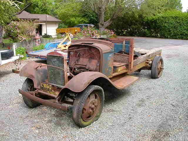

    Many have asked that I put all of the build posts of my RPU together into one thread...so here is my attempt. I've been stuck at home, sick on the couch for a couple of days...so please excuse the rambling...and I know alot of this is re-runs...so here goes anyway...
    I will start by backing up a bit. Back in about 1985...at the age of 18, I bought a hacked up 32 frame out of an old drag car, a 32 grille shell, a More-Drop axle and a few other bits that were going to be the start of a hot rod. At the time I had a 29 Model Tudor sedan body...but I wanted to build that full fendered. After a few years, I ended up trading the sedan body to my brother for a 29 Sport Coupe.
    The plan was to put that on the 32 frame and build a mid-50's style hot rod. College, marriage, work, home ownership, etc got in the way and all these parts sat at my dad's place...waiting. In the late 90's I got the bug to get back into the car building thing. I came up with this plan in 98...
    So I started gathering more parts and info. It was going to be a painted, plated, upholstered 50's style Hot Rod...which, financially...at the time, was going to a very long term project. Then I found the HAMB in '01...and I saw the Roach Road, Mart's Ol' Rusty, Mild Mitch's Mod, Rocky's 33, etc...and got the itch to build something quick and dirty. My dad's neighbor had this cutoff 33 cab for sale for $50...
    I brought it home and came up with this plan...
    The plan was to build a channeled "rat rod"....if I can use that term here. ;) You know...doors welded shut, rusty sheetmetal, open headers...you know the drill. I had a front section of a 32 BB frame, was gonna slim that down and build the rest out of rect tube. This was going to be a quick...temporary thing, so I was going to use the front suspension, grille shell, etc that were for the Sport Coupe. The more I planned...the more I wanted a roadster for a keeper. The sport coupe wasn't going to fill that "want". I finally decided to sell off the sport coupe and build the RPU as my keeper. I still thought I would have it together and on the road fairly quickly...:rolleyes:
