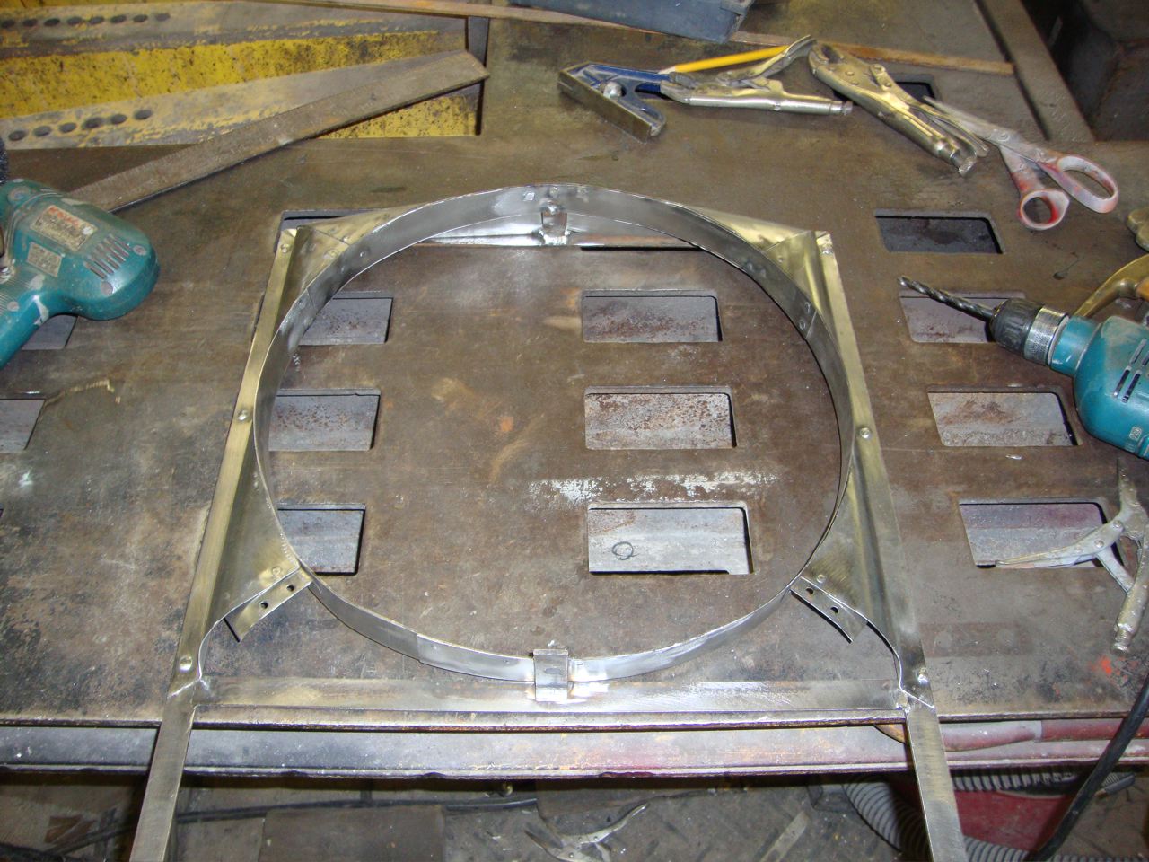

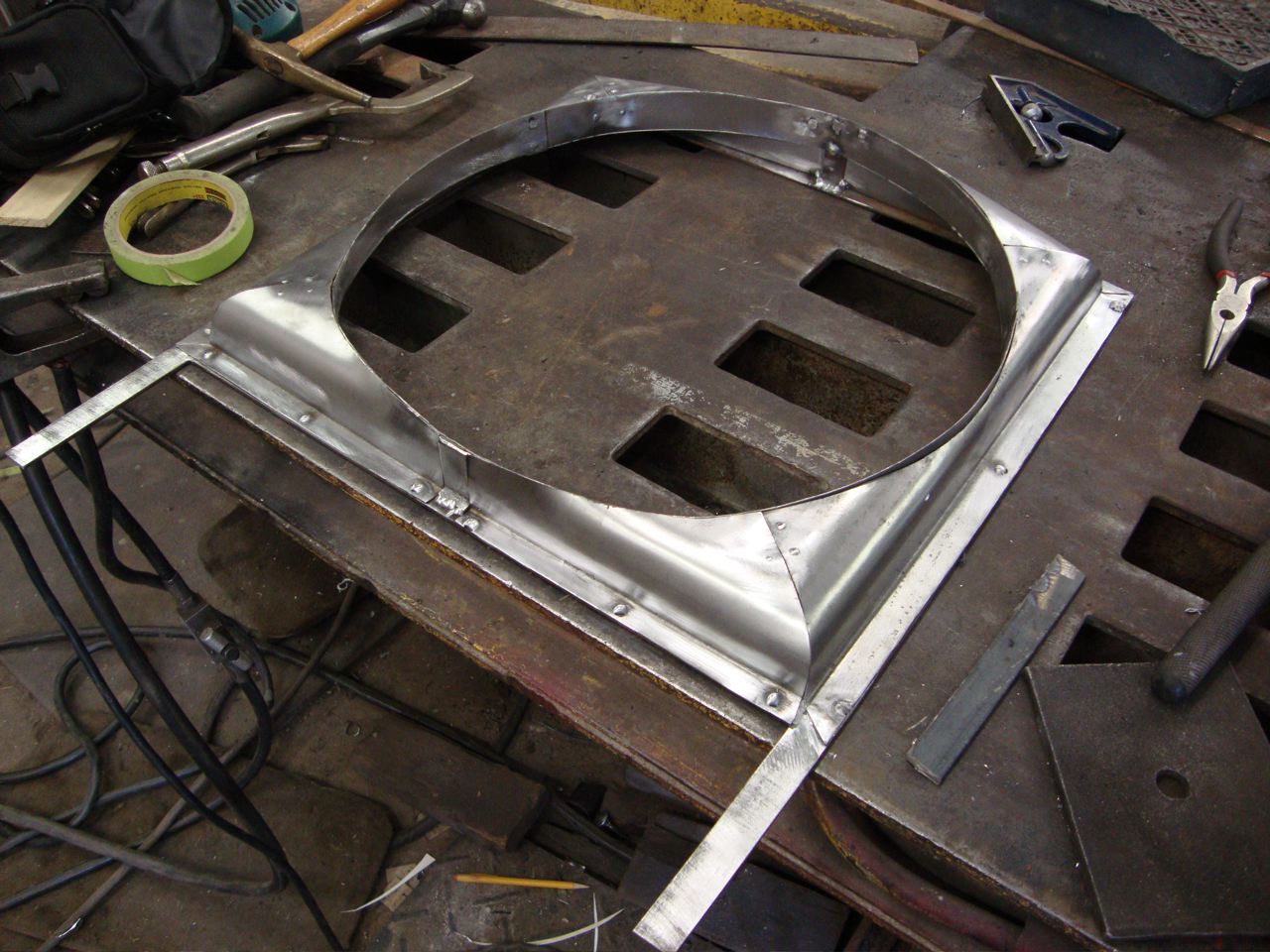

    I made a simple shroud from 20 GA sheet and ¾" flat iron strap. The fan is about ¾" from the radiator core, and the rear of the fan blades are just exposed, not buried in the shroud. It has helped mainly at idle in hot (90&#730; plus) weather. Definitely worth the trouble.
