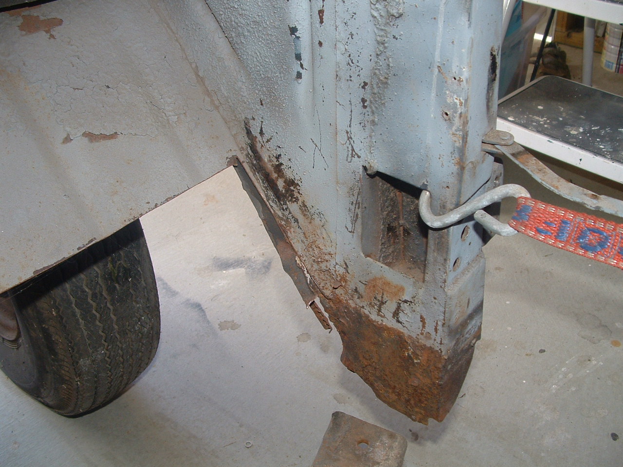

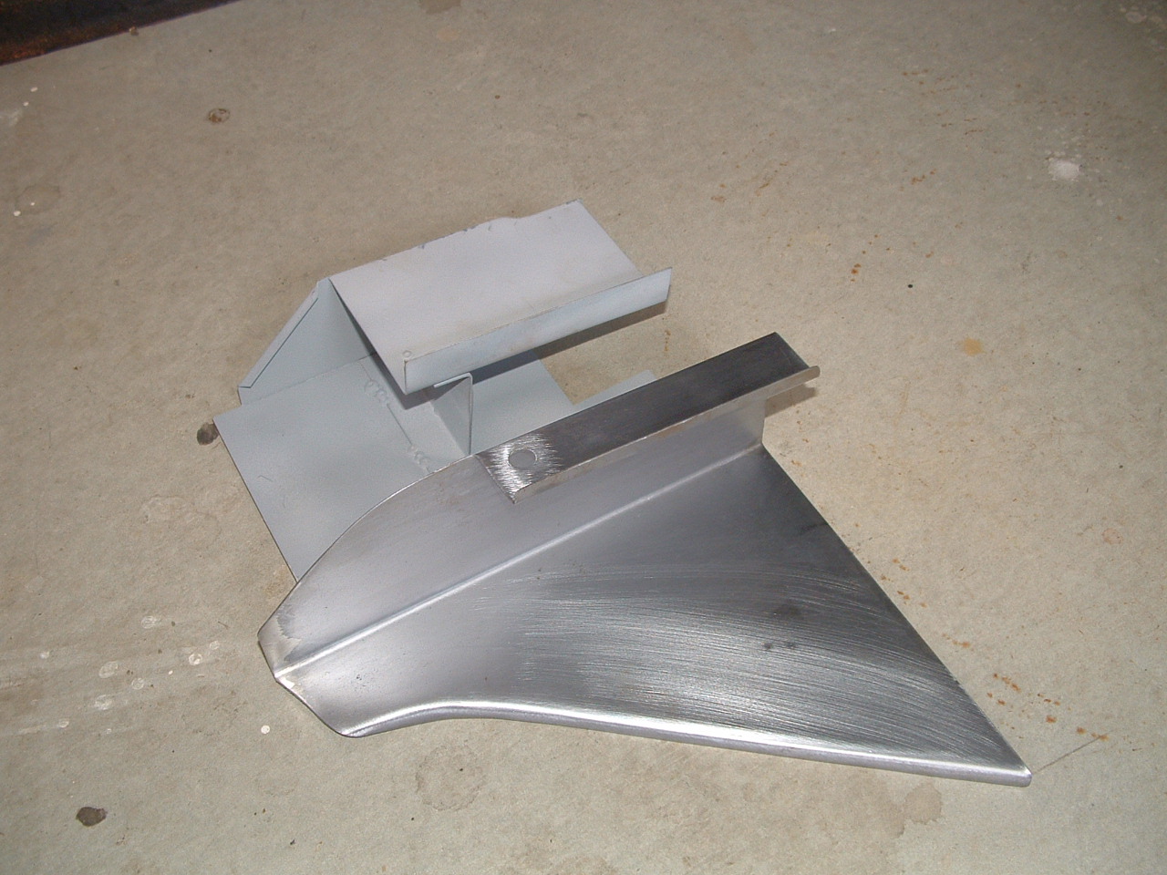

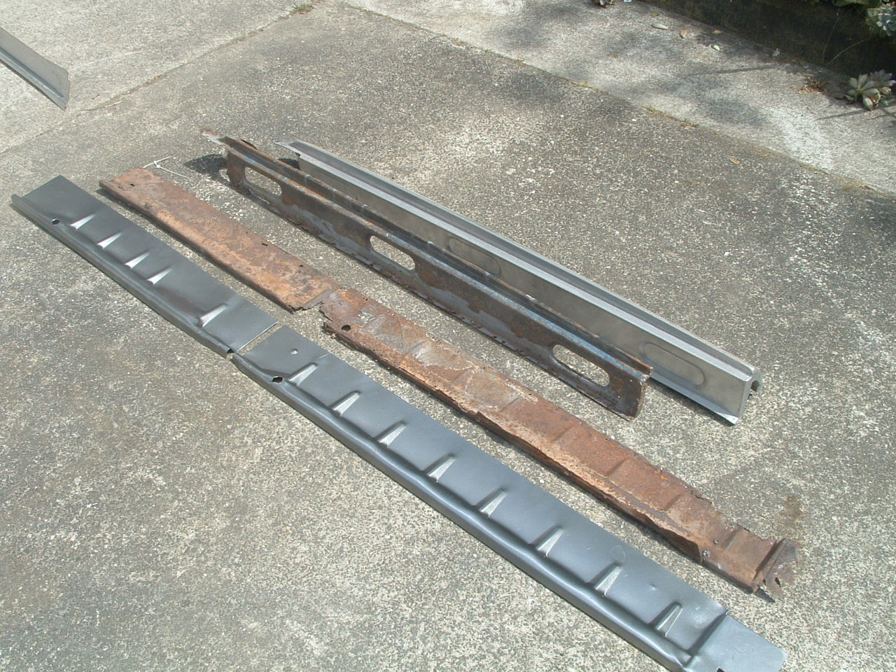

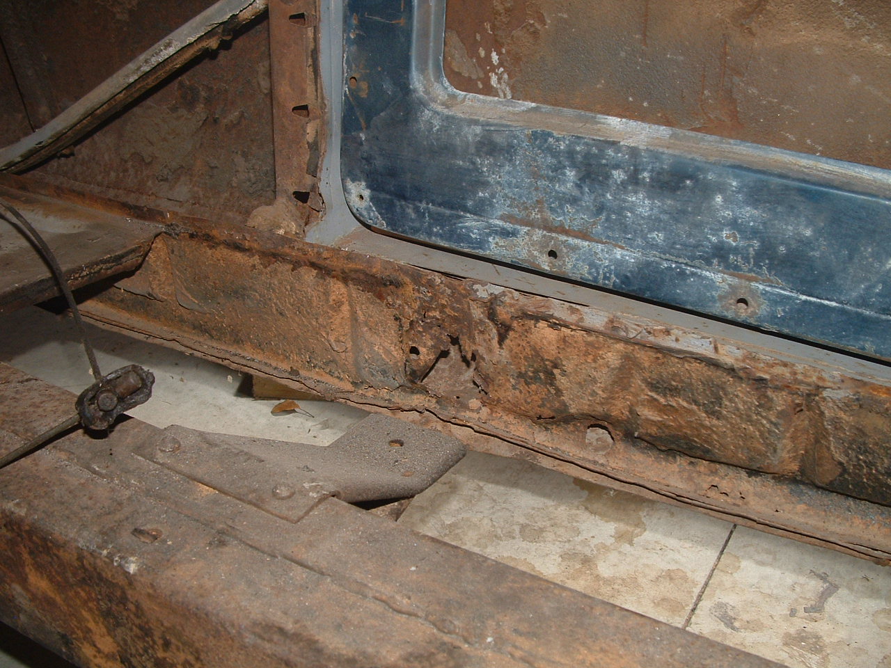

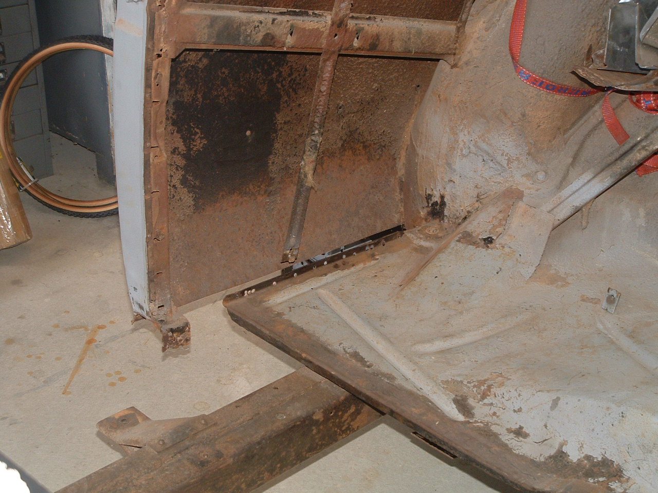

    When it arrived in NZ it did sort of run but not very well. It had a 302/C4.
    I pulled the engine and stripped it down to find broken rings and years of neglect. The C4 had sand in the sump pan??? As for the body I set about cutting and grinding out the previous repairs. Unfortunately the trans tunnel had been replaced with a home made setup so I had to do alot of work to save what I could. I have left the drivers side intact untill I sort the passenger side rockers. I did not brace the body as it was already out of shape so I didnt see any point. As the new rockers go in I will pull it back to align the door gaps. For now im going to screw everything in to get it right then I will go through and complete the welding.

    The lower door post is also up for some attention.

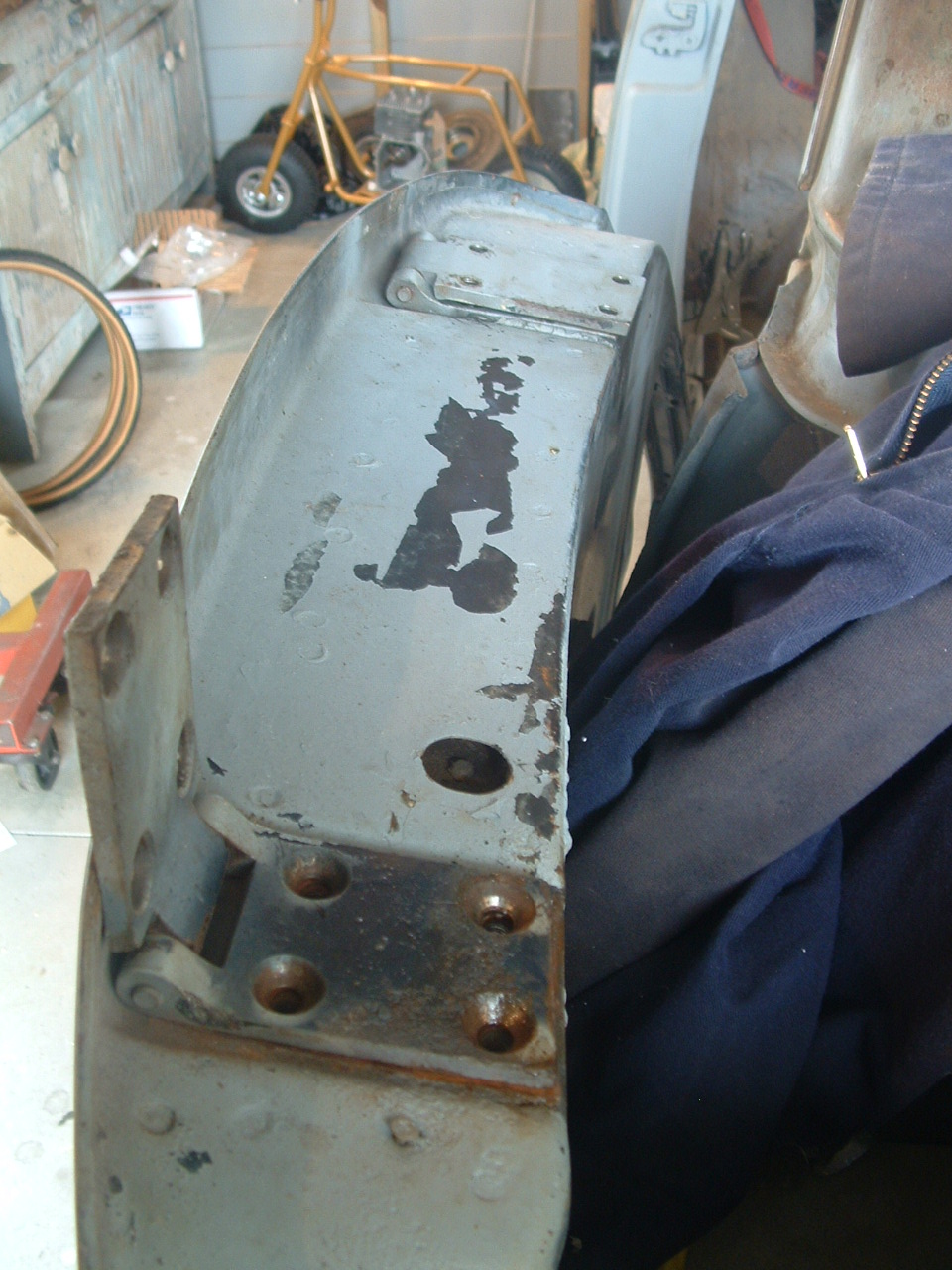

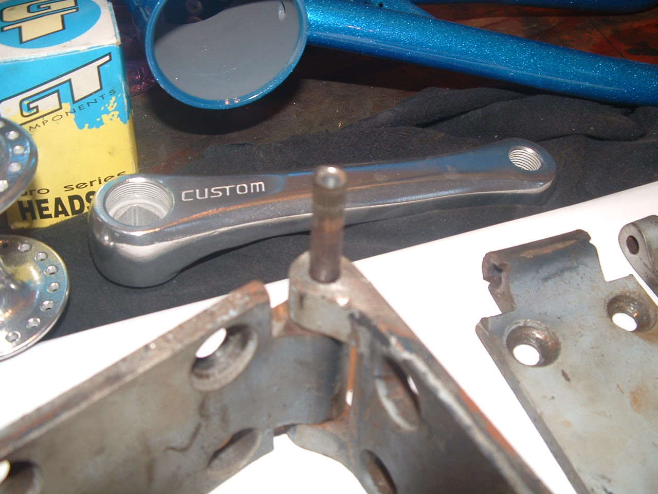

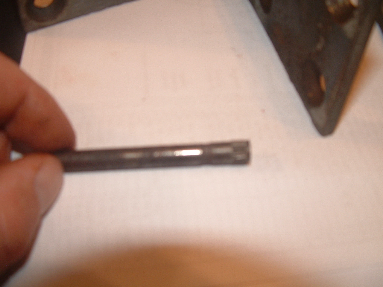

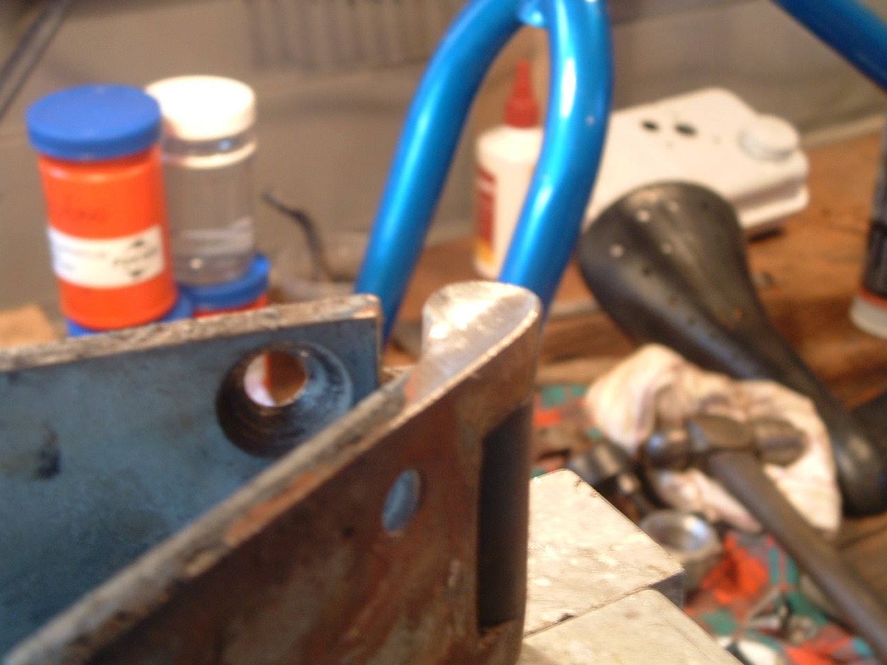

    Well its a long weekend here in NZ so ive been working on the coupe when I can.
    I spent Saturday afternoon doing battle with the door hinges. They look to have never been off before so it took the best part of three hours. I used an impact driver along with a steel drift, spray penetrating lubricant and a heat gun. I started by giving them a soak with the lube (CRC,WD40 etc). Then using the drift I tapped around the head of the counter sunk bolts. This serves to break any corrosive link between the bolt head and the hinge and also in the thread. I then used the heat gun and applied heat to each bolt head. Now using the impact driver I worked the bolts free. Trick with the impact driver is to make sure you allow it to return to full stroke after each blow and make sure it is bottoming out with each blow. Once the hinges were off I ground down the hinge pin at both ends. I then drilled a hole through the centre to releive load. Now using a punch, while holding the hinge in the vice I drove the pins out. Note. The pins are splined one end and will only come out one way. Spline first. It was interesting to note that there is a reasonable amount of wear on the pin. Im now on the hunt to find new pins. I can't see them in the Dennis C cataloge? Does anybody know if they are available? Thanks.

    Thanks. Yeah that worked out well. If the original pins are available however, I have measured mine and the wear is on the pin (~ 0.003 inch) so new pins should do it. If not I will do as shown. Cheers.

    Good question. The first thing I did was to check the body was securely mounted to the chassis both forward of the firewall and rear of the "B" pillar/door post. Ive then taken plenty of measurements and split the difference. For the record and of interest was that the measurement taken diagonally from the lower A pillar drivers side to the lower passenger door post came out almost exactly as stated in the factory measurements. All these measurements are in the green bible. Priority is to get good door gaps so once I sort my hinges I will reatach the door then clamp/screw the rockers/floors in place and recheck before final welding.
