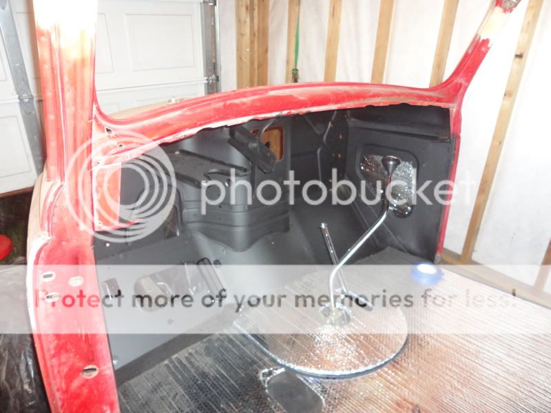

After much debate and a lot of HAMBing I started to gather parts. Looking back I should have done more research. Went from a mustang 2 clip, to a Nova sub frame (didn’t fit) finally settling on an AMC pacer front clip. It fit the frame rails perfect.
Morrison Ladder Bar rear, GM 10 bolt. Once again looking back I wish I would have done more research and checked the gears before I purchased. It’s a factory POSI 2.44 gears. I will be upgrading to 3.73 when I get home. I have a 700r4 and I don’t think I will even hit OD.
Cab mocked up for my motor mounts.

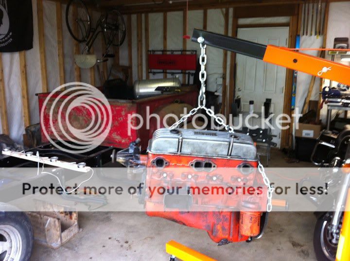

Me and a buddy who has a 54’ went halves on a 55’ to rob some parts off of. I took the core support, and the roof. The roof should save some fab time when the top is chopped.
Picked up a 68’ 327 off of a friend.

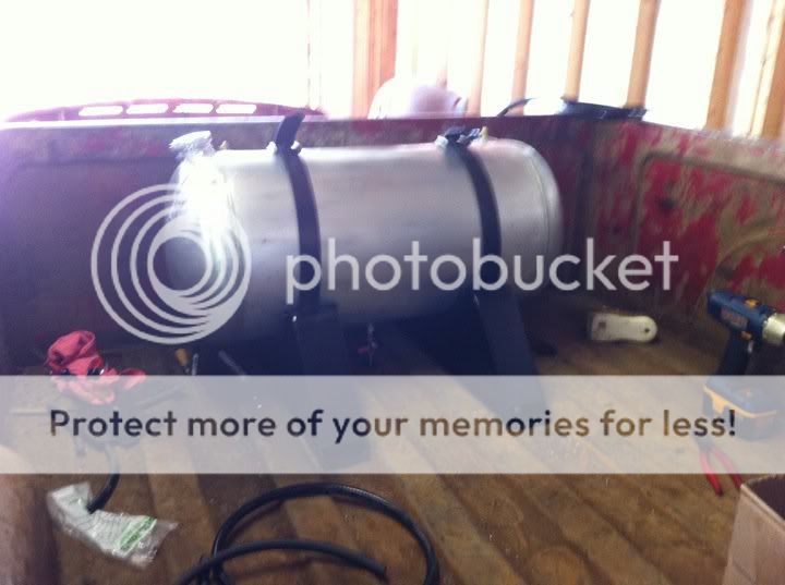

While the motor was being machined I started on an old Hobson tank I picked up at a swap to feed some fuel.

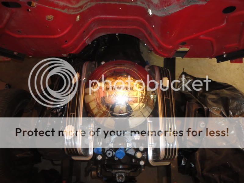

Dropped the 327 in did some light polishing on the original finned aluminum valve covers.
So when I get home I will put the Trans in and take it from there. My girlfriend is starting to complain about not being able to walk around the house due to all of the boxes that are showing up. I have been ordering a lot of stuff so I can get this on the road when I get home. I am planning on a 1 FEB No Later Than running/driving date. We will see… >>

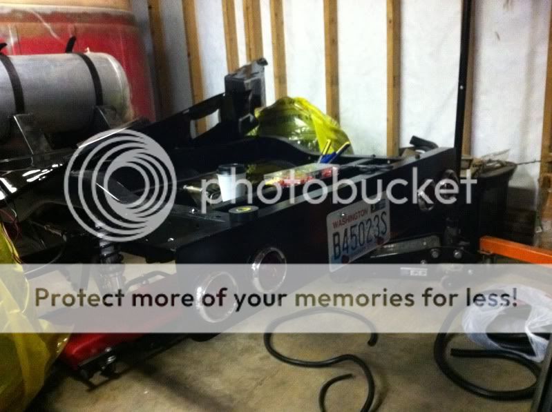

Haven't you got the suspension in there back to front?
offline   Reply With Quote

I mean the suspension looks like it is in there backwards. Didn't it face the other way in the Pacer?

Honestly i have never seen one in a Pacer. I had a friend put the clip in last time i was deployed so i hope its right! I do believe this was number 49 or 50 that he has installed, he uses them in everything.
