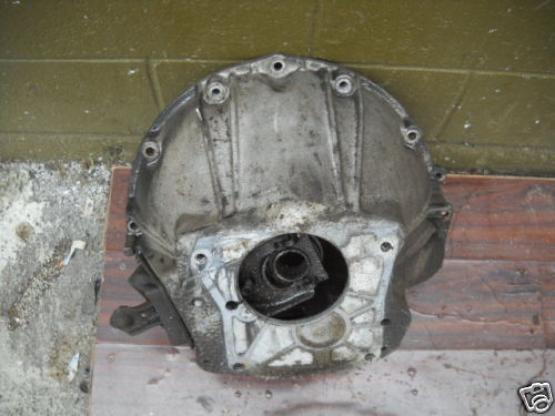

Quote:
Originally Posted by Tman View Post
I can get a picture later, GM on the block side, Ford on the tranny side. Mine was out of a CJ5
Is this it?
Click image for larger version
__________________
"This is no dress rehearsal, we are professionals, & this is the big time."--Waylon Jennings
offline   Reply With Quote

Quote:
Originally Posted by Scotch Buzzard King View Post
Is this it?
No.
early 80's 2.5L in some jeeps. Looks just like a Chevy V8 bell, but with the Ford trans bolt pattern.
It uses the small 153 tooth flywheel. The center hole size is different than Chevy or Ford, so either change the bearing retainer to one from an AMC T5, or turn down the Ford retainer (I think the Ford is larger than the AMC IIRC??).
Also Astro vans with the 4.3 and T5 used the Ford pattern, but these will have the Chevy center hole size.
I have an adapter plate, but it is intended for using the '93-up Chevy T5 with ford pattern and Chevy center hole size. Punch out the center hole or switch bearing retainers...
Some Ford T5's have a larger diameter tip on the input shaft, so a custom pilot bushing would be needed.
There are also several different lengths of inputs on the Ford T5's, not sure that any of them will work without using an adapter plate just to move it back so it will fit....
