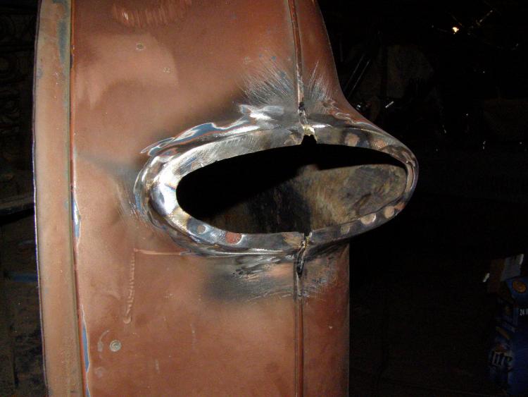

I should've started this thread a while ago , but better late than never - LOL !!

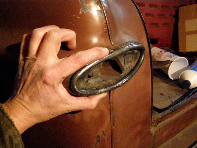

A little preface for those who don't know , I have a '49 Ford Custom Club Coupe that will be (when finished) a mild custom . I got the car with no motor , and I intend to drive it daily , so it's getting a 302/C4 combo - eventually a T5 tranny will be installed , as I love to shift gears . I've already lowered it with Aerostar springs up front & 3" blocks in the back - it'll sit nice . I have some Foxcraft cut-down Merc skirts for it , and the plan right now is that it'll eventually be running '55 Chevy BelAir sidetrim with the paint dividers down , two-toned in the back . Till I find the pieces I need , it'll be runnning the stock rear 1/4 trim with the fender short-spears on the doors - should look cool . Right now , I'm looking at painting it the original dark blue metallic color , but that could change till it's done ... you know how that goes . Well - on with the show !
I started my metalwork by shaving the trunklid . I did a How-To on it a while back , if you missed it , you can see it here :
http://www.jalopyjournal.com/forum/s...ighlight=trunk

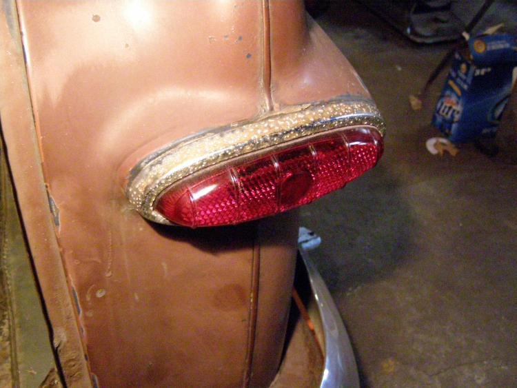

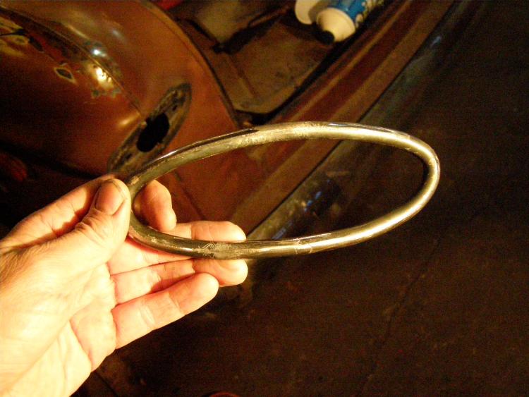

A few months ago , I did an old-school french on the taillights (i.e. no tunneling buckets) . I shot a few pics along the way to share with anyone interested .

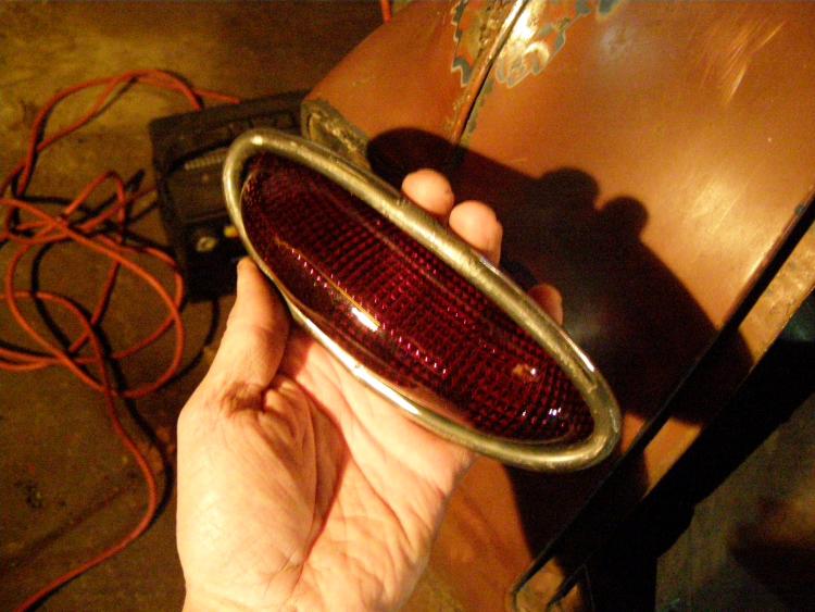

Here's the original taillight , as you guys know

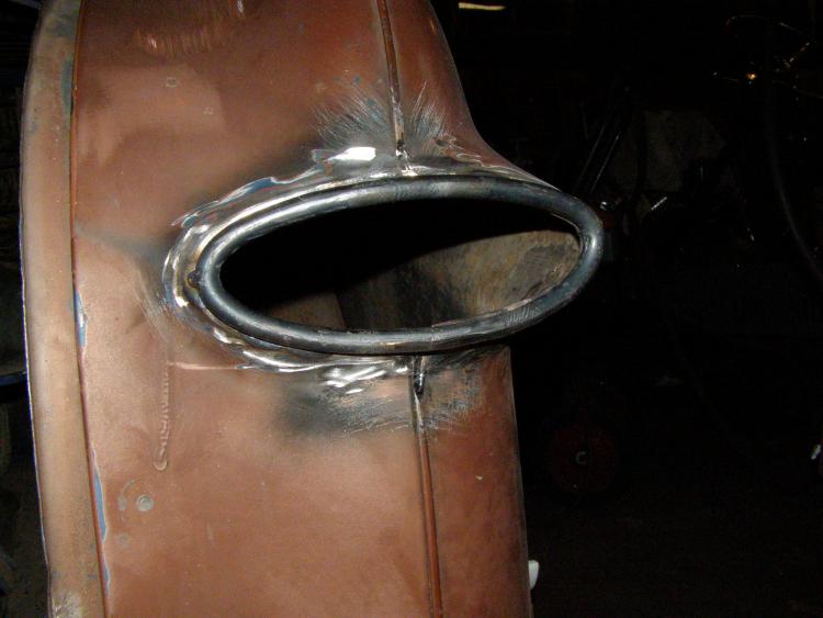

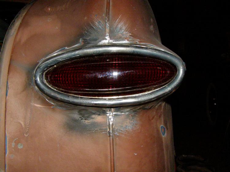

I made a 1/4" steel buck ,
bent some roundbar around it ,
put a little peak on it , to give it some visual interest ,
and here's what it'll eventually look like :
Here's a little preview of it's new look :

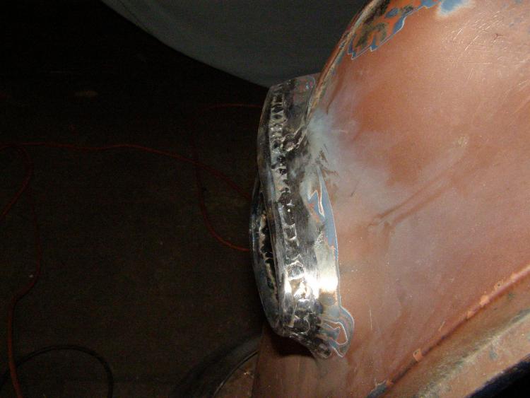

I cut the center out of the original taillight panel , so the housing can come in from the backside :
I tacked the new lip in place
holding the new lens in behind for a look
and welded it up . It'll get all leaded-up to finish it off right .
It's new look !

Thanks guys . I like the look of this style so much better than the tunneling buckets - more old school style too . I even bought the buckets & ended up not using them - we'll use them on my friend Craig's custom .
I have a bunch more pics to post , some repair stuff - some custom stuff , so keep your eyes peeled .
Finnrodder - The lenses are Lee Lenses ( www.leelenses.com ) . Even with stock chrome bezels , they look cool . I got mine through Wirth's Customs ( www.wirthscustomauto.com ) , but they're available all over the web .

No blue dots here . I do like 'em , and you can buy original-style lenses w/blue dots already in 'em (you know that already ) , but Lee lenses were the way to go this time .

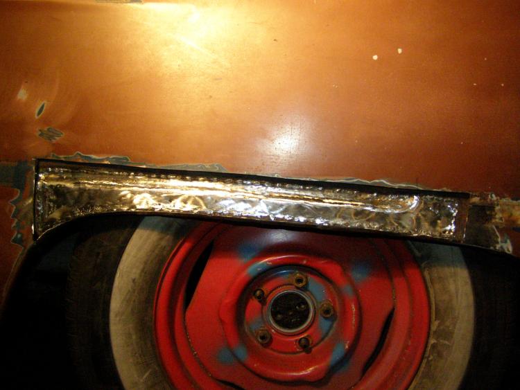

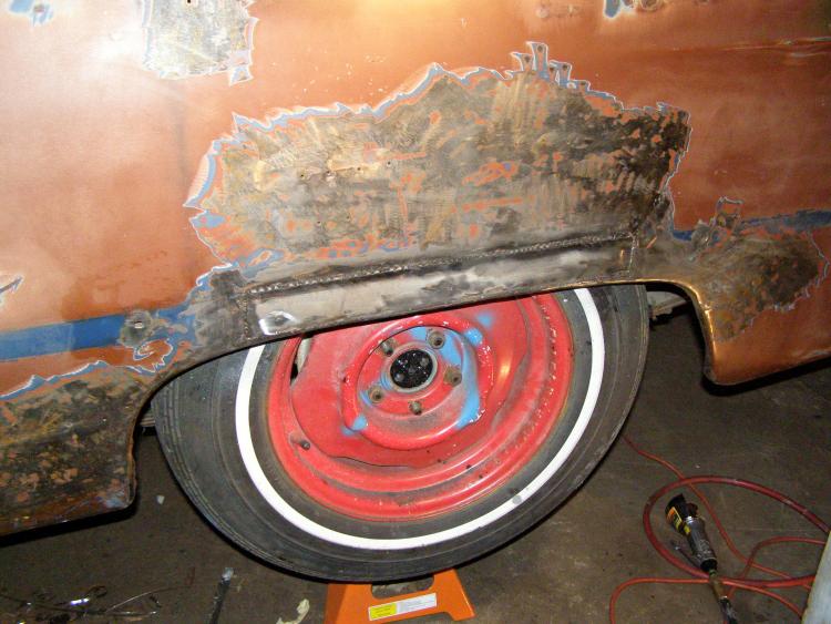

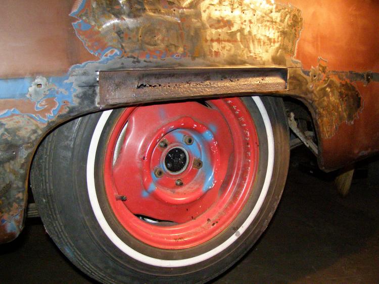

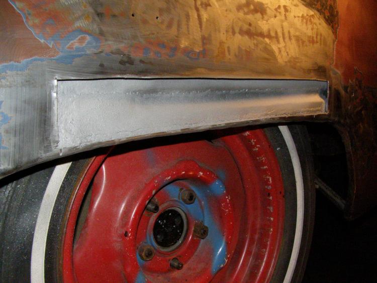

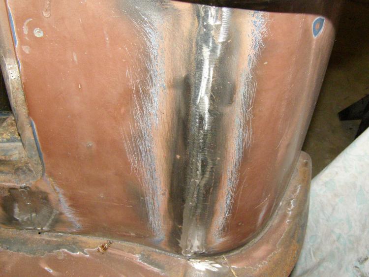

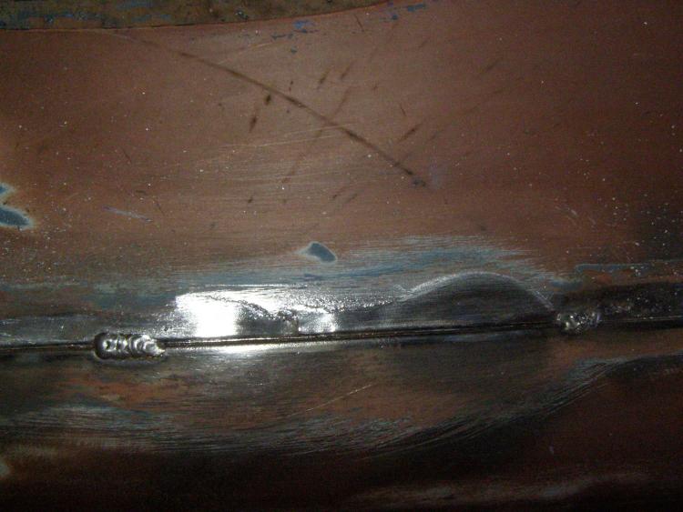

Well , I've got some more update pics for you guys .

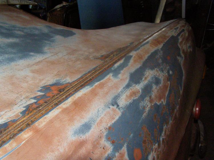

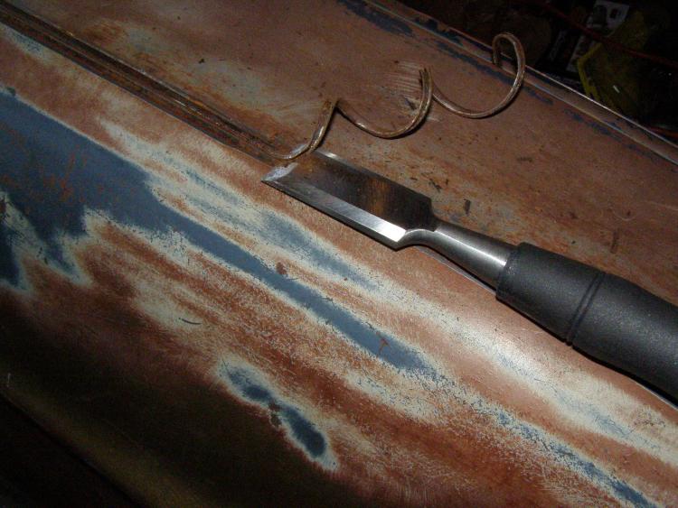

See this ugly seam up on top of the rear quarters ??
I got rid of it the old fashioned way ... with a WOOD CHISEL !! Don't worry , I learned this trick here on the HAMB . I won't tell my old shop teacher

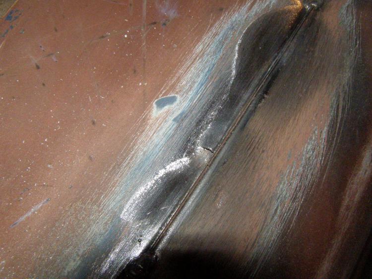

I had to get rid of a bit of lead
I tack welded it up & back
I took my time , skipping here & there until it was welded solid (probably overkill , IMHO) . I ground it smooth (sorry , no pics of that for some reason - I'll shoot a couple) , and it will eventually get a pass of lead to finish it off . I repeated the procedure for the seams under the taillights . Another small mod that will have people scratching their heads as to what's different .
More updates to come !!

Quote:
BUDDY.. I am a shop teacher.. and your defiling that WOOD chisel!!
