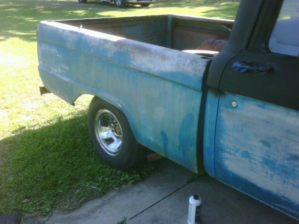

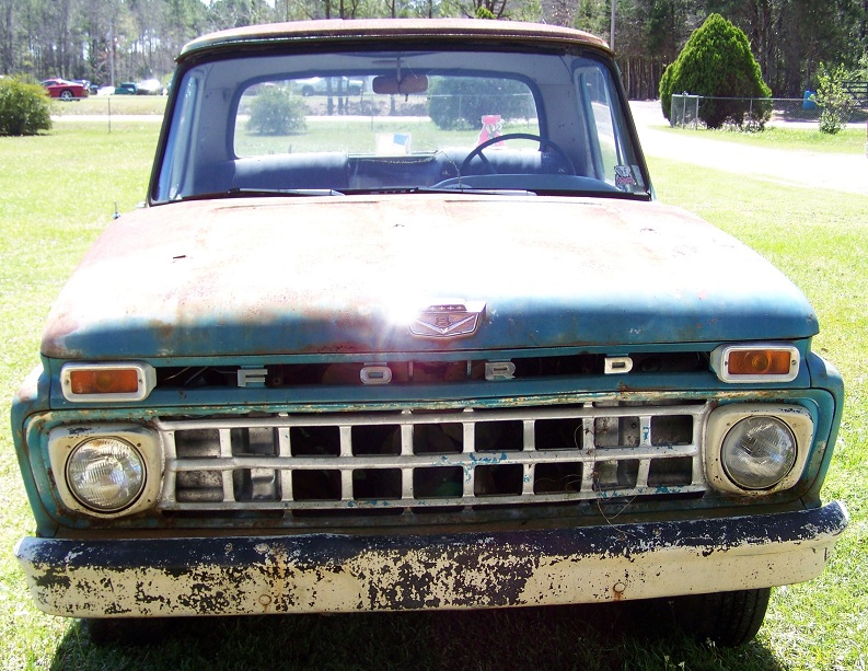

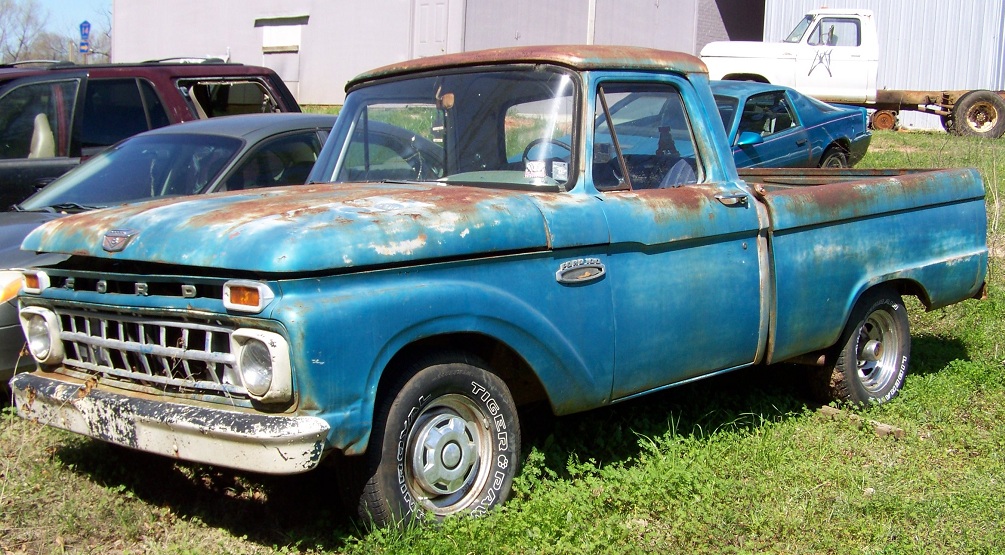

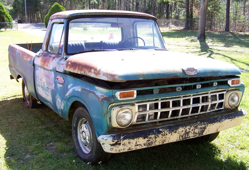

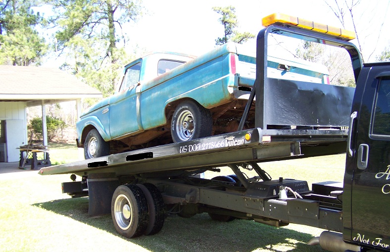

here is the start of my resto mod build of my 64 styleside. It will be powered by a 302 ci 5.0 liter Mustang engine, complete with roller cam, Electronic Fuel Injection (EFI) and hopefully either a Borg Warner T-5 or Built C-4 (still deciding)....Here is the beginning of my truck, and its slow adventure from begining to end.
thanks
Ben

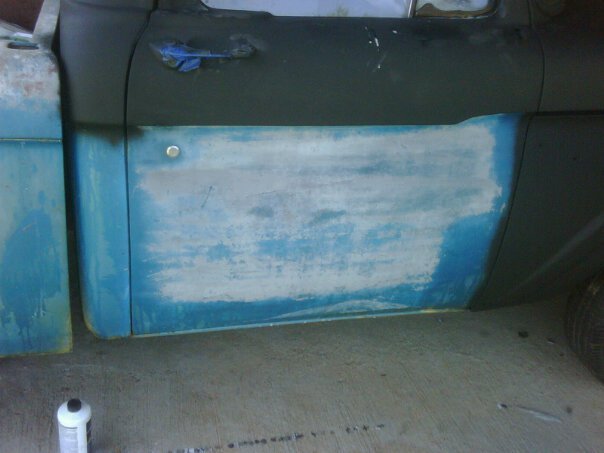

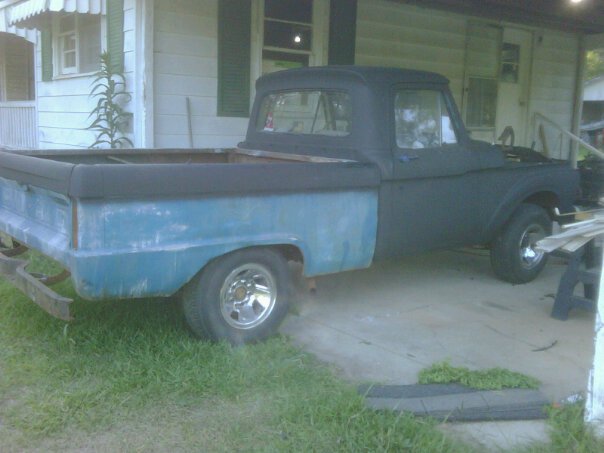

here are a few more shots....

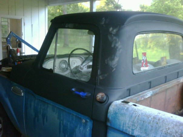

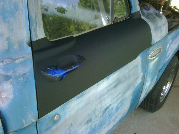

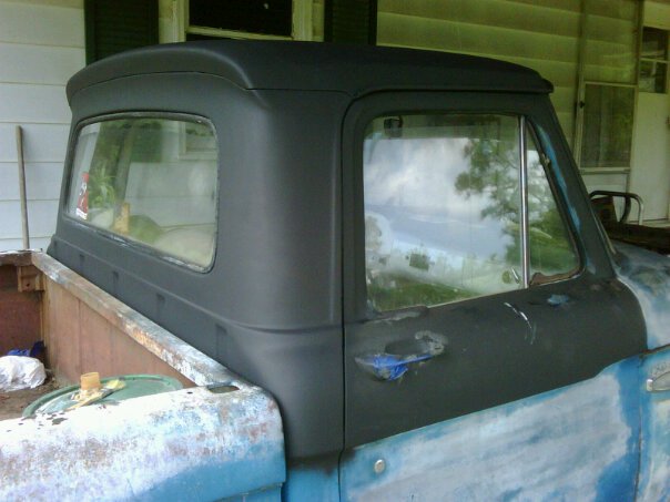

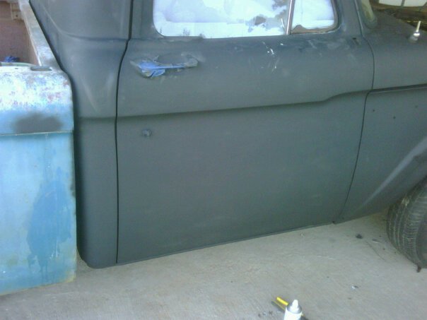

a few after some sanding and primeing...

more of same...

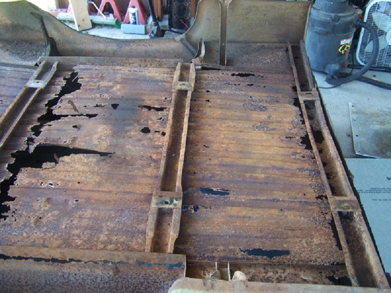

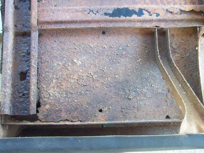

some pictures of what i consider to be the worst part of my project... the rusted bed...

Looks good! But don't you mean '65?

well, it may be, thats what i thought too, but a buddy of mine said its a 64? I was wanting a 65...

find a later model truck with bed damage and transfer the floor into yours. the vin should be in the glove box.

It's a '65. '64 had a straight axle. If you want it REAL low, sub frame it. If not, the DJM Dream Beams work great and drive good. Mid '70's trucks have disk brakes that are a direct bolt on.

I ordered new bed corners from a local metal shop today....I called and gave them the measurements, so all I need now is the center section of bed floor...

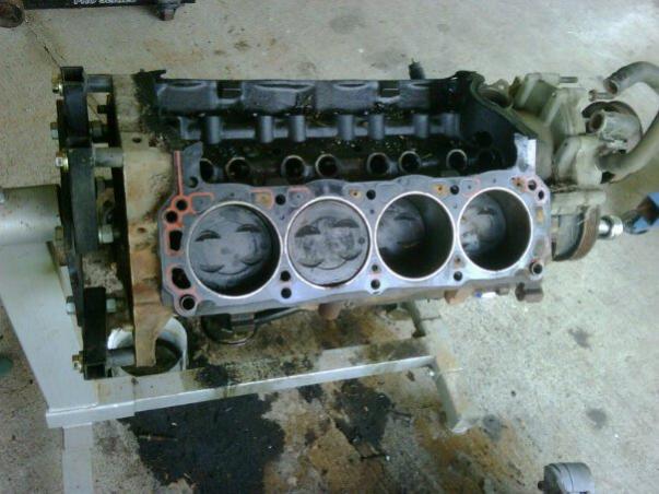

currently the engine will be a 302 cu i EFI engine from a 1990 mustang, and use an aftermarket roller cam with hopefully either a good set of GT 40 heads or aftermarket aluminum ones...maybe a performer set from edelbrock....

does anyone know the gauge steel used in the bed floor of the 65 truck? is it 16 or 18?

Looks like a good start..bummer on the bed floor,i have seen some worse than that.Check out my build thread maybe some good info for you..Good luck..

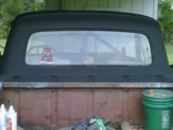

You may want to try to find a better bed if you are not satisfied with yours. These trucks are pretty common up here. Two years ago I saw three at one visit to the Birmingham Pull A Part.
Have you thought about finding a good flareside bed? The same flareside was used from 53 to 79. A good one of those may be easier to find. Then you would have the wood to repair.
