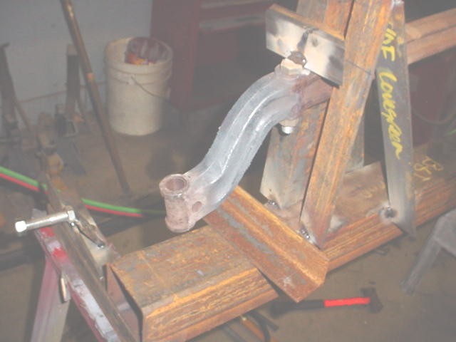

    Here are some pics of a jig me and a buddy made to drop axles. It works good. First heres a pic of the end where the spindle goes(an old spindle welded to rect. tubing perpandicular to anther longer piece of rec. tubing.

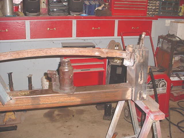

    then we made a index stop to how much we want to drop it, so when the axle is in the jig you measure up and set it at say 2 inches

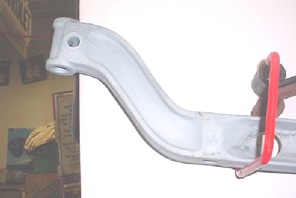

    then on the other end there is a guide to keep it going from side to side and we also made a stop for amount of drop ont the other end so the chamber is correct, and also on some axles we made a stop so the axle would stretch as it was being dropped(bolt into perch bolt hole)

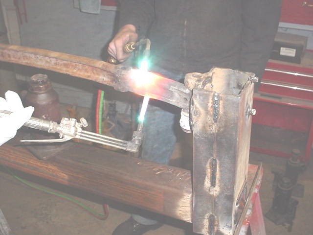

    once you get all the measurements done your ready to heat
  5. titus
    Joined: Dec 6, 2003
    Posts: 5,145
    titus
    then more heat ( try to stay about a 3/4 to 1/2 inch in from the perch and kingpin holes

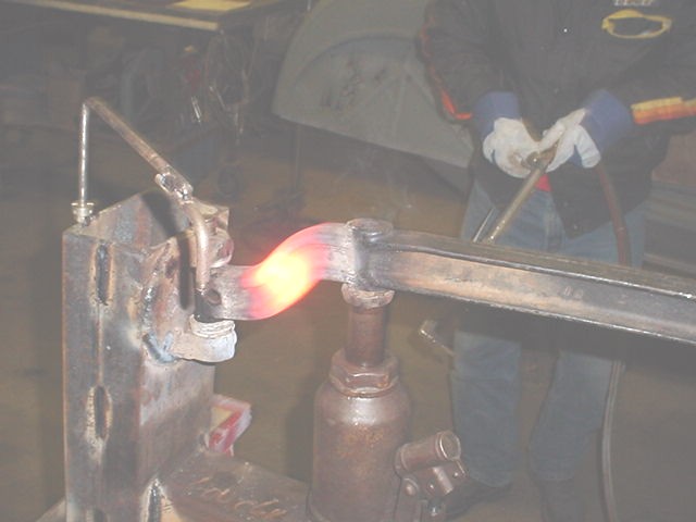

    then when its red hot you put a bottle jack underneith the perch bolt hole and start to jack (keeping heat on it moving around) just go slow, if it starts to thin in an area just concentrate the heat in a diff area, just keep going till you get to your amount of drop. then just repeat for the other side. the usauly turn out pretty uniform but are always going to slightly very

    heres the finished product

    well that seems alot less complicated that I thought it would be. How do you make sure both ends have the same amount of drop? I'm not getting the 3rd pic though, is that the same jig or a different one? what does what in that pic?

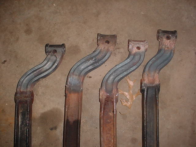

    heres some more left to right
    32-36 2-1/4 inch drop
    Model A 2-3/4 inch drop
    Model A 2 inch drop

    its the same jig just at the other end. So you make a stop at that end also. i know it was a bad pics but dont have camera right know. basically it has a loop that limits how much that end moves and the other end you contol with the jack they just have to both move the same

    we let the other end move with the axle till it also hits its stop. the stop on the end you are heating is stopped by the depth gauge and you stop pmping the jack. i guess i dont heat the axle so it drips on the floor! and i let it cool down by itself when it wants to, i dont want to quench it with water because it would make it weak without anealing it
