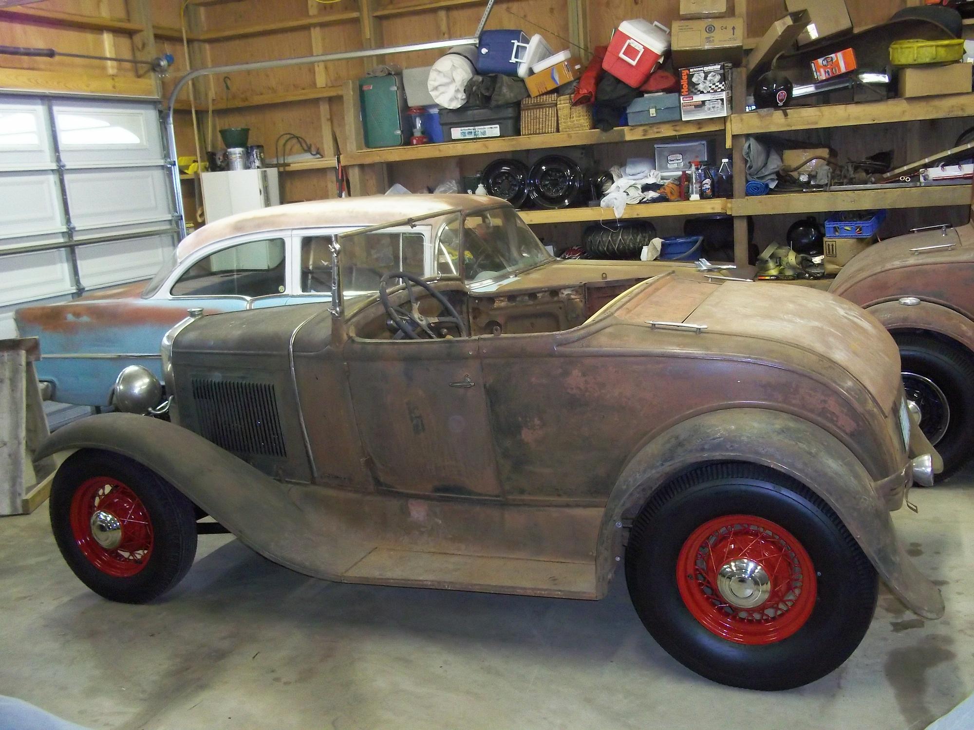

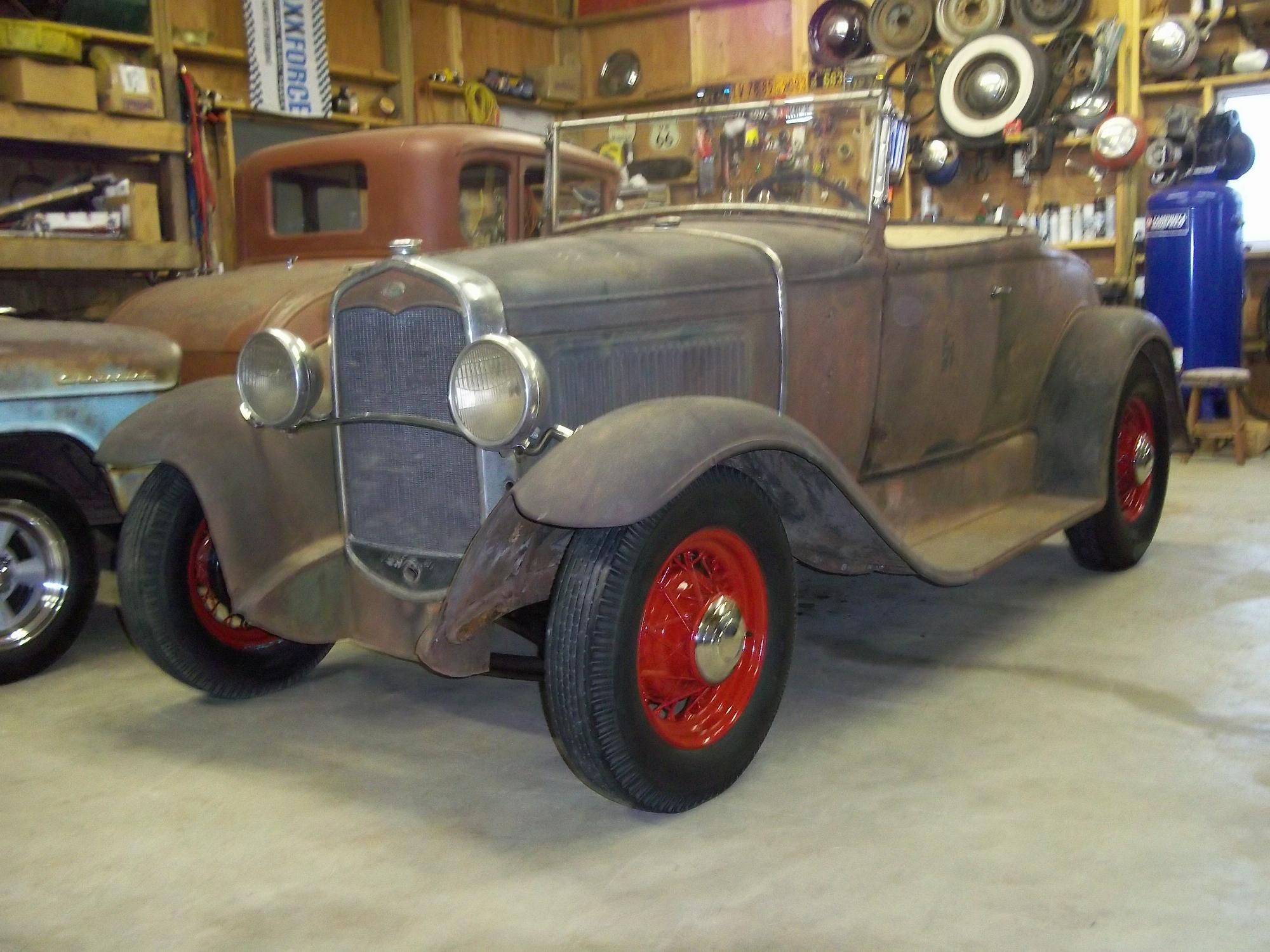

    I have been working on this barn find roadster for the last few months. I bought it in a barn in Kansas ( Great Bend area) back in January. The guy I bought it from said it ran, but I did not try to start it and took his word ( big mistake).
    I got it home and put a battery on it and cranked it, but not go. I had fuel and spark so I was only missing the main ingredient COMPRESSION!! Finally it started but it ran very poorly and would barely move itself up the slight incline into my shop.
    Well after a compression test of 25, 26, 7, 25 I decided a good used motor was in need. Luckly, a local guy here in Denver (Dave) had a good used 4 banger and I made the swap. Wow, what a difference in power between a engine with 70+ PSI of compression and 25 PSI.
    So with a good running engine it was time to set out to build a neat pre-war street roadster ( fenders). I wanted to buildsomething that a young man with basically only early Ford parts were available to Hop up his roadster.
    I know it is debatable that dropped axles were not readily available pre-war , but who is to say that Ed "Axle" Stewart did not experiment in '38 or '39 with his

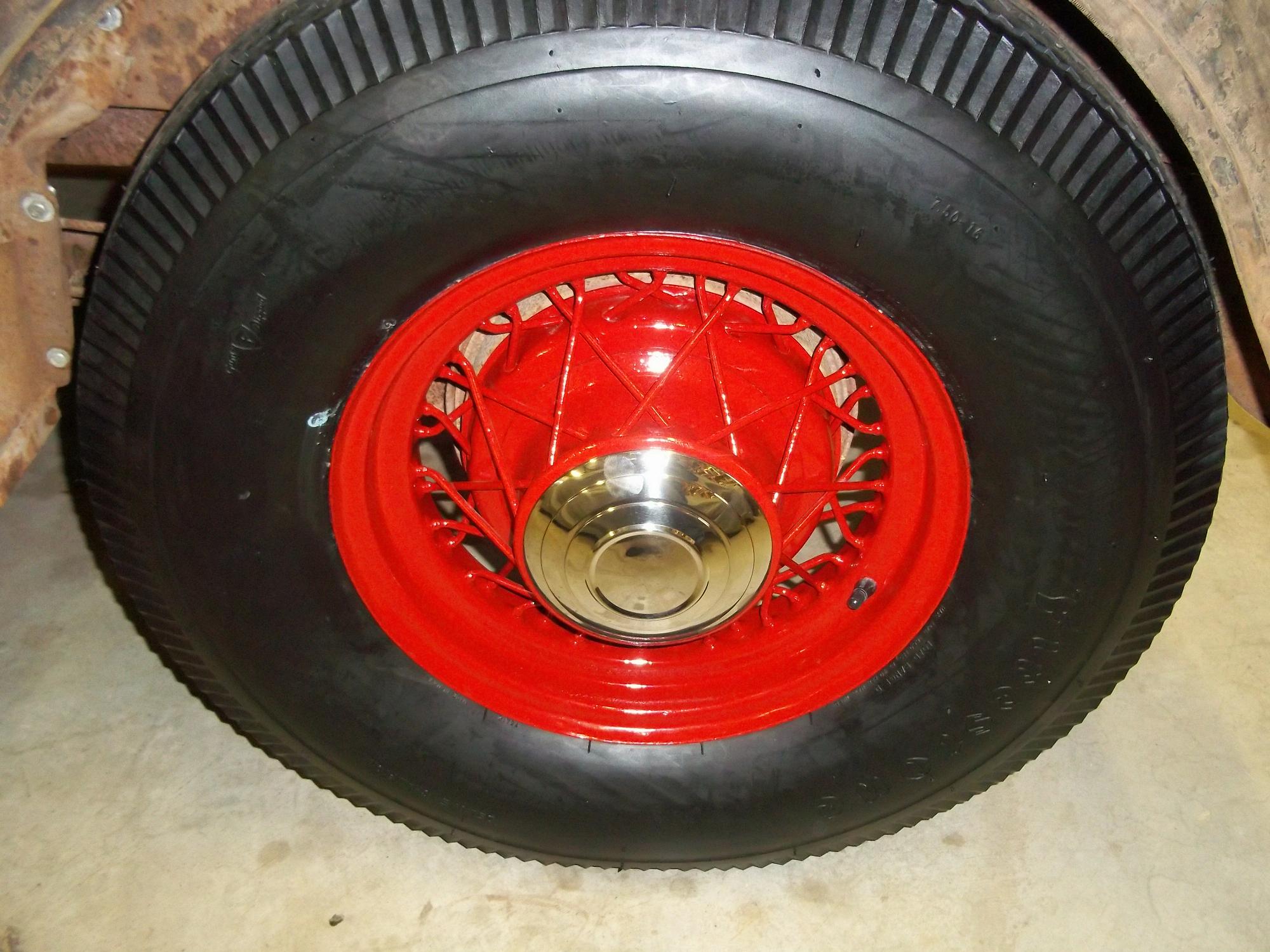

    -First I found a set of 16" Kellsey Hayes Wheel at Berts Model A
    -6.00 upfront and 7.50 on the rear is nice formual for rake.
    -Then Steve hooked me up with an original Deluxe roadster windshield
    -Dropped headlight bar
    -Bought a Model T rear spring to get a nice "3 drop in the rear
    -Used a set of '40 mechanical shocks on the rear, that once I welded the ball ends off the frozen originals and with the dog bones attached they fit perfectly in the original mounting holes like Henery intended ( but obviously he didn't)

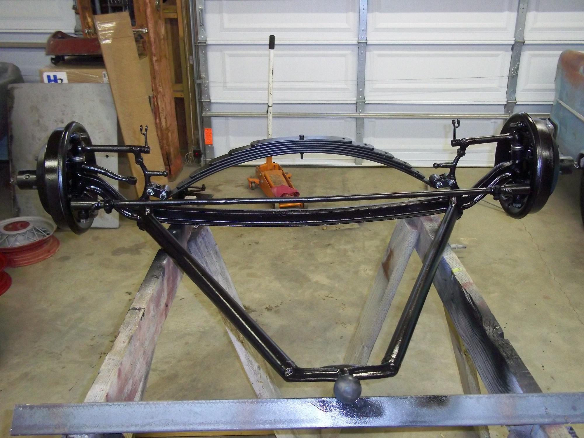

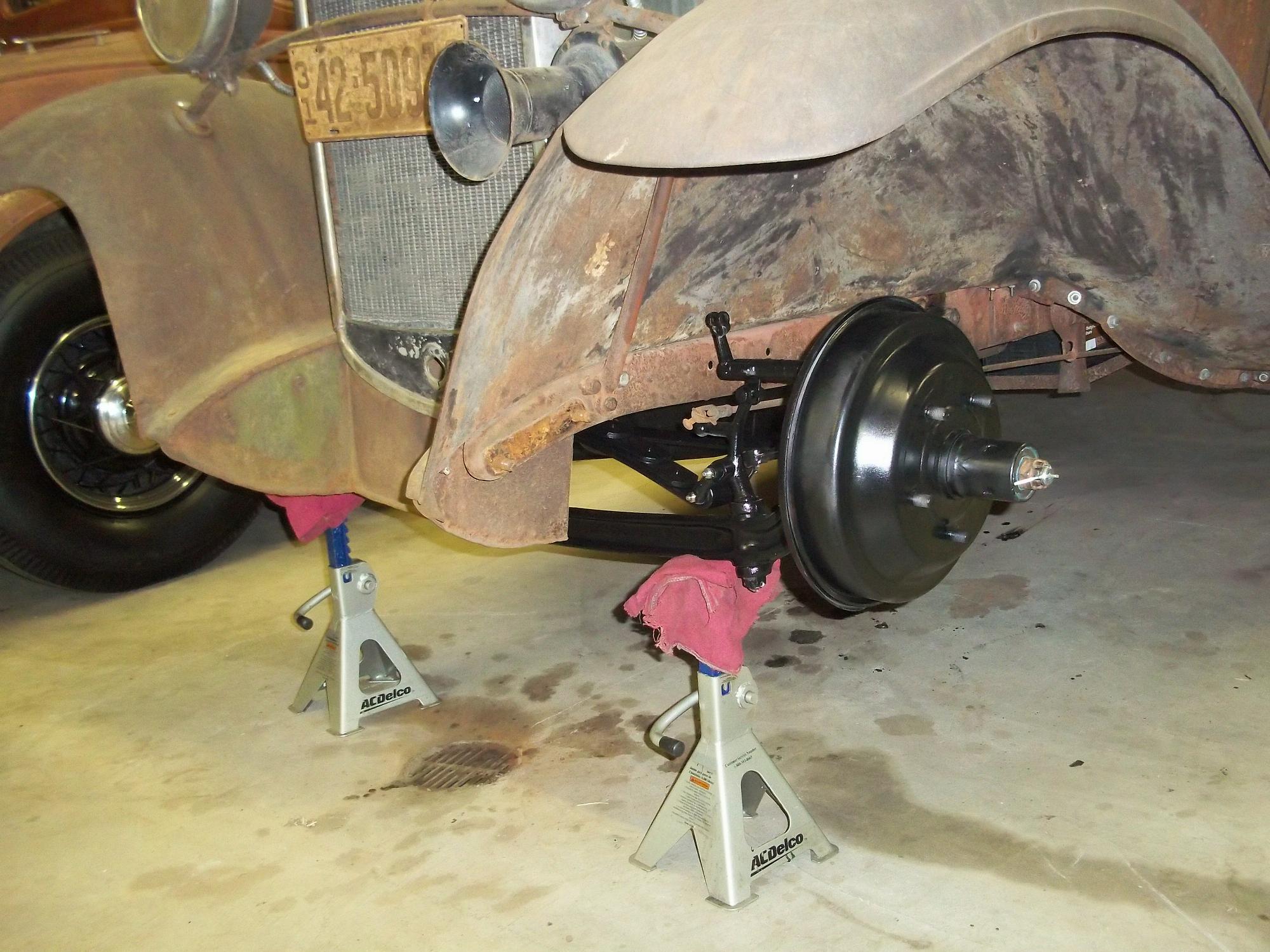

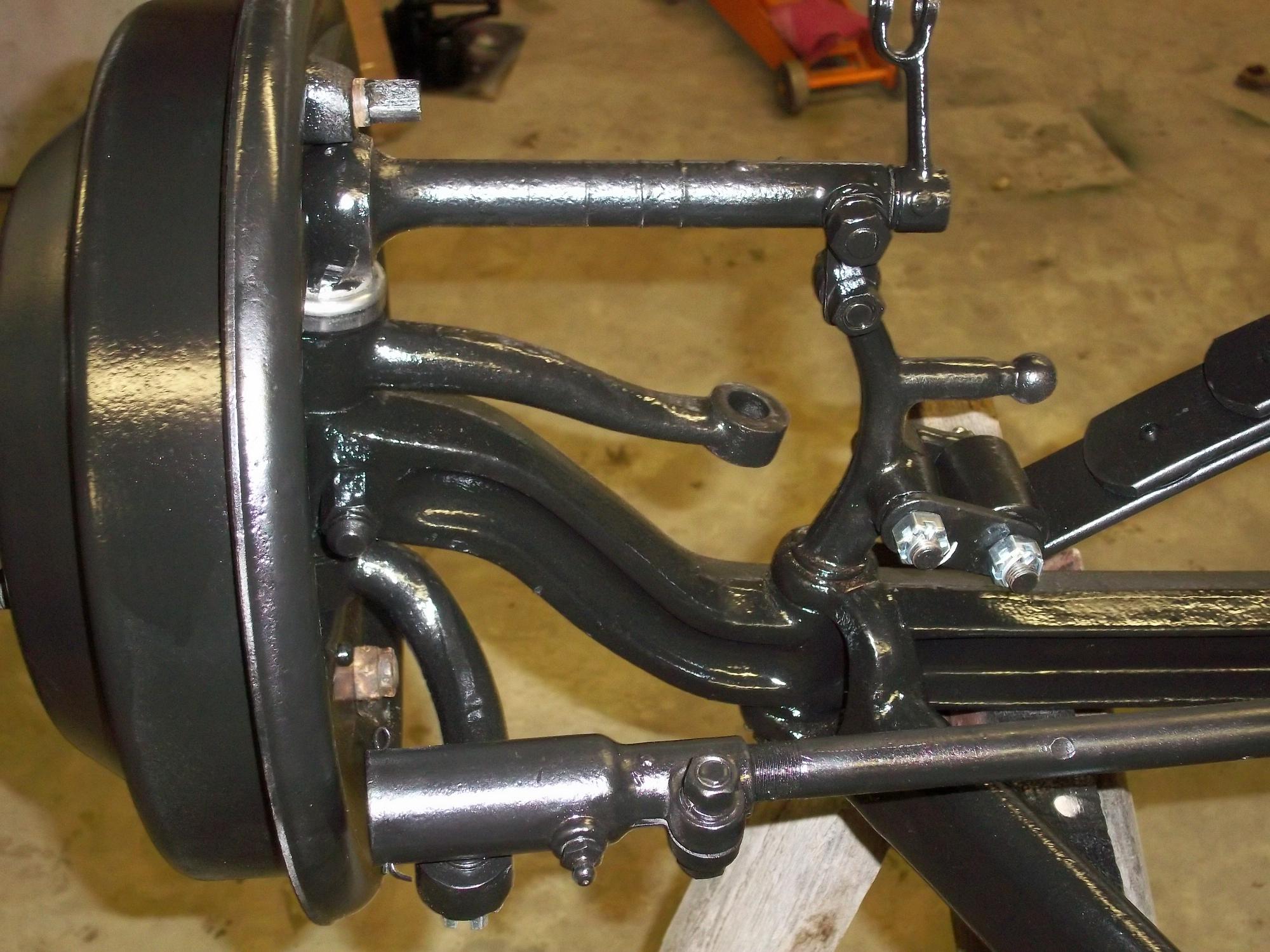

    Next, I turned my attention to the front suspension. After researching ELROD's post on how he did a dropped axle with mechanical brakes I though I would give it a try and amazing it was very simple.
    -"4 streched dropped Okie Joe model A axle so my axle width was close to stock.
    -Reverse eyed Mr. Roadster front spring with rear spring bushing cut to "1 3/4 so I could original spring shackles ( not P&J shackles in the late '30s)
    -'32 Spring perches with the same bushings as above.
    -'32 Spindles that I had rebushed and new Model A king pins.

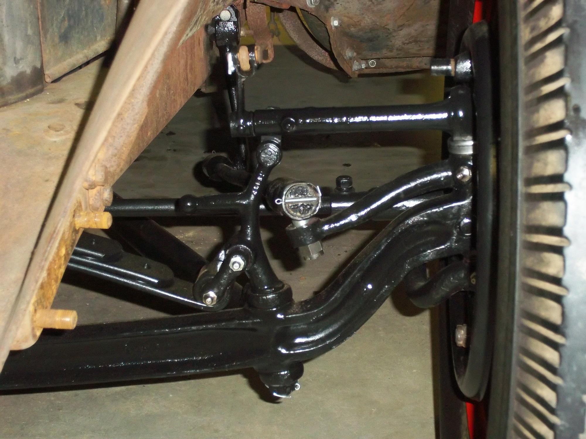

    -I made a 1" spacer to raise the mechanical brake levers up to match the backing plates.
    -Used a ball socket on the steering arm and a stock length steering arm fits perfectly with no mods needed.
    Well here is the finished product with a few pictures of the build.
    I can't wait for the rain to stop to go for a drive!!
    Enjoy!

    Hey Tex. I was looking at your pictures again. Just a comment on that riser you made on the spring perch to brake actuator.
    Make sure that it can't rotate inward toward the engine and pull your brake actuating arm out of the ball cup on your kingpin. I gusseted mine to prevent the brakes from coming apart and loosing my front brakes.
  25. So-cal Tex
    Joined: Aug 24, 2005
    Posts: 1,384
    So-cal Tex
    Thanks Elrod, I thought about that and I made it out of 1/4 inch flat stock, so it is pretty beefy.
    The other issue is if it gets loose then it will pull the spring actuating arm out of the backing plate. I made sure they are very tight and I will check them periodically.
